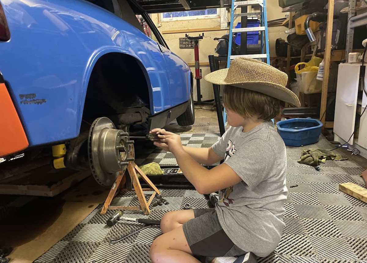

So, when we last left off I had got the LR wheel bearing replaced and everything buttoned up. Since I had so much fun replacing the bearing, I figured I'd continue the fun and tackle the wheel bearing on the RR corner. But I decided to postpone it for a couple of days.
When I finally stopped procrastinating I convinced my apprentice to endure a few minutes in the garage and just maybe learn a little something about mechanics. Also busted knuckles and perhaps broken automotive dreams. If you're wondering what the deal is with the straw hat, don't ask me. It somehow arrived on a shelf in the garage years ago only to be found by my son. Some people have thinking caps...I suppose this is his garage hat.
As we dug in further it became apparent that this bearing hadn't been touched in a while and clearly needed replacing.
I managed to keep my apprentice interest long enough to help remove the bearing retaining plate, then he darted back inside to the comfort of the air conditioning.

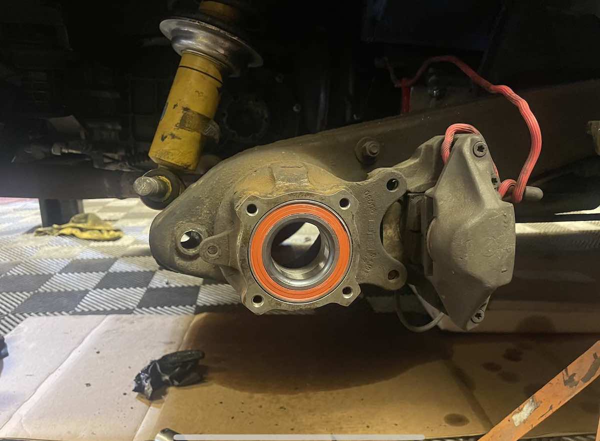

Check out that filth and grime...
Not sure how long this bearing has been in there, but it wouldn't surprise me if it dated back to 1970.
After spending a couple of nights nestled between some frozen chicken breasts and what was left of the ice cream sandwiches, I rescued the new bearing from the freezer and popped it into the cleaned-up bearing housing.
You'll have to use your imagination to visualize how everything else went back together. Rest assured it all went back together with relative ease.
I had to wait until the next day to give the new bearings a maiden voyage. My neighbor pals love to comedically post on Nextdoor about my loud car if I leave after dark, and I didn't want to dare let their potential posts interfere with the latest "is it a coyote, fox or wolf" post from the unofficial Nextdoor neighborhood watch committee.
