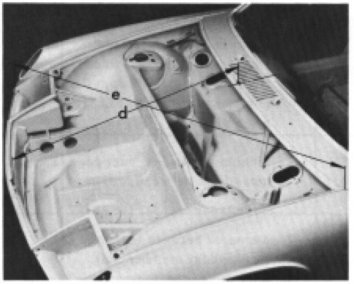

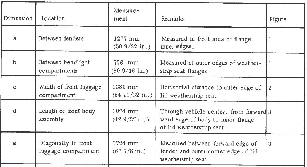

I believe the under body dimensions would be more critical (suspension mounting points), but not sure how to measure those on an assembled chassis. Here are the only dimensions I see in the manual related to the area in question, that would be simple to try and measure/compare against factory dimensions.
Hope that helps...
If you need an impartial person to measure/look at it in person, I'd probably have time this weekend if the car is available - just PM me.
