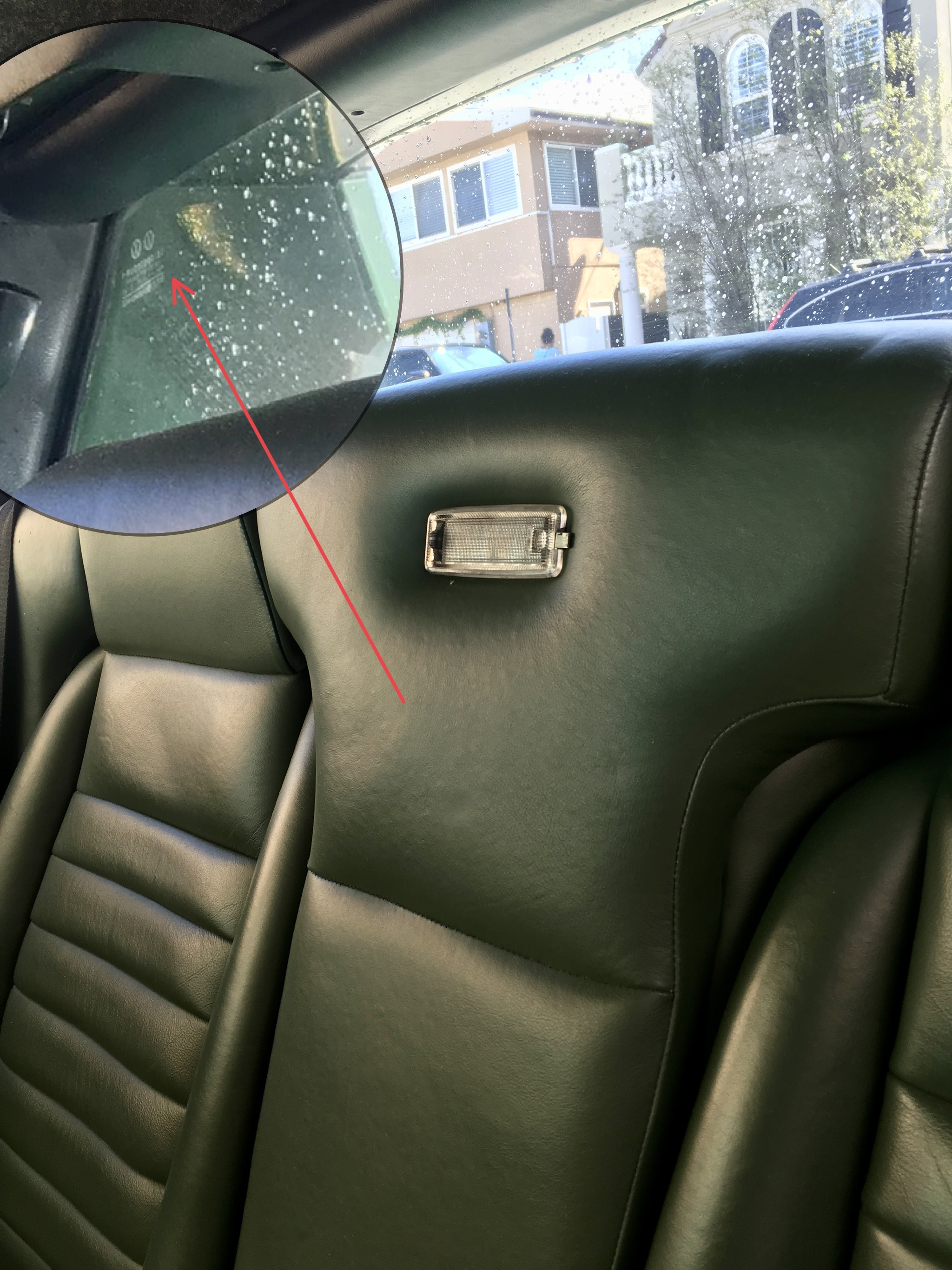

Last week I was at a dealer looking at a Mercedes GLB since I need a new SUV. Popped the hood to look at the engine. The sales guy pointed out the divots in the underhood bracing without my asking (I was interested in the engine - didn't even notice the hood). He said they are designed to reduce head impact forces in a collision with a pedestrian. That is a bit more believable than the reflecting sound theory... but I don't know the real answer either.

This got me curious... Head impact protection on the hood is what it is.
Found a 2008 GM research paper at the NHTSA...
ABSTRACT
Besides functioning as an engine compartment cover, the hood of modern vehicles can also help manage the impact energy of a pedestrian’s head in a vehicle-pedestrian impact. However, a hood’s ability to absorb impact energy may be impeded by the proximity of the hood to components packaged inside the engine compartment, i.e., by its underhood clearance. For example, for a given hood design, the hood’s ability to absorb impact energy through deformation can be significantly reduced when the hood and engine block are in close proximity. Therefore, a large underhood clearance would be preferred for pedestrian protection. However, it could negatively affect driver visibility, as well as a vehicle’s aerodynamics and aesthetic appeal. This paper presents a sandwich hood design that has a potential to improve the hood’s ability to absorb the impact energy of a pedestrian’s head with a relatively small underhood clearance.
Final conclusion was a corrugated under hood works, but is 27% heavier than the standard hood and was not evaluated for manufacturability. Guess they figured it out and put it into production. But like Superhawk said, designed for regulations to the detriment of the vehicle and does nothing for the driver or driving experience.
Found references to a Mercedes patent for putting in pedestrian hood airbags. Today our 914s would weigh 3000+lbs with this thinking. Isn't that what the 718 weighs?

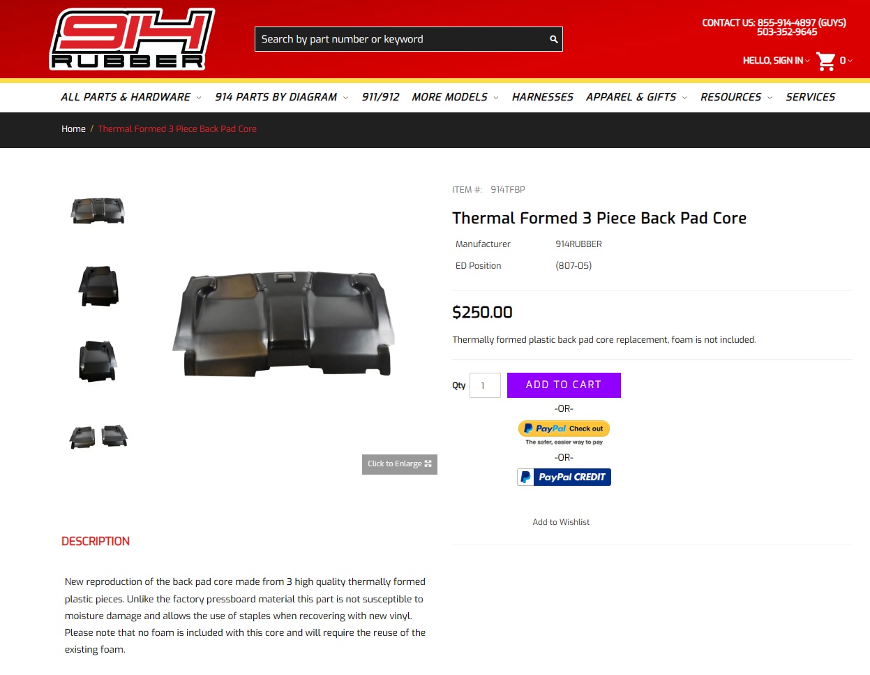

The heavy "tar" mat that is factory works pretty well. If you need to have perlon for an aesthetic you are looking to achieve you could take a back pad and cover it with perlon. Either a stripped-down stock one or one of these-
https://914rubber.com/thermal-formed-3-piece-back-pad-core-1
Matt used this on his carAttached Image
@Mikey914
Mark, do you all offer the 3 piece backpad with Perlon already installed like Matt’s car?
(Edit- Mark I see from another thread that you all are currently short staffed. No big deal on my question here.)
Thanks!

Good morning Rich, I did a dual glaze rear window on my 914 almost 30 years ago. Look at the picture below, the identification on the glass is mirrored or doubled.
In fact, right after I put in the 3.2 L motor I ran without a back window for almost a year. Rain does not get into the car when you’re going forward. Lol
Creative - I didn’t realize you can fit two layers of glass in there. How did you secure the second pane of glass?
