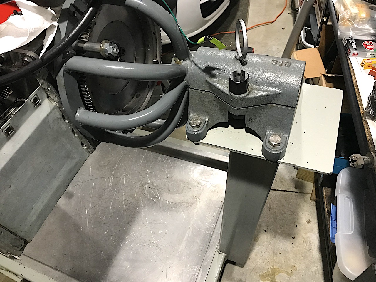

Buy the good one, your going to be hanging a 25M engine on it. Or borrow one from some one in the club by you. I have mine lent out to Kelly-moss where I work part time. At the end you can sell it for what you Paid. Best, MarkAttached Image

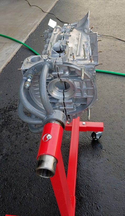

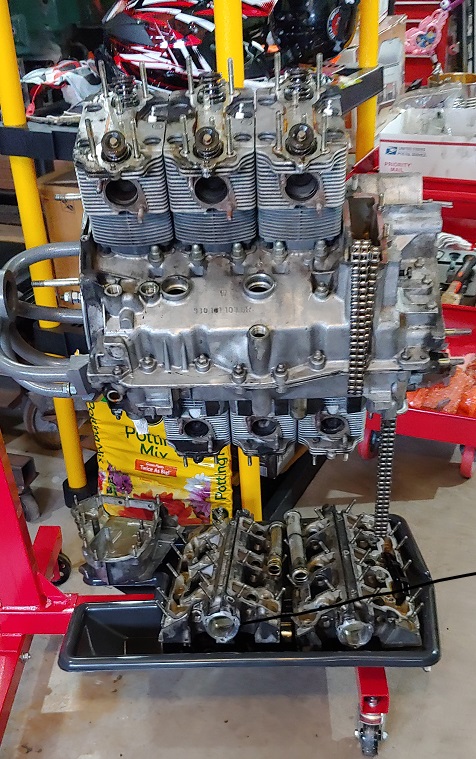

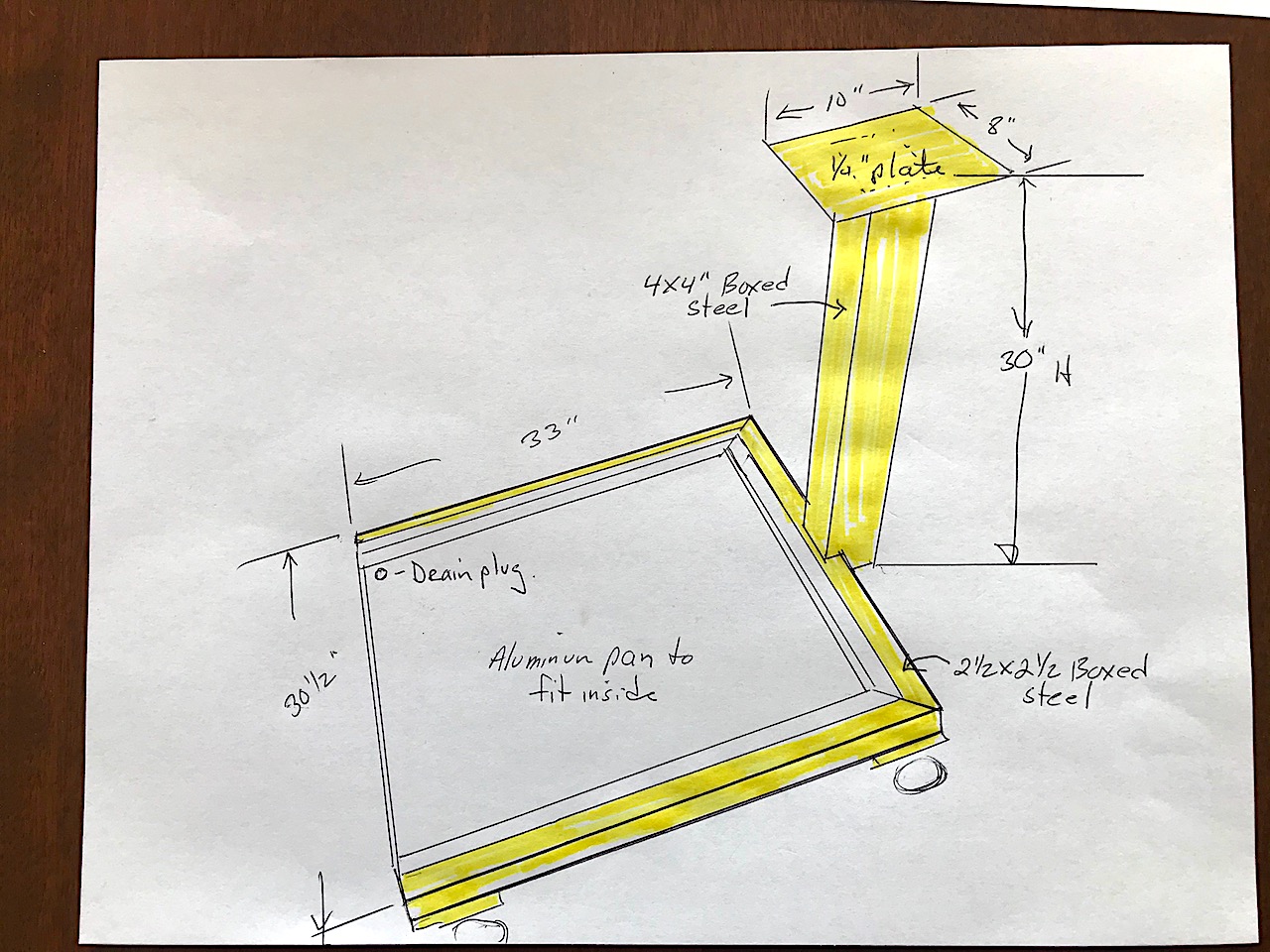

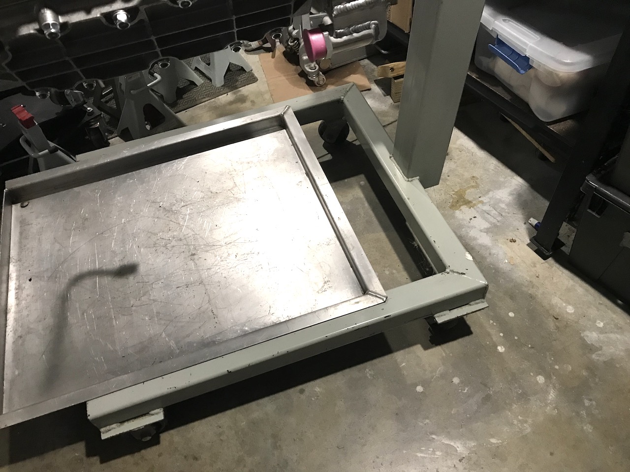

Mine is heavy, I asked Jerry Woods 20 years ago at his engine building class if I could copy his engine stand. He told me to go ahead. So I'll share this again if anyone wants to have a good one welded up. I had three made back then. This will easily hold a 930 turbo engine. Mark E. share this with your fab guy he might want to use a few ideas. Best, MarkAttached Image Attached ImageAttached Image

QUOTE(mlindner @ Oct 11 2023, 11:44 AM) *
Wow that is awesome.

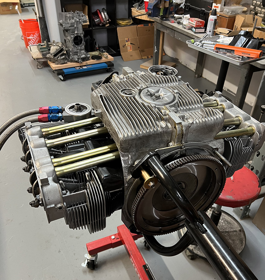

This is a RAT 2270 fresh Eng. Mark and I are working on, the Cradle is a EMPI type and the Stand Is a Harbor Freight brand. Seems plenty strong for a 4. If you are just doing 4s it will save you lots of money. I have not heard of a failure from these.
Best Bob B

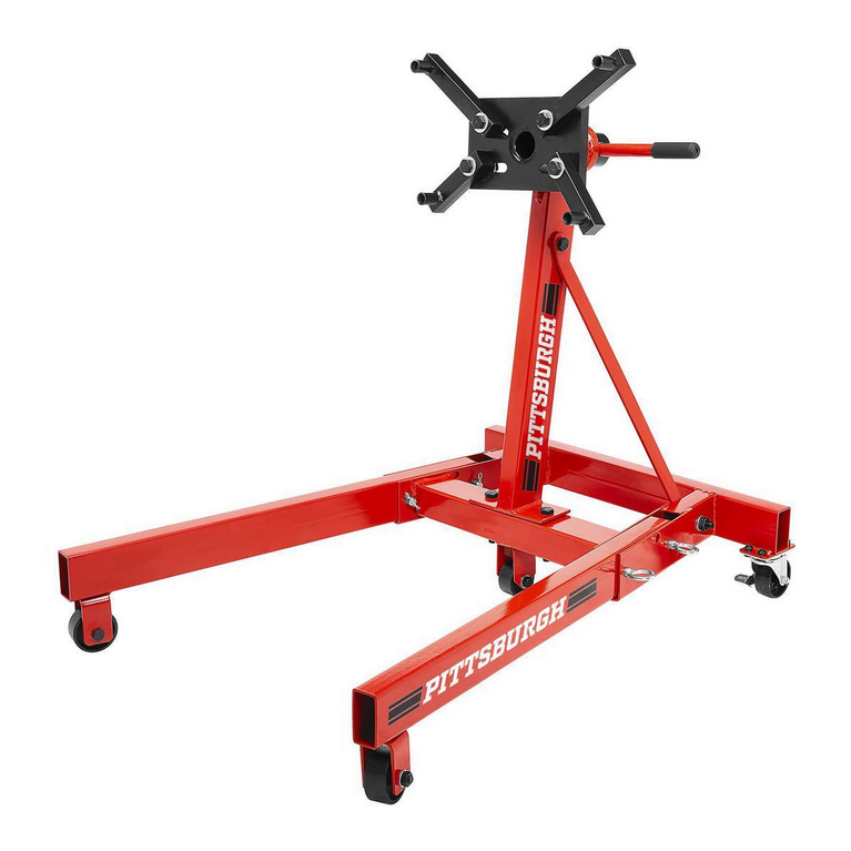

There's this style too. Seams sturdy. Maybe use bolts vs the pins on the folding section.

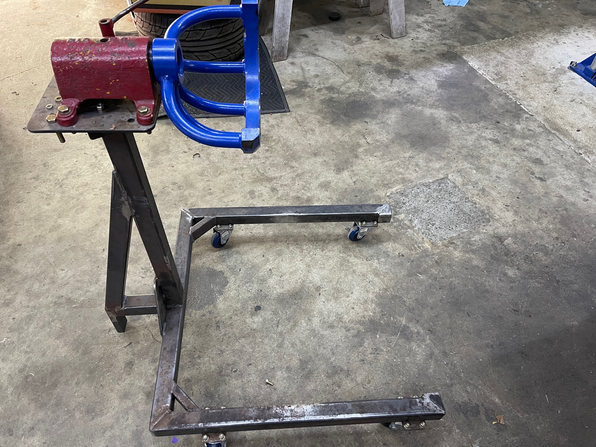

914-6 GT in waiting
Posts: 20,604
Joined: 19-September 09
Member No.: 10,825
QUOTE(Luke M @ Oct 11 2023, 05:05 PM) *
QUOTE(mepstein @ Oct 11 2023, 12:32 PM) *
QUOTE(Luke M @ Oct 11 2023, 03:24 PM) *
Get a $100.00 HF 1000 lbs engine stand (or the HD stand for $200) and a P201 Porsche engine fixture. I have this setup and no issues at all holding the weight of a 6 engine. Going on 3 six rebuilds with my setup. Again no issues and all for under $400. I purchased a once used P201 fixture on PP.
Luke - it will work, and obviously you did, but it’s so much nicer to work on a stand that’s really stable and solid. Having room under the stand for a 1k hf lift table is priceless.
We have one (like the red one) in the back that never gets used. Weld up one like mlinder or mine. You won’t regret it.
