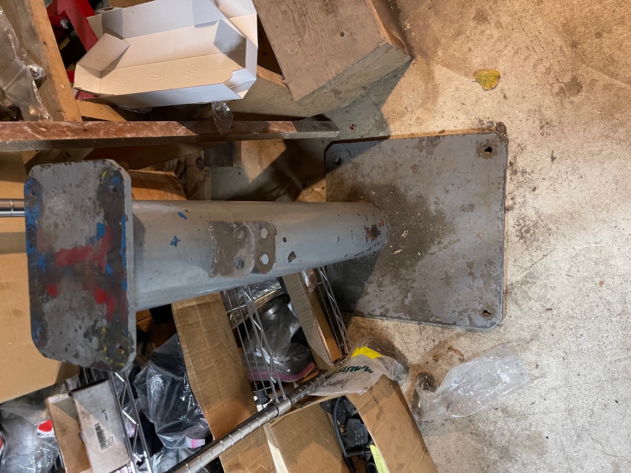

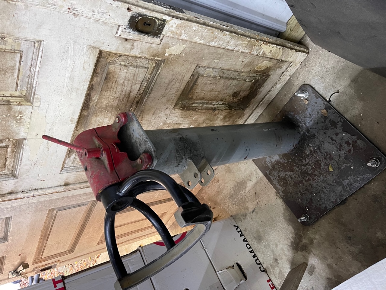

Also have a couple stationary stands. Not as practical as the mobile ones but can be useful

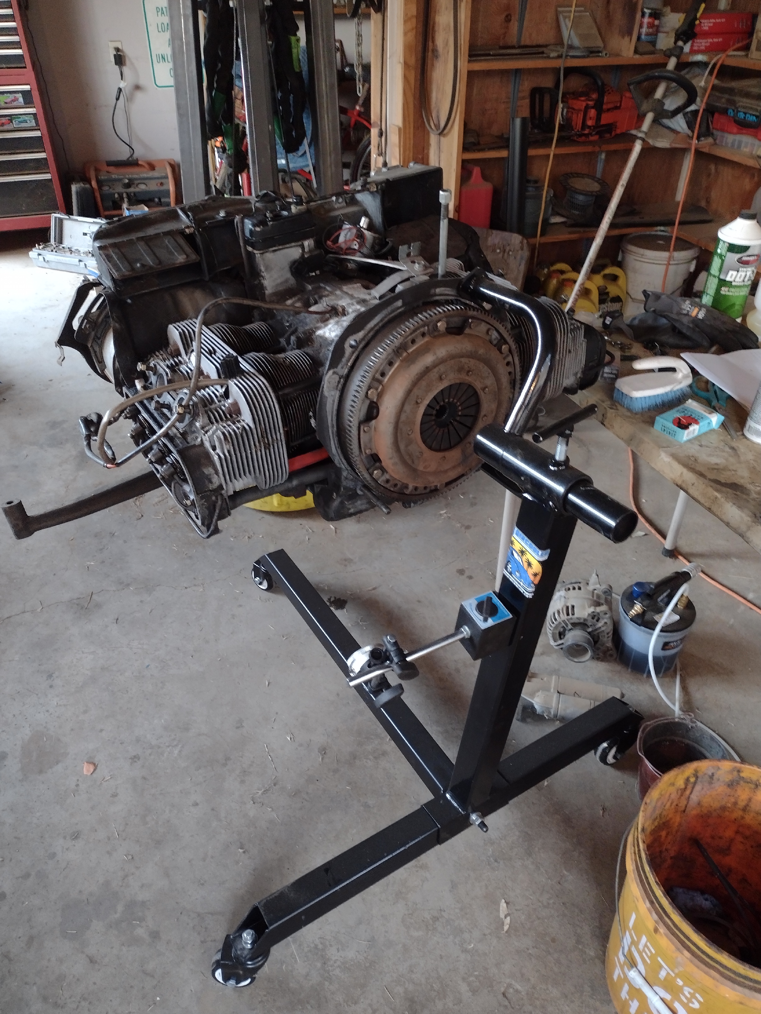

I use a HF motorcycle lift, with a simple plywood cradle for the engine and trans.

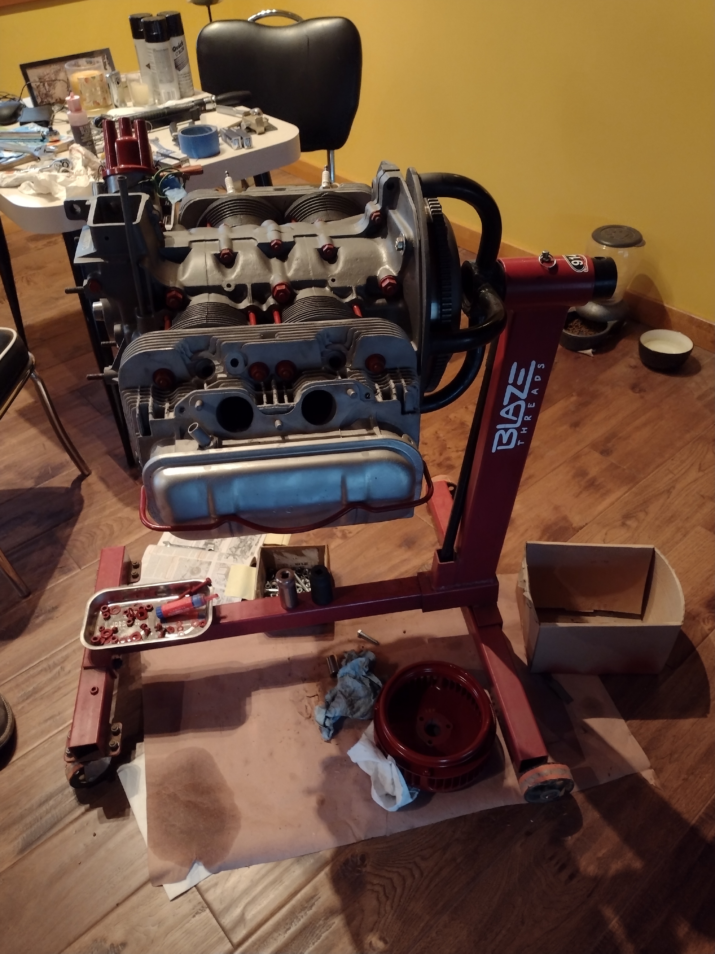

If you are on a budget...
https://www.ssaircooled.com/empi-vw-engine-...escription=true I'm using this stand for an engine I'm tearing down (just be careful) I'm using a Harbor Freight 4 wheel with a separately purchased 3 arm yoke for the engine I'm building up, very sturdy. |
