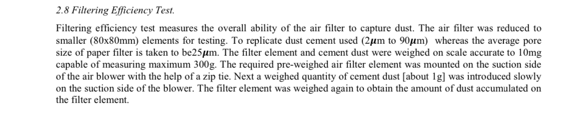

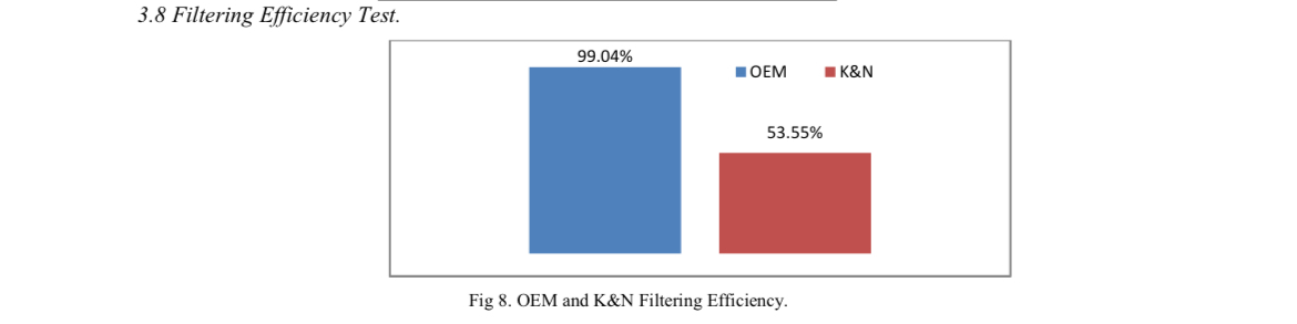

Here is a academic study:
https://doi.org/10.1016/j.protcy.2016.05.063

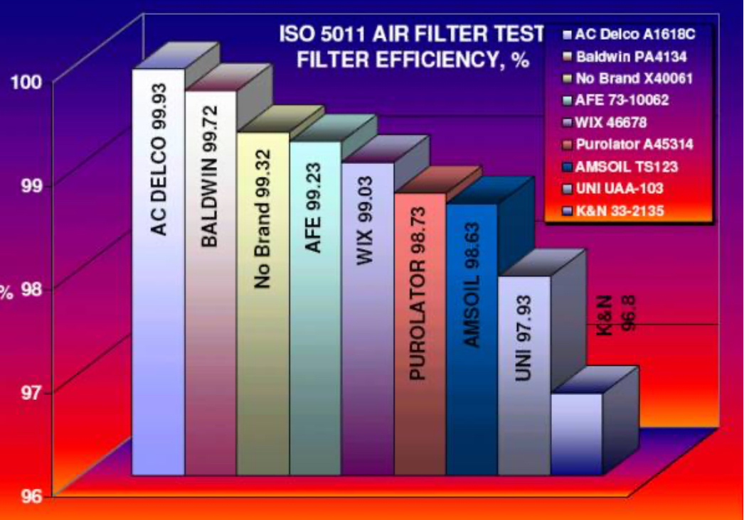

Another good link to a more definitive ISO test than the basic academic study.
https://www.nicoclub.com/archives/kn-vs-oem-filter.html/amp

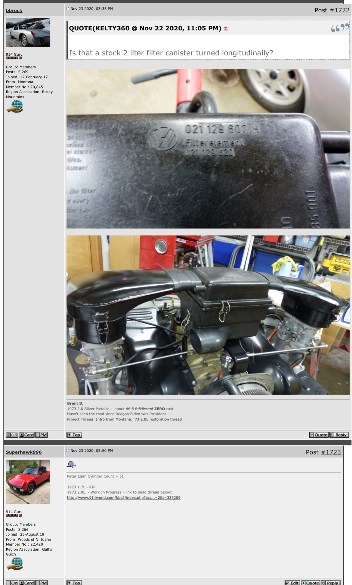

I’m still reeling from the death of Brent Brock. His contributions to this forum should not be underestimated with how well he documented so many details of his restoration.
Wanted to take a moment to remind others of the amazing work he did recreating the European style air filter that worked with a standard paper element. This was all hand built (except the center air box - VW part)
The details are in his thread.
http://www.914world.com/bbs2/index.php?sho...290&st=1720
There are commercial versions of this available (CSP I think?) but they are crazy pricey $900 or more. But if you have a high dollar engine - it is the way to get OEM type filtration and protection for that engine.

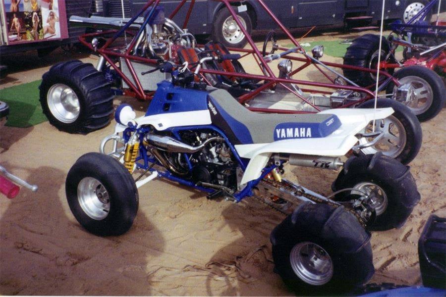

This was my drag bike. Klemm research did the head reshape and the porting and I did the rest. I had to make custom intake manifolds to fit two 38mm Keihin's. after shoving those in there, I had room for a couple K&N's. End of that season I disassembled and found two wiesco's totally ruined. I diesel bathed everything, honed the cylinders to seat the new rings, reassembeled with new pistons, the K&N's and Outerwears End of that season it was time for more rings, But that was it. I loved the performance of the K&N's, but don't forget your outerwears. (IMG:style_emoticons/default/smile.gif)
