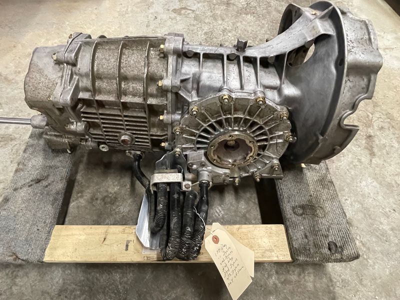

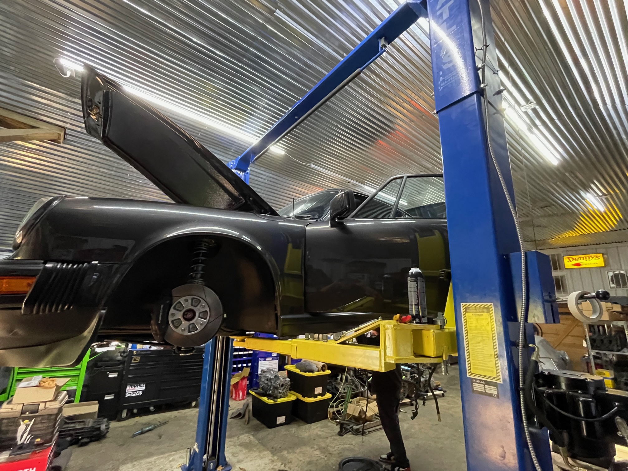

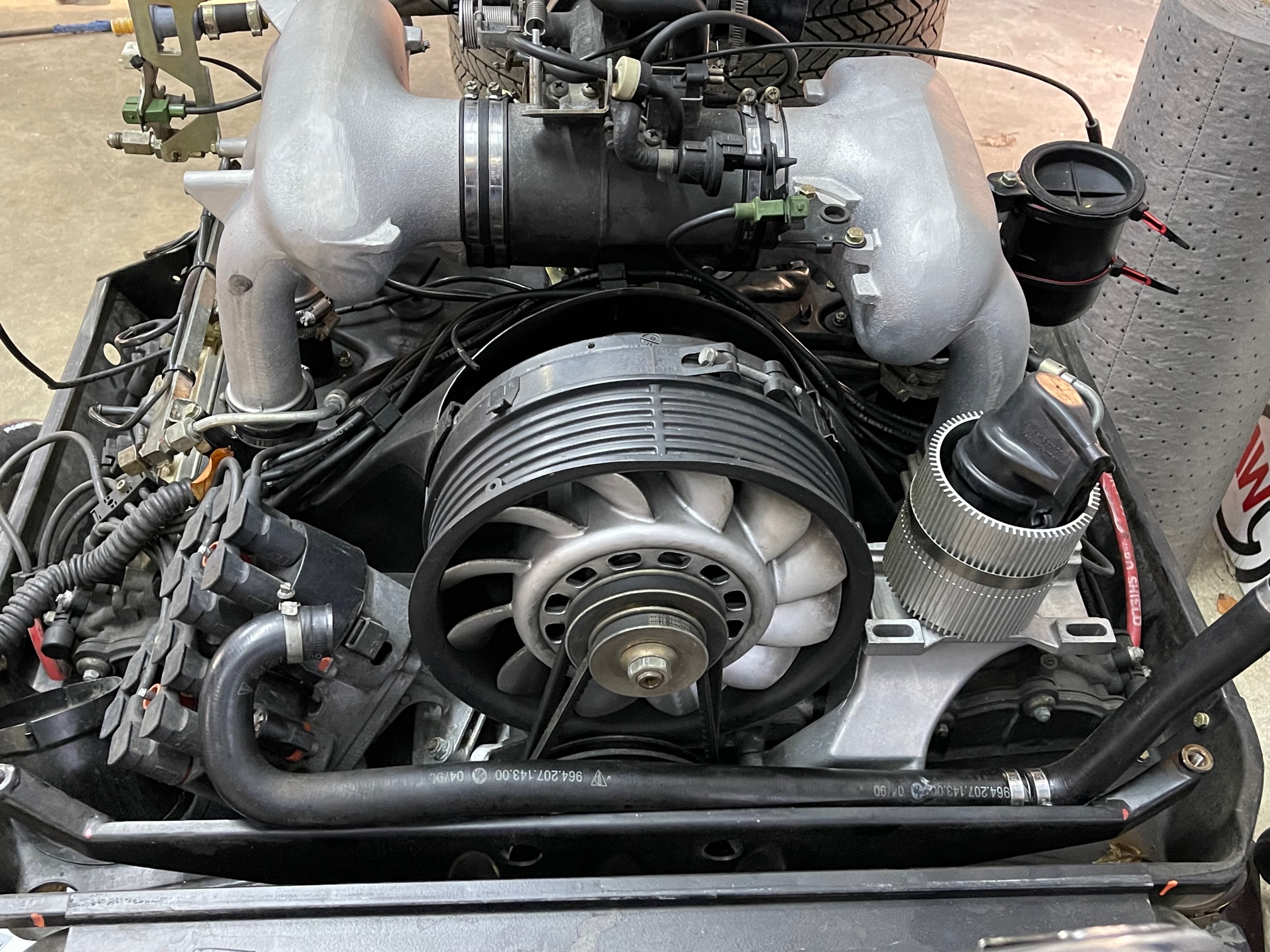

We put aluminum 915 boxes behind built 3.6/3.8 engines all the time. Is it as strong as a G50, no. Will it work great, yes.
Here’s a Peter Dawe (look him up) built 3.8 with a good 350hp in a 81 SC. Customer has been driving it for 3 years and is in the shop for MCS coil over shocks and big brakes. The engine pulls like a freight train. I have a good 100 miles in it, test driving to make sure it’s all sorted.
I do have a Peter Dawe built Carrera trans with a factory cooler, if you are looking for a trans for your 917. Also an SC trans with lsd. I can also build with custom gears if you are looking for something special.
*Dawes Motorsports doesn’t have a vapor blast machine so the case isn’t “pretty”.

PS - I also have a rebuilt 930 turbo trans. It's definitely up to the task and can be inverted. We ship all over the world.
