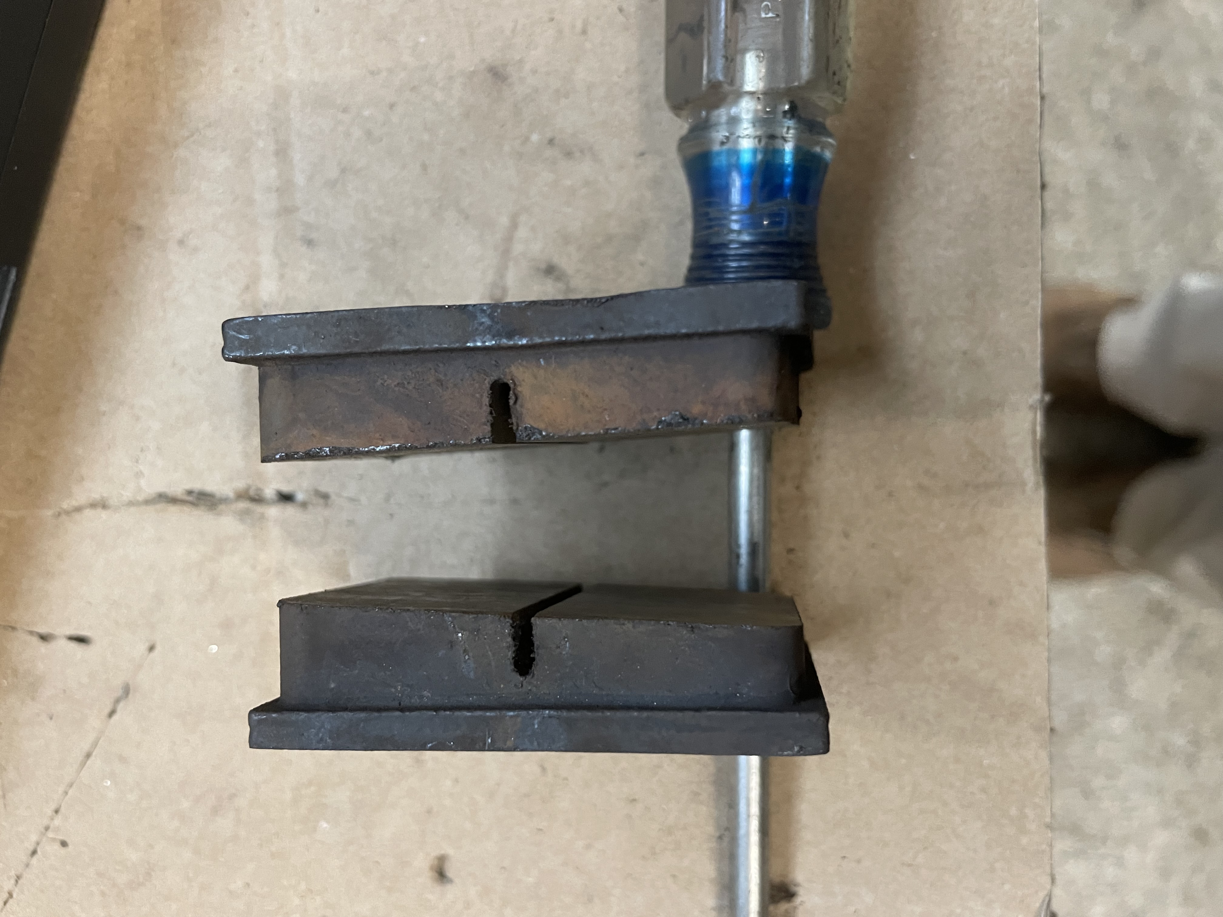

Then I take the pads out to measure both the rotors and pads to spec. All looks good except for the front left pads. Uneven/slanted wear! (See pics). If I hold the friction surfaces parallel it would mean pistons are cocked. Doesn’t make sense. Or the rotor surface is not parallel.
So what causes this situation?
