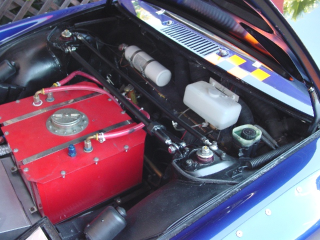

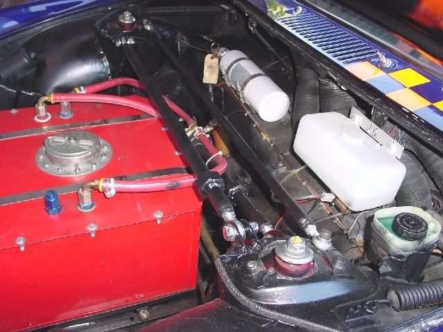

Last night I did a quick check of the front end since I had done the DE at the "Q" in San Diego as a test to see how the new struts, Koni inserts and Tarett mono ball strut mounts worked after a good alignment. The car handled fantastic and corners like it is on rails, actually 23x9x15 Goodyear slicks! Anyways, the right side was still at ZERO degrees as it should be with cantilever slicks, BUT the left side has PLUS .8 degree camber. It had moved after we spent hours aligning the front end and all. I do not think the strut got bent as I welded reenforcements at the spindle area so it would not move and the sheet metal has nice new super heavy duty braces, etc. The shop sjhowed me another 914 race car and said it had suffered the same problems and the fix was several hard welded tubes and diagonals to brace the upper strut mount sheetmetal and replace the area with a camber box!?
Has anyone else experienced this problem or had to add additional tubes if you are running slicks to stiffen the front sheetmetal in the mount area? I'll post a couple of picts of what I have so far and any ideas are appreciated.

Here's a pict

Here's another

Last one

As Jeroen noted, I don't have any trouble with the rear as I have both vertical and horizontal links on the outer mount and horizontal links on the inner mount so things are pretty solid nback there. The tube is seamless cro-mo and if the pictures show it there is the diagonal brace from the top left to the lower chassis.

John, looking at your pics, it's pretty weird that you have a camber change (at least on only one side as you discribed)
one of your braces mount directly to the shock mounts, so unless that brace has stretched it would be pretty much impossible to have a camber change caused by the the strut mounts
or you'd at least have the same amount of movement at both tops - one going more neg, the other going more pos.

In this pic...
(IMG:http://www.914world.com/bbs2/uploads/post-2-1124499084.jpg)
the brace between the strutmounts looks bent (near the middle of the fire bottle) which would make it possible to stretch in/out
or is it just a weird deflection in the pic?

The one you are asking about is in fact bent since it used to go around the back of the fuel cell before I lowered it and I was going to leave it off but it ties the strut bolts together. It is thick wall cro-mo tubing and I guess it may flex a little but the larger two tube braces "should" take most all load? I plan to put the car in the garage tomorrow on the very flat floor to do some measuring after I get some 200# of weight for the driver's seat. I borrowed a set of scales too so I can play with the balancing some too. I'll post results of what I find. Thanks for the input.

You think maybe your front strut braces are working so well it is pusing your strut mounts outward?

If I'm not mistaken that area on a 911 is well known to be weak. People actually use their adjustable camber braces to pull their struts together at the top for more negative camber.
In stock form the 914 doesn't have the same weakness. I just don't understand why the panel and its upper reinforcement would be compromised for a fuel cell installation. The three tubes you have can't equal the strength of the original material that was removed.
As for the suggestion to install camber boxes, they are only useful for installing coil overs IMO. You could recover the strength of that area with strategically welded tubes of roll cage diameter (and reinforcing plates) to replace the detachable braces.

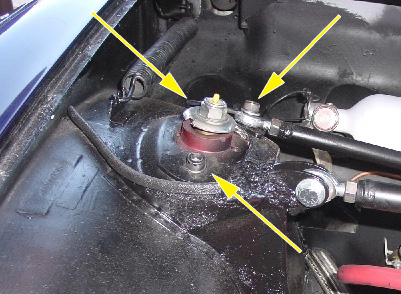

Member No.: 2,648
It could also be that the bolts and plates (arrow'd in the pic) are moving around? Use some white-out and outline them. After a heavy day at the track, take a look at them again. After I had a front alignment done and suspension work, I noticed after an autocross day they've moved out of my sharpie outlines.

QUOTE (Brando @ Aug 20 2005, 10:03 AM)
(IMG:http://www.914world.com/bbs2/html/emoticons/agree.gif)
I think that the strut brace, since it is mounted to the tub on one side and the strut mount on the other, the cornering forces are pushing your strut mount. The stock bulkhead braces just the tub.
