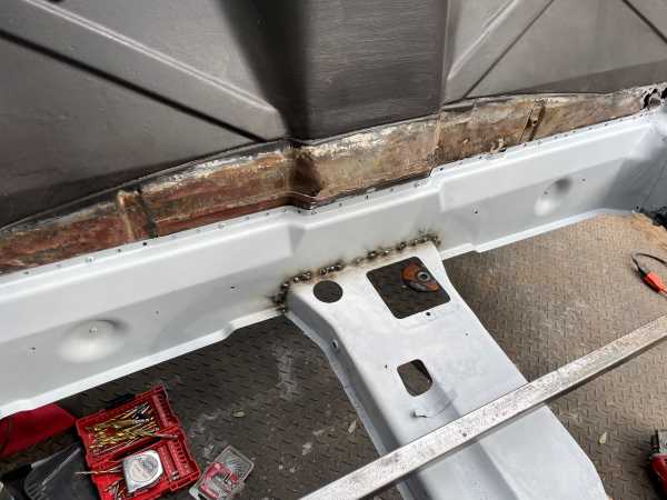

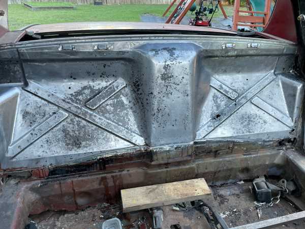

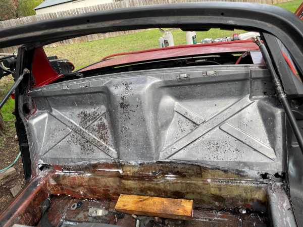

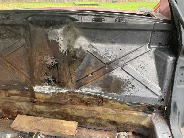

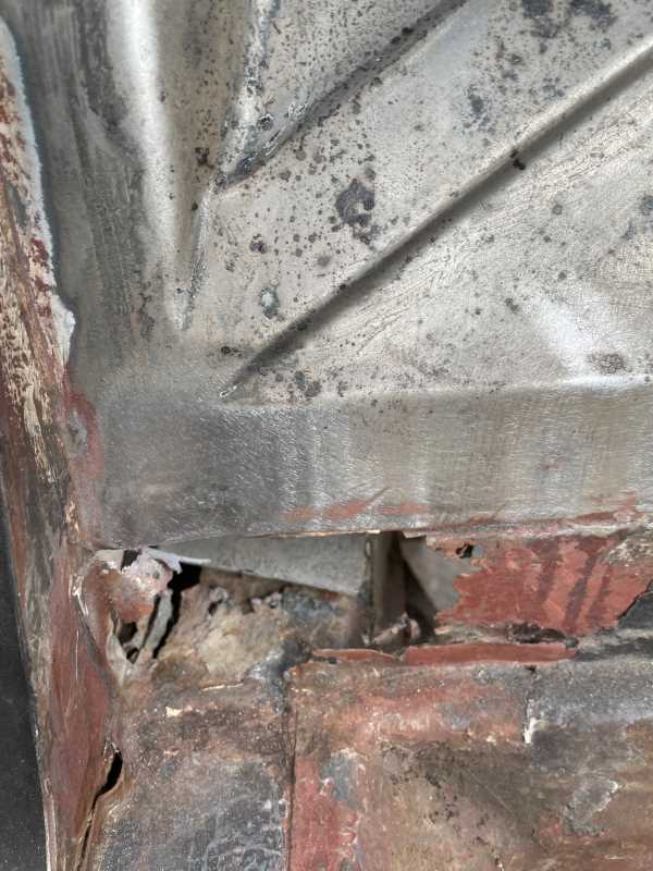

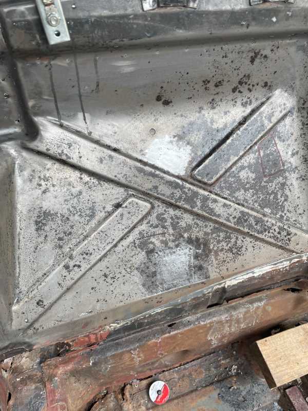

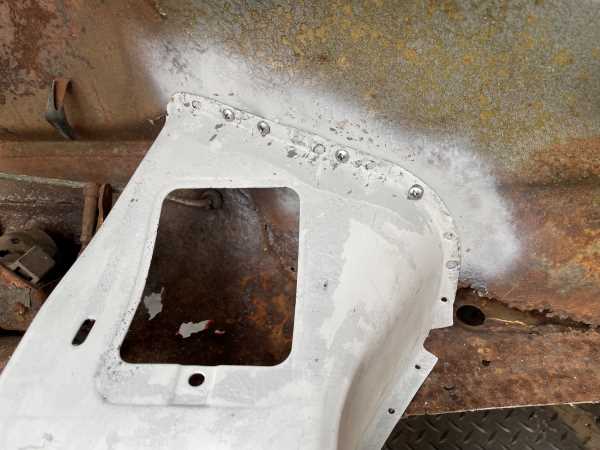

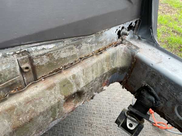

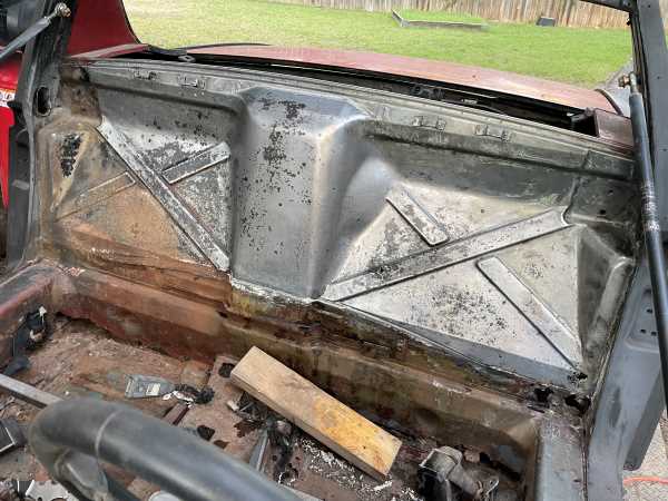

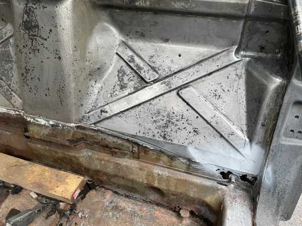

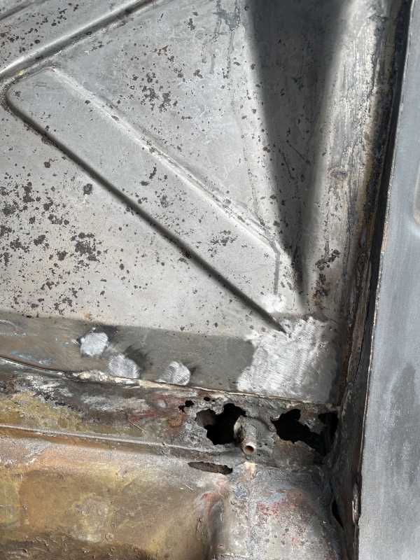

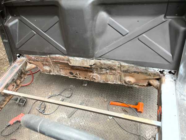

Upper Firewall: I decided to start here with this large piece to see how bad things were with the rust and the paint. The following images show my work to try and save/restore the metal. I found that by scraping, wire-wheeling, and using rust remover I could slowly begin to expose the metal. I soon came to realize that sand blasting or rust encapsulation would be the solution with this panel. Regardless of my decision, new metal would be needed to repair the holes and areas of really heavy pitting. In the end, I decided to scale back the size of the patches (see marks vs. actual patch size) and went with a brush-on, high temp rust encapsulator after properly preparing the surface. Here are the photos that show the progression with an ultra-rare cameo by yours truly.

Edit: Fred posted firewall pictures while I was typing.
Look at that work! Better than 95% of the "body shops" out there!
I think Fred is "sand bagging" us...
He sounds like a beginner but his work SCREAMS MASTER!
Nicely done Sir!
Really NICE!

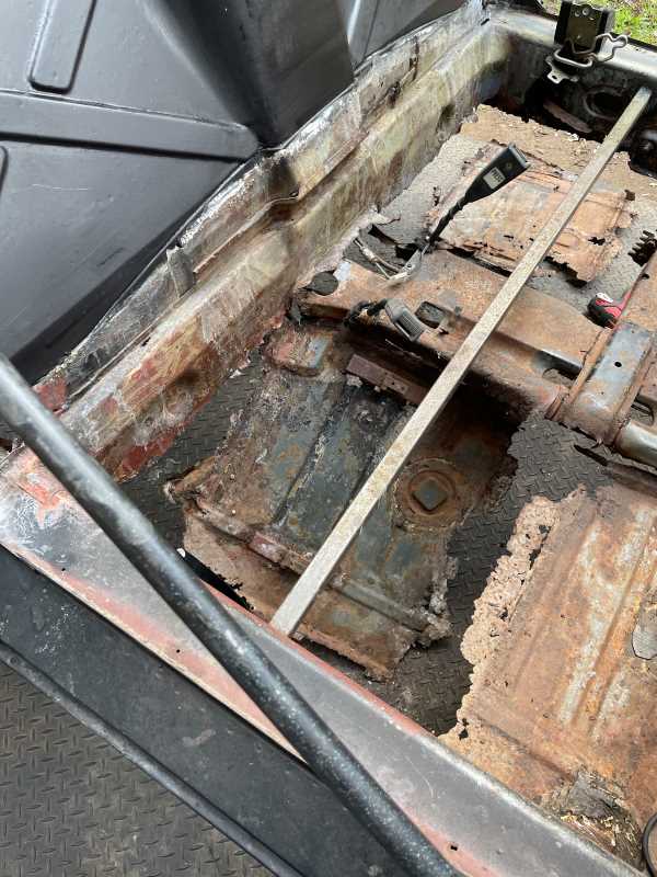

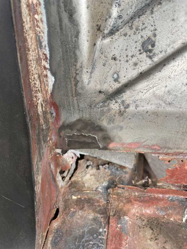

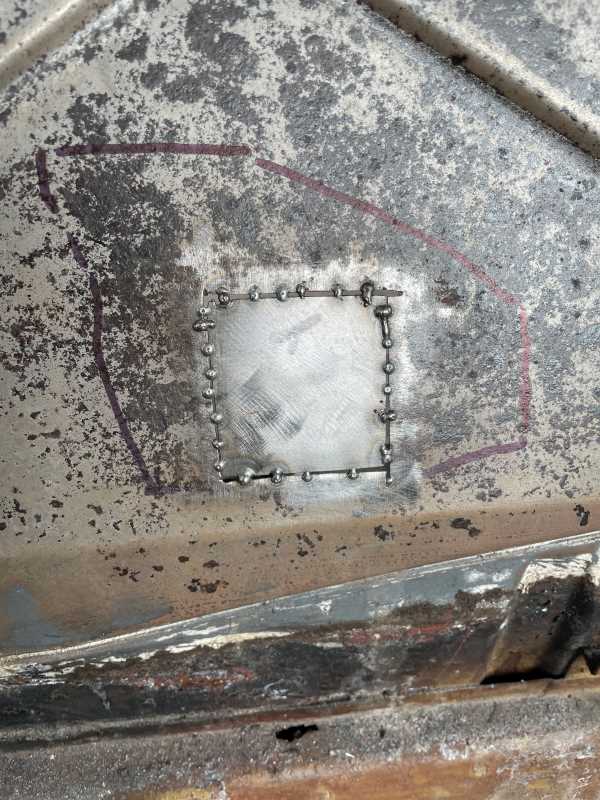

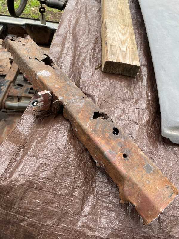

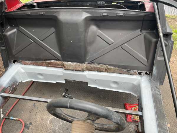

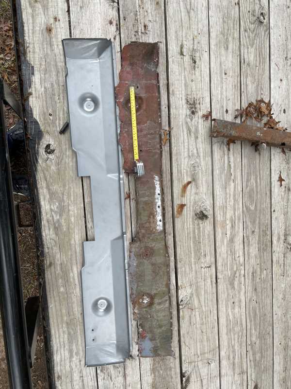

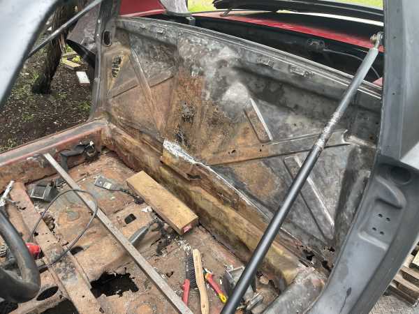

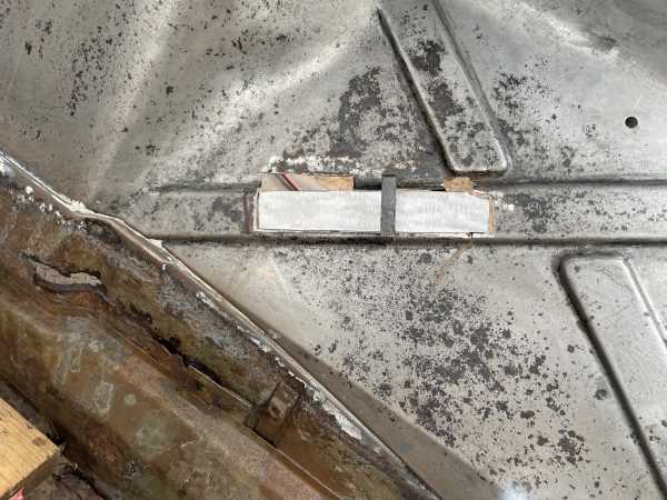

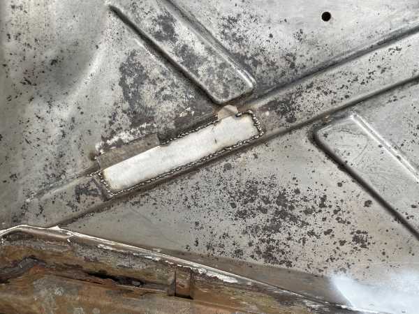

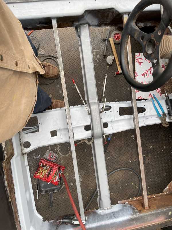

Inner Firewall / Transverse (12/2022): Before I could mount the car on a rotisserie, I had to first replace the unsalvageable crossbar and tunnel. The metal here was so weak from rust, you could move the structure with your hand about 6 inches in either direction. These photos show the reinforcement followed by removal of the "floors" and support metal. Notice the rust tear along the passenger side longitudinal.
Next, I removed the welds on the traverse. I wanted to leave the lower firewall (behind it) for strength. With the part removed, I was able to take measurements and transfer the speed nuts (?) over to the new panel and weld the piece in place. The welds into the lower firewall will wait till that piece is replaced later.
friethmiller

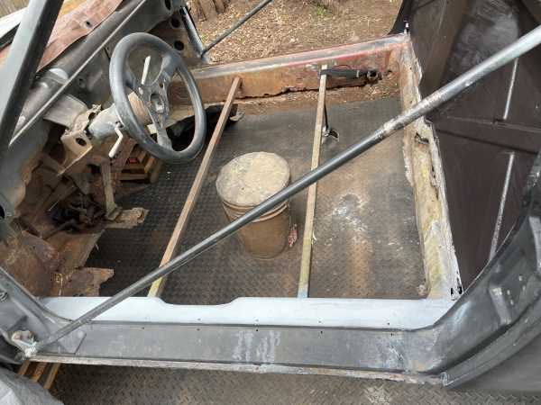

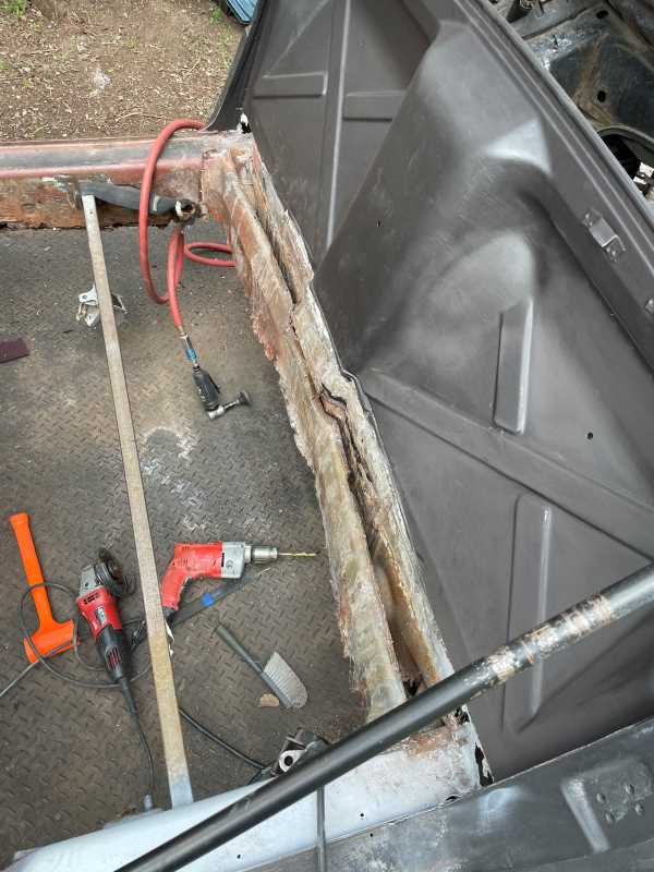

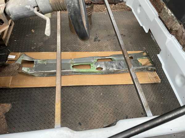

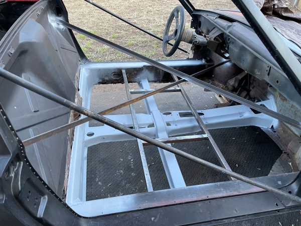

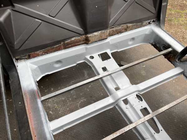

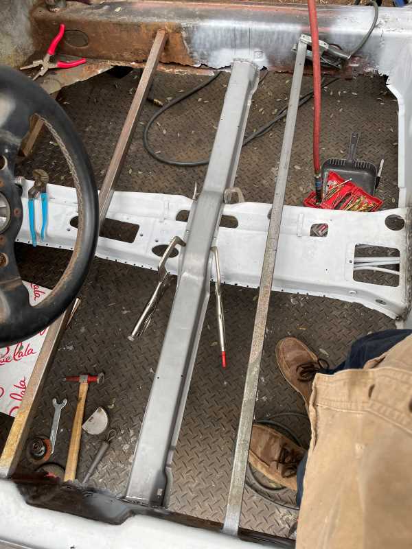

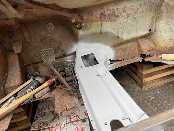

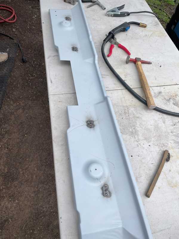

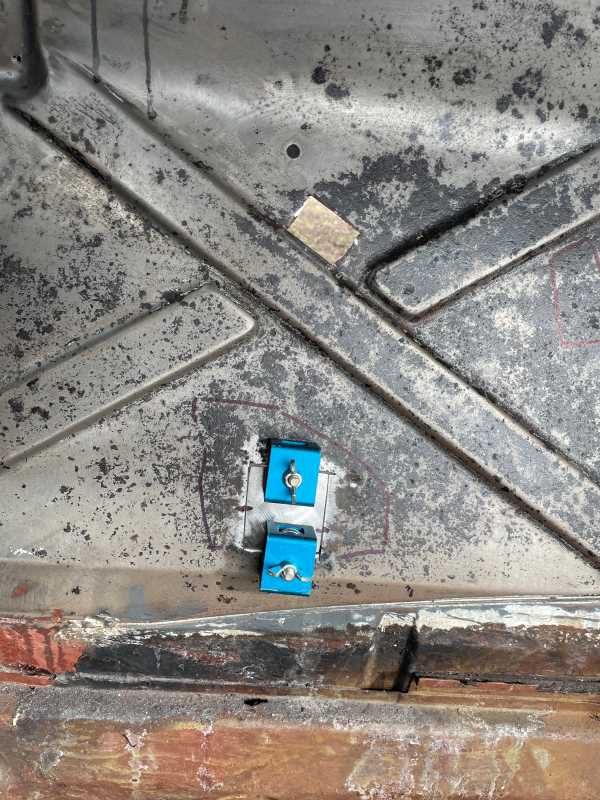

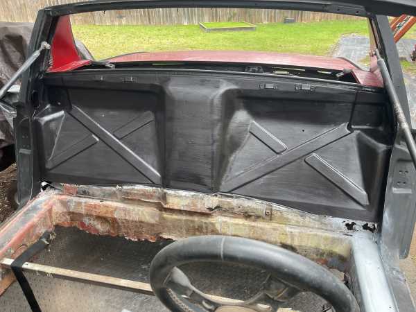

Tunnel and Crossbar (12/2022): After purchasing a used tunnel from 914Werks (Thanks Rich!), I prep'd and installed the tunnel followed by the a new crossbar from Restoration Design. At the end, additional bracing was added prior to mounting on the rotisserie. Some of the lower bracing will be removed once the passenger side longitudinal is repaired.

Awesome work! At first glance, I thought you were installing diamond plate in the floors.

QUOTE(Aerostatwv @ Dec 15 2023, 10:12 AM) *
LOL! Yeah, I didn't want to be down on the dirt so I ordered a cool looking rubber mat.

The wildest thing is he's doing this in the DIRT!

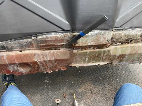

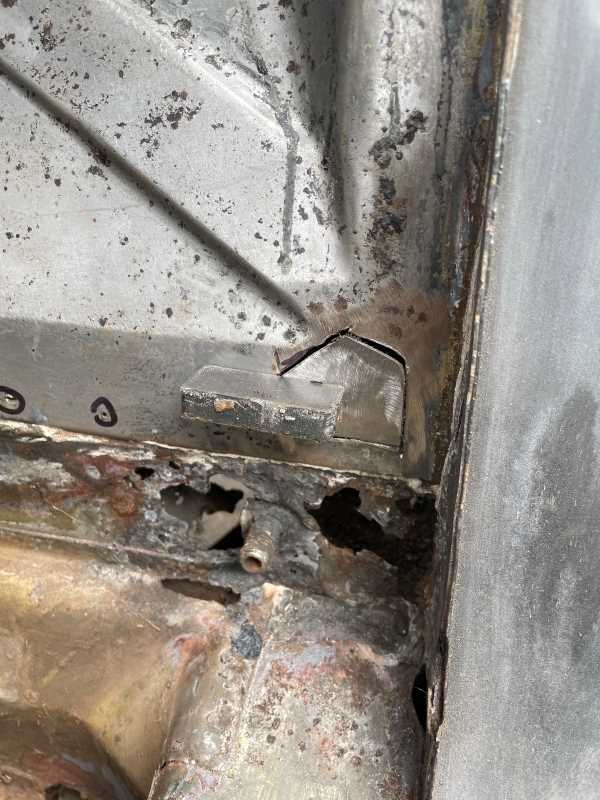

Work that will require CLOSE inspection to determine it's been replaced.
One of my rules is "leave no marks" if possible. He's getting close on a "complete loss of pan" car...
I wouldn't have thought a novice could produce that level of work in the best of environments.
Doing it "in the dirt" makes it all the more impressive IMO.
