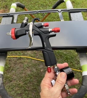

QUOTE(930cabman @ Nov 4 2025, 06:28 PM) *
QUOTE(friethmiller @ Nov 4 2025, 06:19 PM) *
QUOTE(bkrantz @ Nov 3 2025, 08:30 PM) *
Looking great, Fred.
Thanks man! I might be doing some more painting soon. I'm still figuring out which way I want to go on this car (IMG:style_emoticons/default/idea.gif)
What spray gun have you been using?
I used a $70 dollar LVLP Gun made by Aero Tools - purchased from Amazon. It’s an excellent gun for the price. Fan pattern could be wider but it works great. I will likely switch over to my more expensive HVLP gun (Iwata W400) for the exterior surfaces.

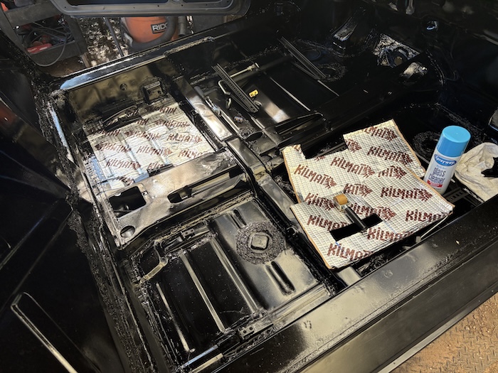

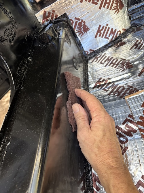

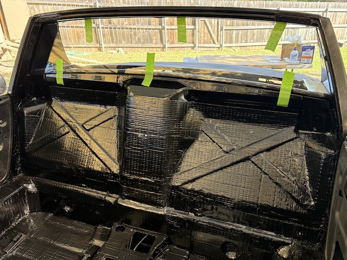

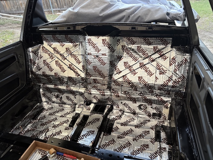

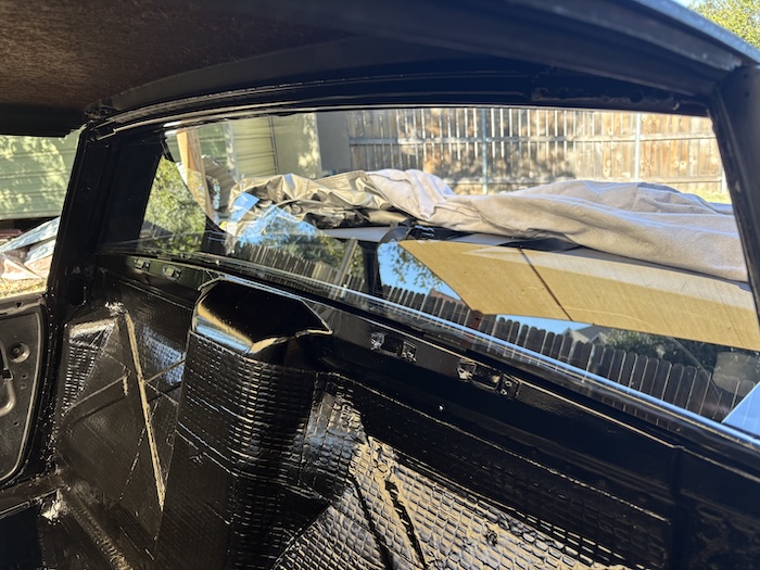

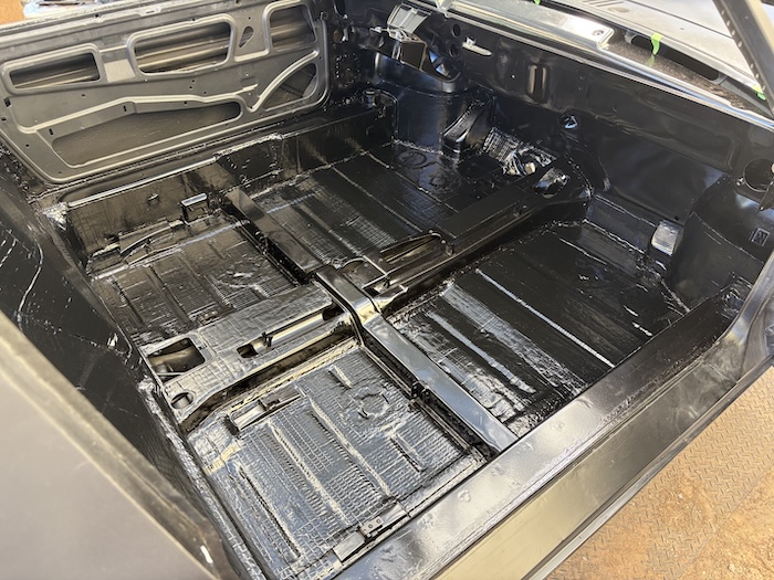

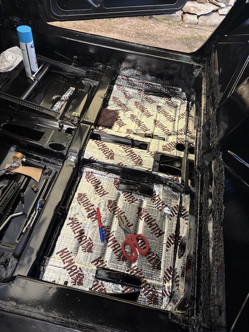

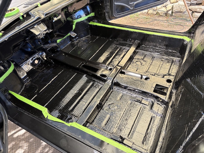

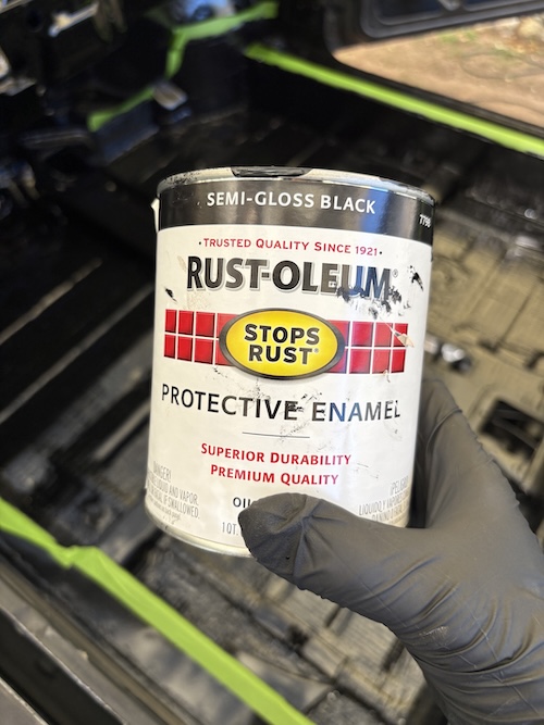

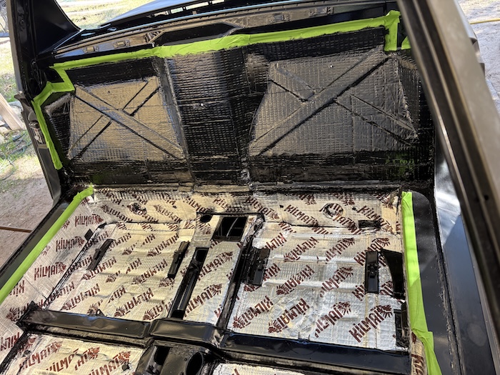

Sound Deadening (11/8/2025):
With high winds forecasted for Sunday, I jumped in early Saturday morning to try and get a few projects underway on the LE. The first order of business was to add some sound deadening to the interior. Goal was to get a lot but not every square inch covered. I started in the seat area and moved back to the firewall. From there I moved forward to the footwell. While not exactly the hardest thing to do, you still need to clean, scuff, and re-clean each area before applying the mats. The whole process take a good bit of time. I will say, the grids imprinted on the foil top really help for sizing and cutting the butyl squares.
I decided to avoid the spaceship look and attempted to paint the mats. After a quick test, I determined the foil could be easily painted by scuffing the surface with 220-grit and ensuring the surface was clean. Photos show the firewall area and then the rest of the floor installed and painted. To do this, I used a semi-gloss enamel, applying it with a brush and a 2" roller. While the two blacks are very similar, I used tape to keep them separated. I think it turned out pretty good.
More to come shortly. Cheers! (IMG:style_emoticons/default/beerchug.gif)

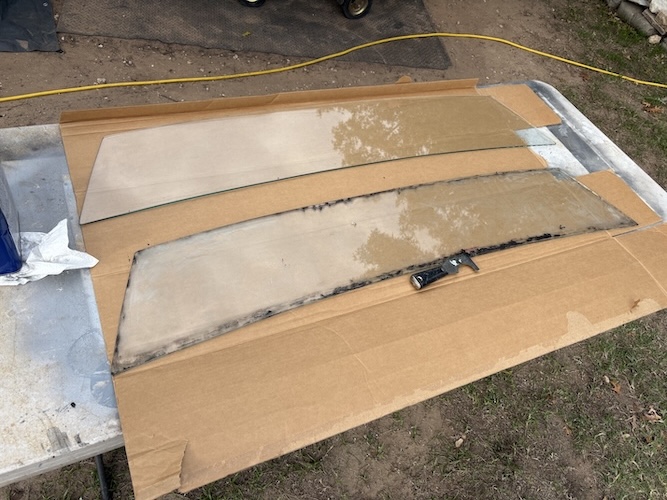

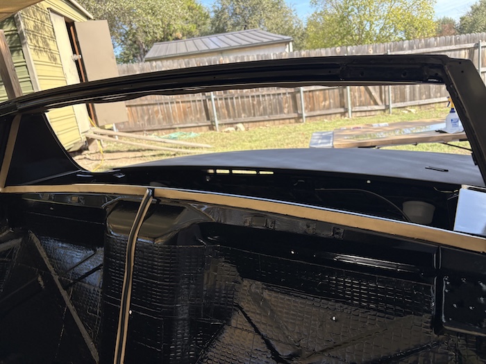

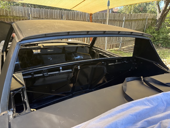

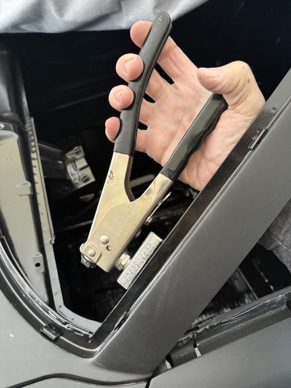

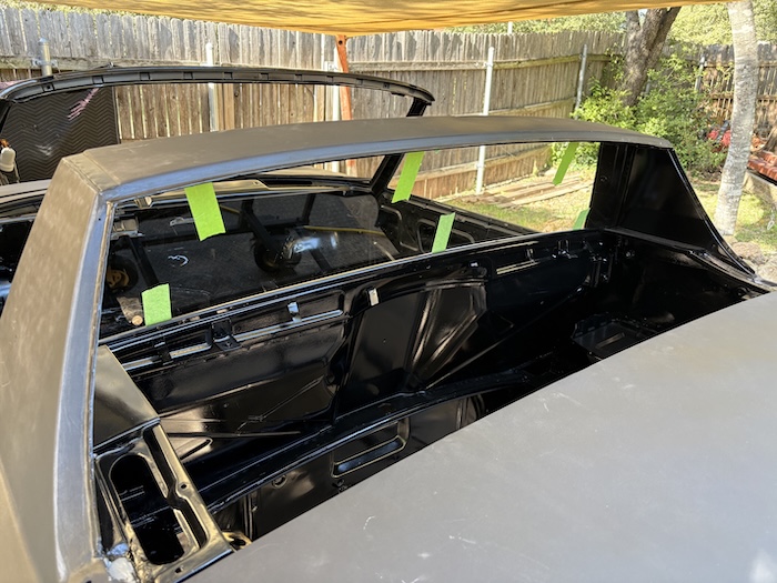

Rear Glass Install (11/9/2025):
With the interior spaces painted I'm now able to install glass. I decided to start with the back window first. Here you can see I had two options: 1) use my spare window that I pulled out of a parts car a few years ago, or 2) use the nasty one out of the LE that had previously been tinted purple (since removed) and covered with butyl. I decided to clean up both pieces and pick the best one. As you can imagine, the one from the parts car cleaned up quickly, the other one took a bit longer. (IMG:style_emoticons/default/blink.gif) In the end, I picked the once "nasty" one from the LE. Note: I did use a water spot remover polish over the entire piece with a 3" orbital with a spacer pad.
After applying a pinch weld primer around the opening, I then applied the butyl tape. After inserting the small window blocks at the bottom, the window was then pressed into place. Later, I will apply black electrical tape to the bottom of the glass to help hide the butyl from view.

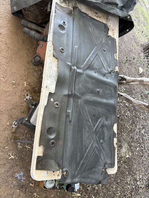

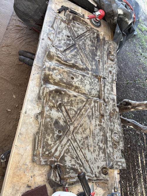

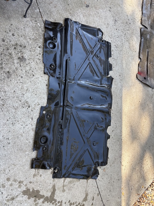

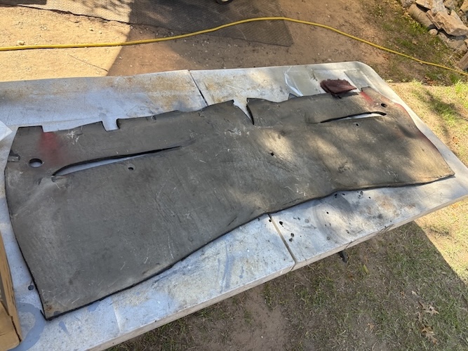

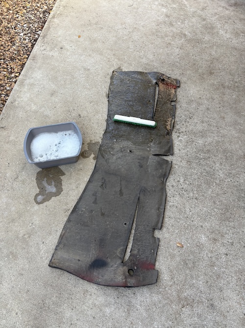

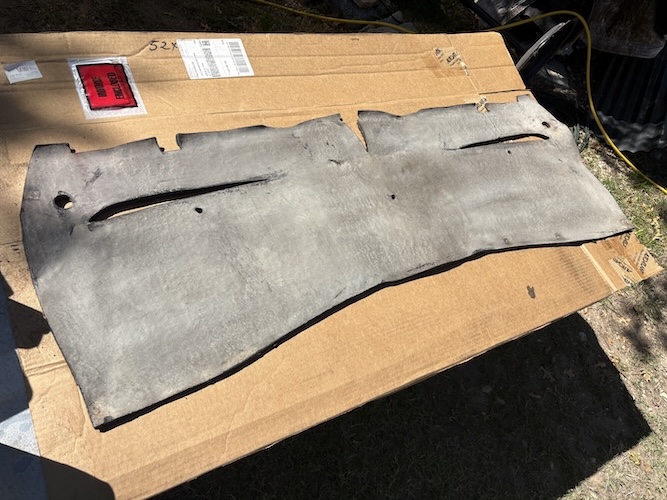

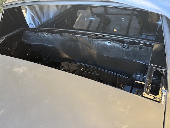

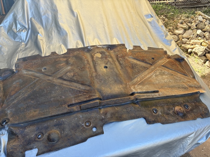

Engine Pad and Backpad Restoration (11/8 - 11/9/2025):
These two gems were salvaged from the LE. Unbeknownst to my wife, I've been storing them under one of our couches for the past 3 years. It was finally time to pull them out Saturday, clean them up, and then decide if they were worth using. Here you can see me cleaning the backpad (that goes on the inside of the upper firewall) and then the engine sound deadening mat that is mounted inside the engine bay on the opposite side.
On Sunday, I laid out the firewall pad and cleaned it with lacquer thinner and a 3M scratch pad. Not exactly sure what the original color once was but ended up repainting with a flat black out of a rattle can. Despite the wind, I was able to get full coverage with just two coats. Next, I climbed up in the engine bay and with 2 new engine pad fasteners, I mounted the pad. Think this will work! (IMG:style_emoticons/default/aktion035.gif)
Moving on to the backpad, I actually determined this piece to be usable, as well. However, it was definitely in a little worse condition. It had cracks in a few spots. Some being poorly repaired and others not all. I wasn't real sure I wanted to "glue-in" this piece over all my beautifully painted butyl. (IMG:style_emoticons/default/huh.gif) I didn't see the benefit. In the end I decided to just clean up the part for now and decide later to either use, discard, or resell it. Here's a few pics of sanding the adhesive from the back and the clean up and reconditioning of the outward facing side. I left the piece to sit for now. I will revisit / decide later. I will certainly take input from others on the matter (IMG:style_emoticons/default/biggrin.gif)

Fred, one suggestion: put some masking tape X's on that rear window. It looks so clean you might not see it and forget you installed the glass. Seriously.
friethmiller
post Nov 9 2025, 08:39 PM
Post #691
Posts: 1,130
Joined: 10-February 19
From: Austin, TX
Member No.: 22,863
QUOTE(bkrantz @ Nov 9 2025, 08:37 PM) *
Great idea! Will do!

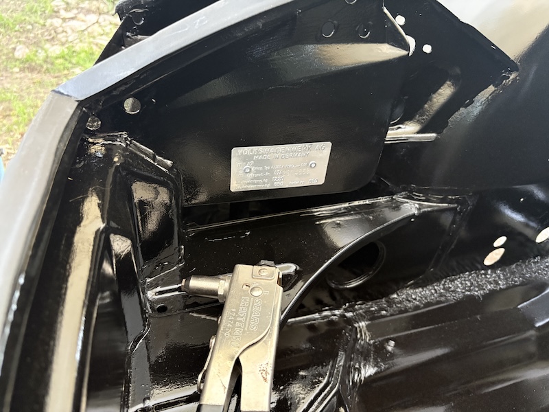

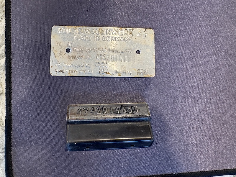

Cleaning/Installing Vin and Chassis Plates (11/10/2025):
As the days get shorter I have less time to get things done outside. Here's what I lined up for today afterwork. Pics show the original chassis and VIN plates that I removed 3+ years ago, the clean-up, and finally the install. I used lacquer thinner and a piece of #000 and #0000 steel-wool. It seems like such a small thing to do but it's a big relief to get them back on the car. (IMG:style_emoticons/default/biggrin.gif)

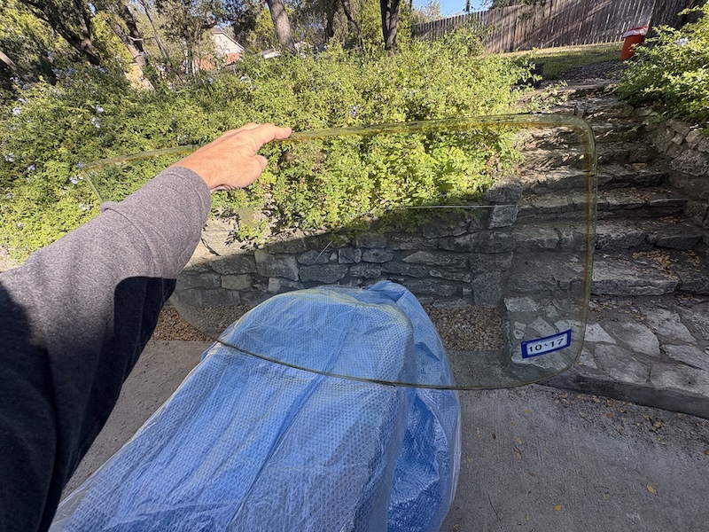

Front Glass (11/11/2025):
I was given this original SIGLA windshield about a year ago. Not sure when it cracked but it's unfortunately unusable. (IMG:style_emoticons/default/sad.gif) @914werke - I just ordered one from your site, fyi.
