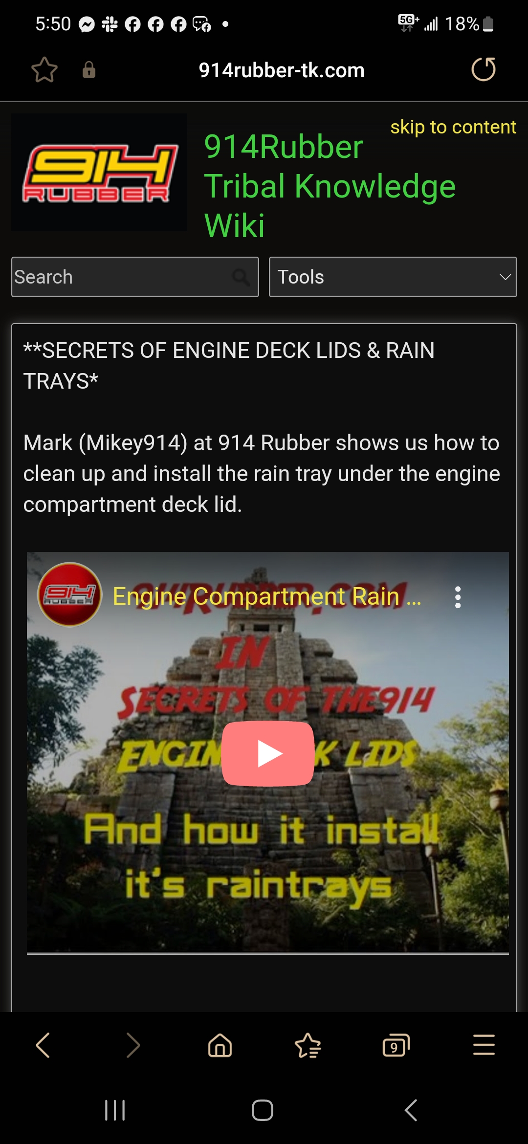

This may be helpful
https://914rubber-tk.com/doku.php?id=engine...ay_installation

And another perspective…also using 914rubber parts.
https://www.youtube.com/watch?v=H5B108S6DvA
Also from about 4:45 on this one…
https://youtu.be/t6B3gKW9nPA?si=yok2rxDkBR1VciTV
