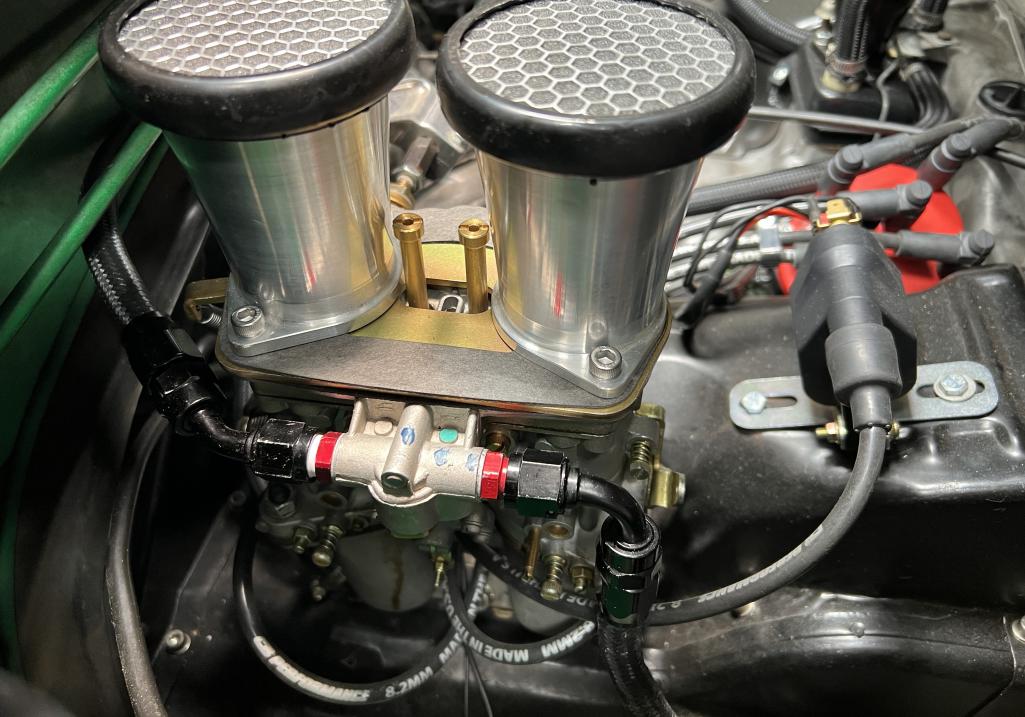

Just had a minor issue with “did not fill gas on time” and the sediment clogged the fuel pump, so I need to install a new pump (that will include a pre filter) but I wonder if you have a clever install idea. You can share for the install.
I have a 2.2L, with 44mm twin weber motor.
