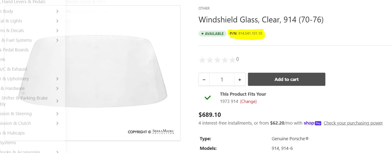

These OEM windscreens are available in clear or tinted per these two part numbers.
Clear: 914-541-101-10
Tinted: 914-541-102-10
By tinted, I am not sure if they mean with a dark shaded band at the top or overall tint like the side glass (Delodur-1 and Delodur-F, -1 clear and -F tinted).

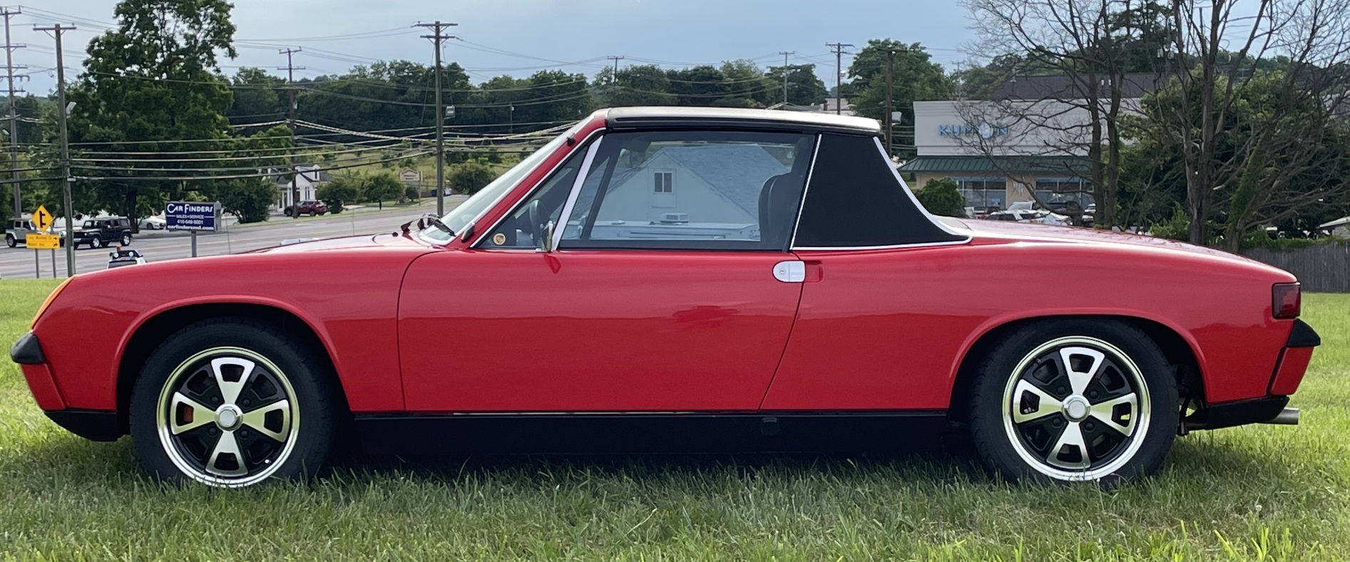

For those who aren't familiar with what I am referring to as the shape, I found these two pictures trying to show it. The orange car (Porsche's 914-8) obviously has the genuine windscreen while the red car has a generic replacement. You can see how the top part of the windscreen is "bubbled up" creating a nice flowing live vs a sharp transition.

Montreal914   Thank you! :) Yes, Pilkington tinted (914-5...   Jan 15 2024, 04:15 PM

friethmiller   @Montreal914 A few photos for you of my new wind...   Nov 28 2025, 09:48 AM
Montreal914   @friethmiller Yes, Fred that is very helpful. Th...   Nov 28 2025, 10:22 AM
