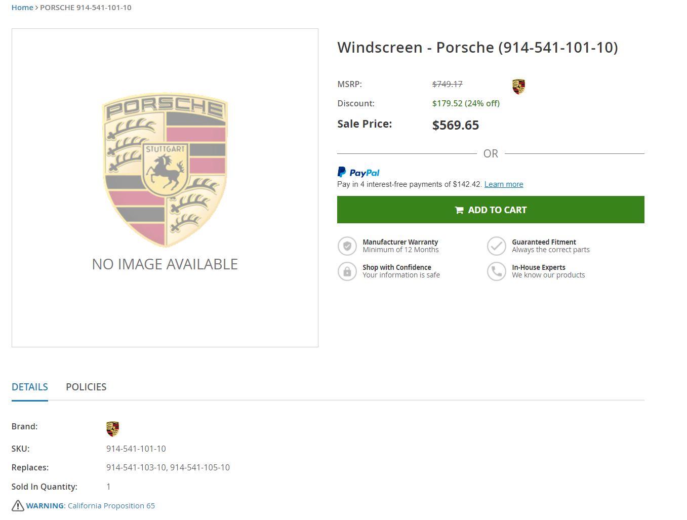

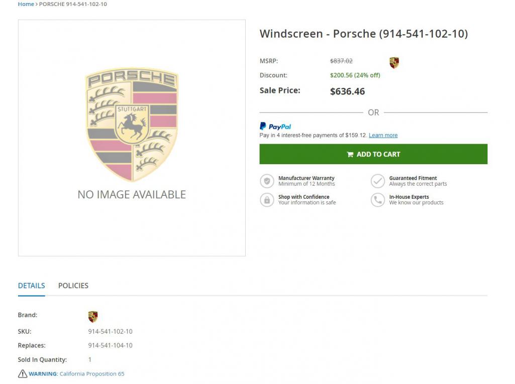

Well, the two numbers seems to be available, both 101 and 102.
Here are the screenshots of both numbers from the same Porsche dealer, yet the price is different. I doubt these are the same part with different price. (IMG:style_emoticons/default/blink.gif) Surely, there must be a difference. From the Porsche parts document, the 101 is clear and the 102 is tinted.
But you clearly know more than I do! (IMG:style_emoticons/default/laugh.gif)
If you think the cheaper one from Porsche will be a good matching shade with my side Delodur-F, I definitely prefer the lower priced one. (IMG:style_emoticons/default/smile.gif) BTW, that price was $508 and went up to $570 January 1st. (IMG:style_emoticons/default/dry.gif)

QUOTE(Montreal914 @ Jan 15 2024, 05:02 PM) *
(IMG:style_emoticons/default/biggrin.gif) (IMG:style_emoticons/default/biggrin.gif) its all a mystery mate. (IMG:style_emoticons/default/biggrin.gif)
not sure what porsche is offering.
but whatever the case, you are after the tinted one given your side glass and you will find the clear one very clear if it is in fact a match for the original factory ones.
i can tell from those original two photos you put up of pilkington screens on two cars that they are marked as what is commonly available on modern cars as a clear screen.
the two vertical marks (sometimes sloping or italicised) that are next to the circle with the E. what indicates a standard clear screen in the modern world.
the original screens had very different coding on them that indicated clear or tinted.
in the thread i linked were those markings for both sigla and kinonglass.
as to what porsche or sierra mardre are offering i don't really know.
i think how they would indicate its a clearer glass than 70% must be by some other coding than what is shown in those two pilkington screens you posted.
none of the rest of the coding in those screens indicates tinting to the best of my knowledge. its entirely possible they are reproducing somehow those original much clearer screens. but i am not sure really how that would be marked or indicated on the screens.

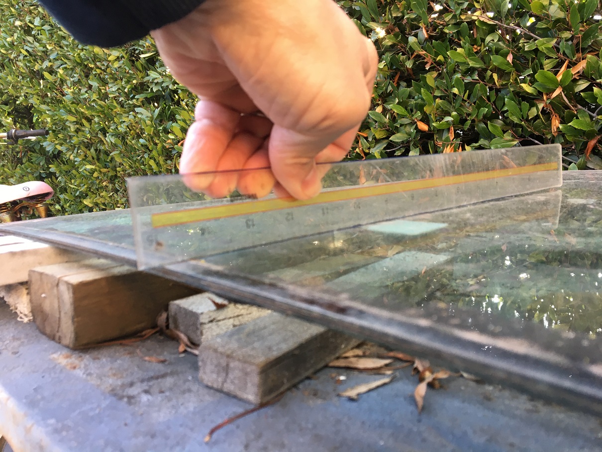

In the meantime @Technicalninja , here is a picture of the middle area of a knockoff replacement windshield. It's really flat at the top for about 12" and barely 1/8" in 15".
I will be curious to see a similar picture of your original windshield. (IMG:style_emoticons/default/idea.gif)

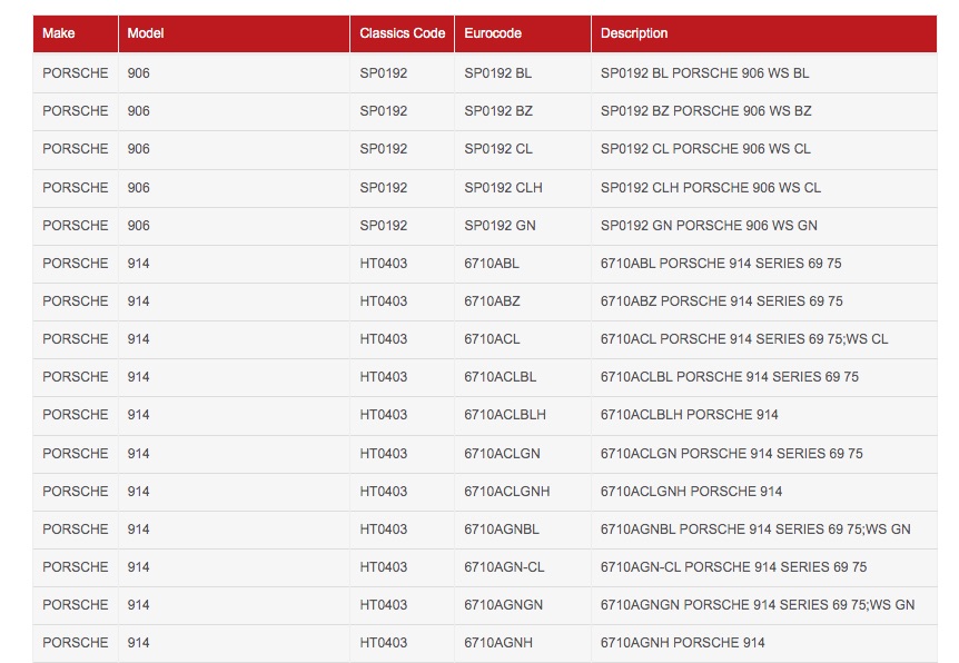

you could try getting in contact with pilkington classic direct @Montreal914 .
i found the link i had filed away from screen research a few years back.
link still works. its a european website. maybe UK based.
https://www.pilkington.com/en-gb/uk/automot...assic-cars-home
they have a whole series of listings for the 914 that i cannot unscramble.
i have no idea what they mean as they don't have an abbreviations decoder to go with their classic parts listing.
but perhaps if you emailed them they might explain what they all are.
this would be where porsche themselves are sourcing the windscreens they sell as spare parts. its likely all this reduces down to something like a clear screen version and a "tinted" screen version but i can't work it out.
when you select porsche in their home page you get this list for the 914.
which is more than two different types, so i don't really know.
this could be a reference to all the different windscreens that were in the 914s as they progressed through the model years. i do know that the kinonglas screens evolved and updated processes were used in manufacture originally. so pilkington might simply be referring to all those particular original screens using some sort of original spec list from the original manufacturer suppier (subsidiaries of St. Gobain). only the kinonglass screens evolved. the SIGLA screens seemed to stay the same.
its a neat website when you cruise around in it.
they can pretty much make anything you want and will ---assuming you want to pay for it. there is a neat little piece in there on remaking the windscreen for a 917.
also if you cruise around you can find the bit where they can offer a windscreen marking. that is more or less period correct but incorporates the modern EU approval code markings that make your screen legal for registration and road use after restoration.
they do the triple XXX and SIGLA brand recreated markings. which are the two they have rights to reproduce. i think XXX was the original pilkington safety glass brand for the UK market. was not on porsches. i have no idea if you can get a one off screen or whether it has to be a minmum batch. but you fill out the forms that pop up on the website and order it. i dunno, if 914/6 guys out there want to get super uptight about it they can get one (it still won't be absolutely correct but (IMG:style_emoticons/default/biggrin.gif) (IMG:style_emoticons/default/biggrin.gif) (IMG:style_emoticons/default/biggrin.gif) ) but it will be legal.
you can get them in white ink. black ink or etched in.

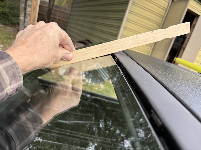

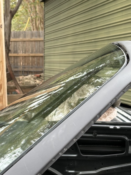

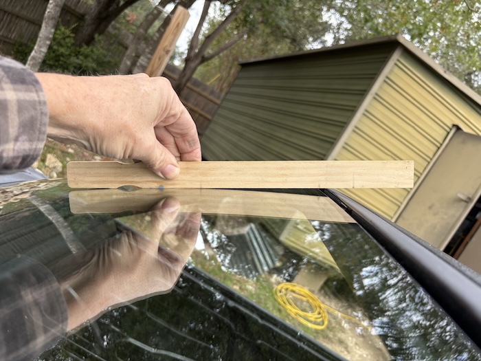

A few photos for you of my new windshield from 914Werke. Last photo is from 6" below the top of the glass frame, which is approximately where my rearview mirror is on my other car. My other '74 has an OEM Sigla windscreen and the curvature seem the same. Hope it helps!

@friethmiller
Yes, Fred that is very helpful. Thank you for taking these shots! Seems to have a lot more curvature than my very flat one. (IMG:style_emoticons/default/smile.gif)
When you get a chance (zero rush), can you take a last picture with the same paint stick but using its whole length from ~mid height to the top to see how much of a gap there is at the top? This would be a great comparison to my 15" plastic ruler picture of post #26.
Happy late TG! Looking forward to read your fast progress! (IMG:style_emoticons/default/smilie_pokal.gif)

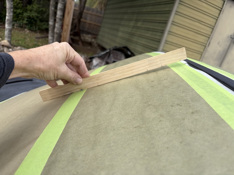

Sorry if I did this one going the wrong direction but here's the whole stick. Did this after masking the windshield. I think it shows the curvature, though. Hope it helps.

@friethmiller
Yes Fred, this is very helpful and clearly more curvature than my flat one.
I now know where to get my windshield, and cost effective too! (IMG:style_emoticons/default/smilie_pokal.gif)

Sorry if I missed it in this thread but is the clear one currently sold by the Porsche dealer the same as the original in terms of shape and brand?
Montreal914
post Dec 4 2025, 06:49 PM
Post #34
Posts: 2,053
Joined: 8-August 10
From: Claremont, CA
Member No.: 12,023
It is difficult to determine. I am not sure.
I was considering buying a Porsche one to get the bubble top, but without knowing if it will in fact have it, it is a lot of money to gamble.
The aftermarker option has some curvature, maybe not as much but for the price...
That being said, if you are restoring an all original car, that is a different story. I am not, but I like the rounded top.
post Dec 4 2025, 07:12 PM
Post #35
914-6 GT in waiting
Posts: 20,535
Joined: 19-September 09
Member No.: 10,825
My local Porsche dealer sells parts at a discount (DelawarePorscheParts.com) but will still allow returns without a restocking fee. Windshields can only be sold with in person pickup but maybe check on your local dealer return policy. I’ve purchased a lot of 911 glass but unfortunately have no experience with 914 glass from the dealer.
