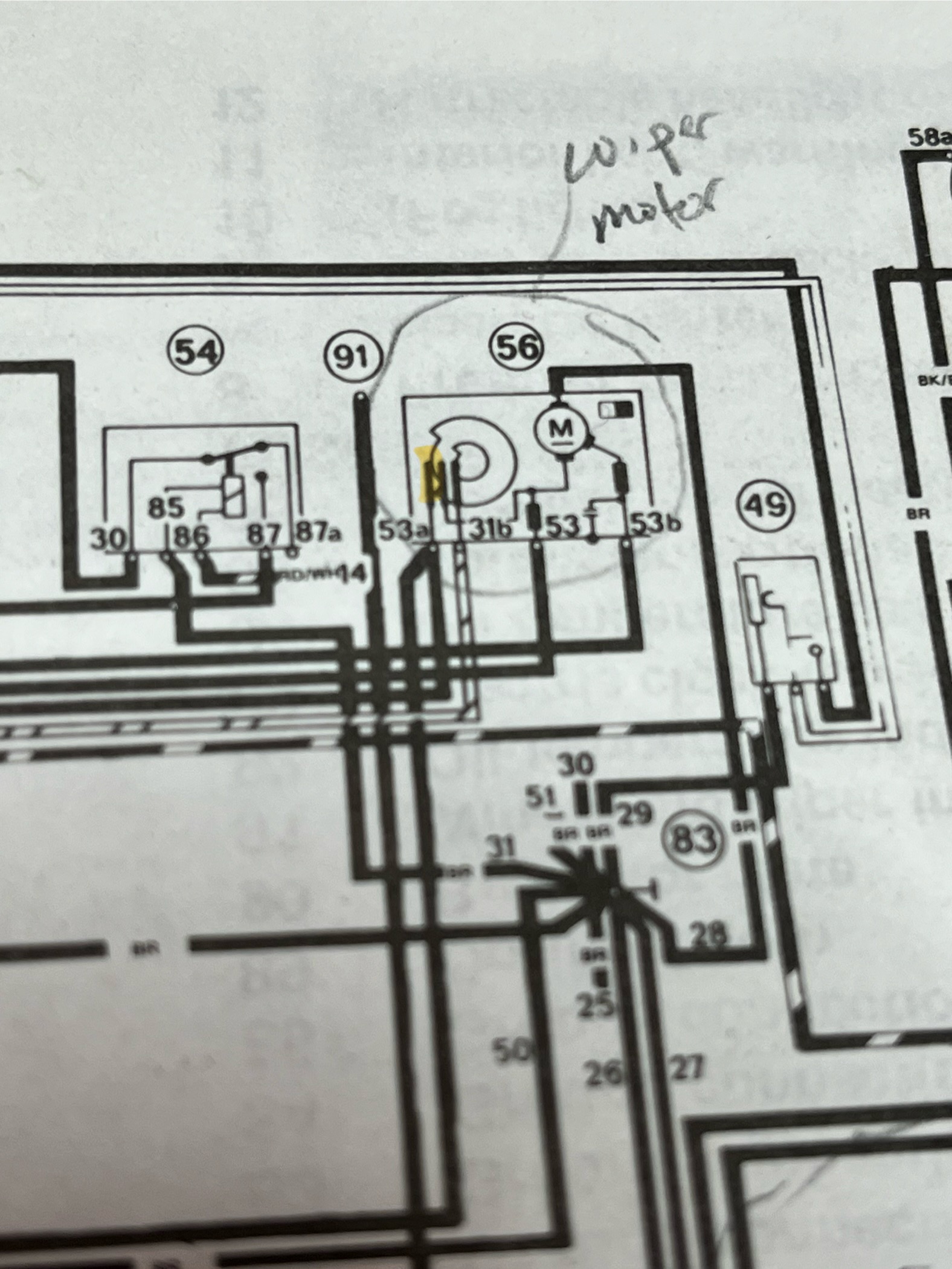

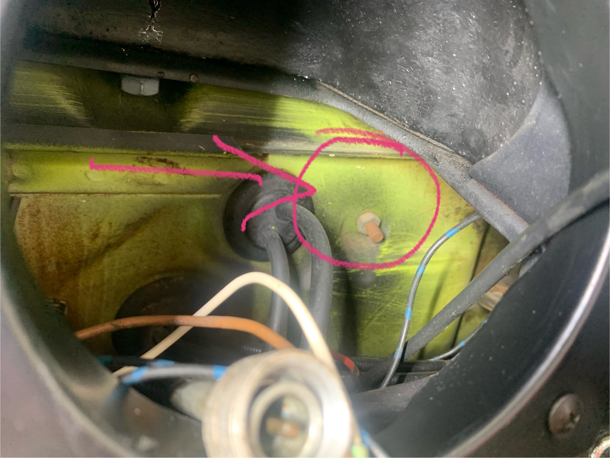

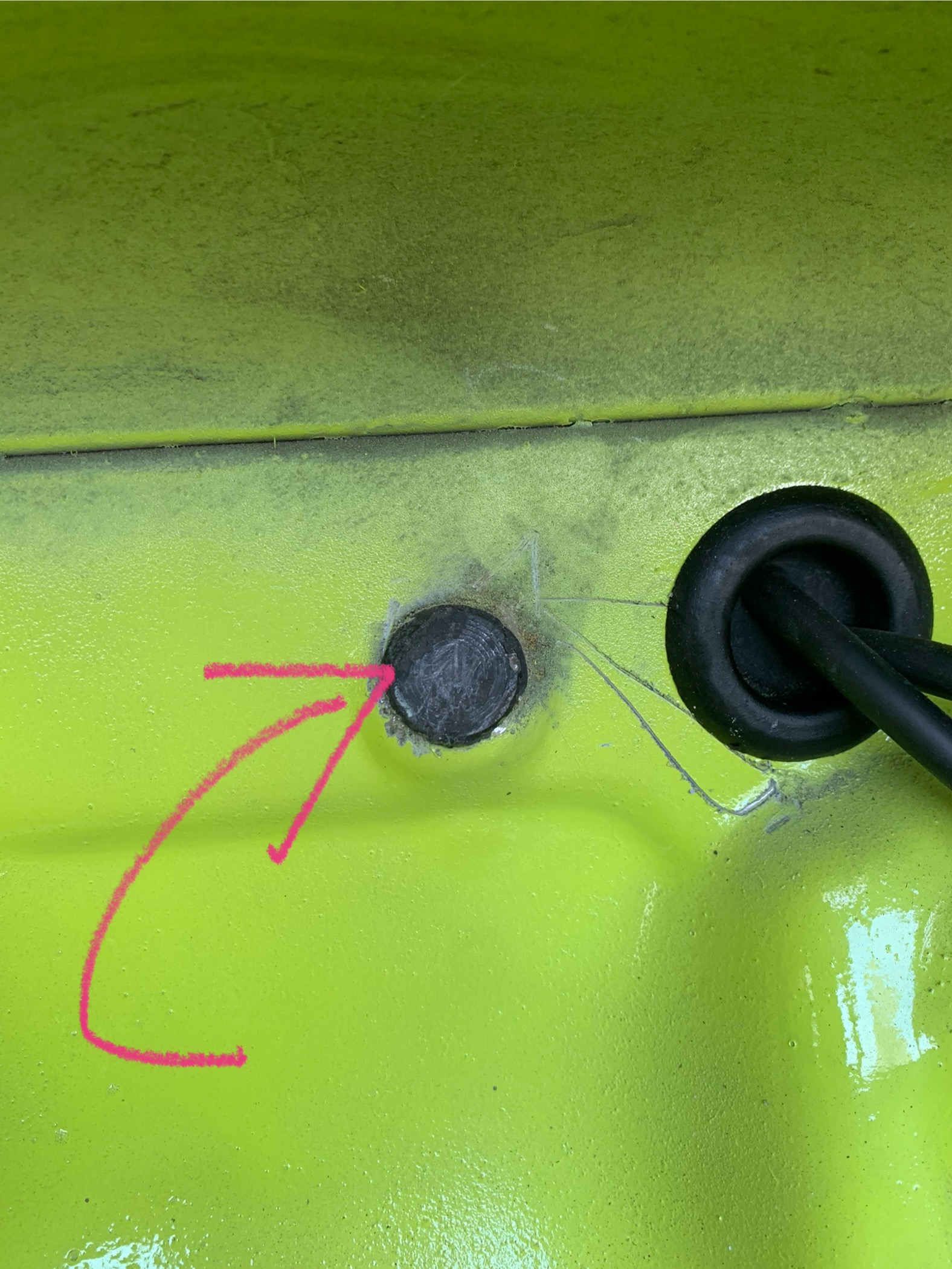

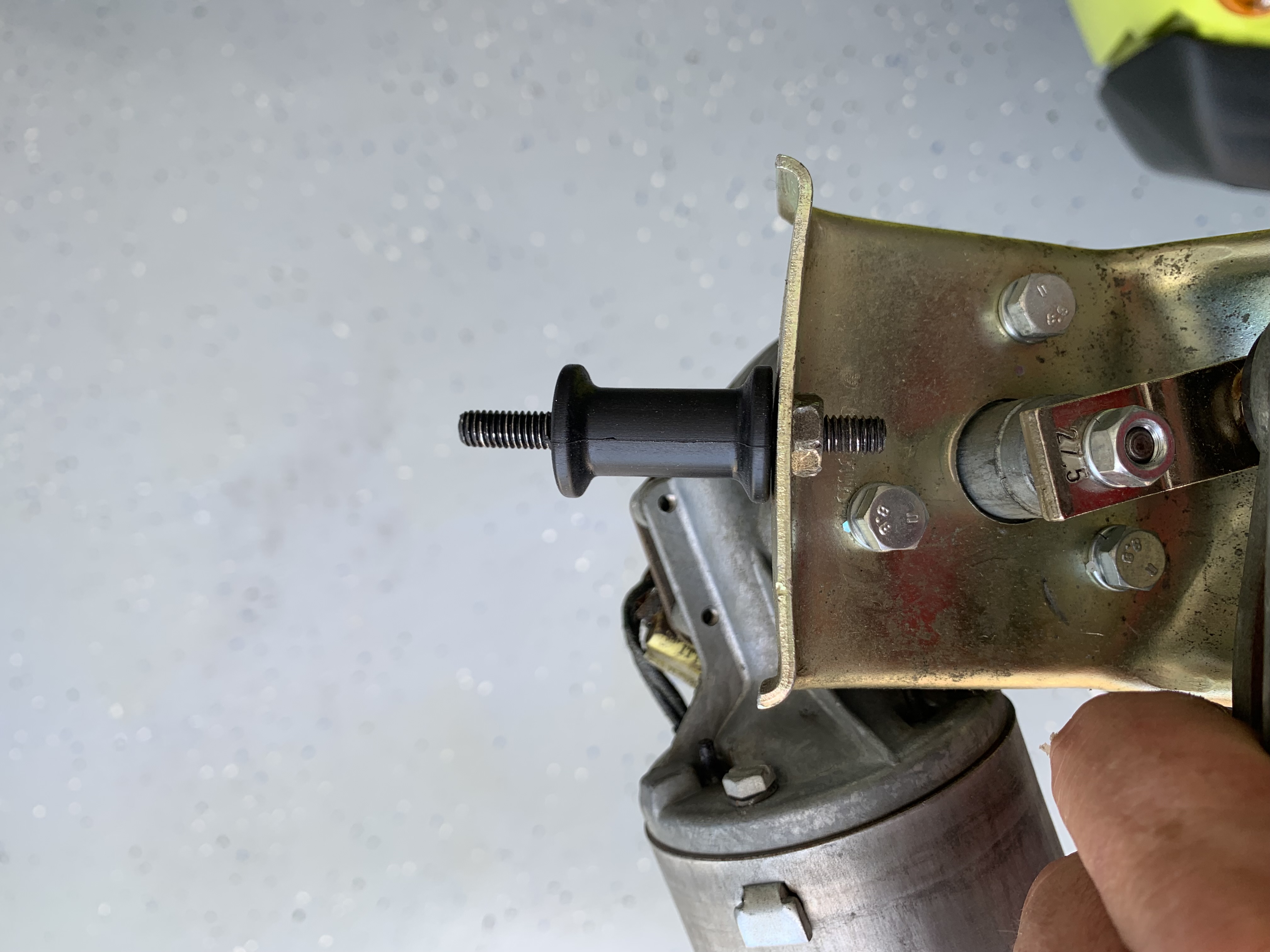

Ok. Finally getting around to addressing my wipers and the park position while I’m trying to install a new gas tank and rebuild my fresh air box.
While inspecting the old wiper assembly, I found a lot of wear and play that I didn’t like. So I’m swapping in a nice backup wiper motor assembly I had on the shelf. I have a new rubber isolator from 914 Rubber to replace the one that has basically disintegrated. The one end of the old isolator came off easy but the other end that attaches to the car is stumping me. How do I get that thing out?
DC_neun_vierzehn
post Jun 19 2024, 10:47 AM
Posts: 595
Joined: 16-November 20
From: Coastal Delaware
Member No.: 24,893
I’m guessing I have to get it from inside the car, under the dash. I have a center console that feels like it will be impossible to get to that nut and bolt. Am I wrong or will I likely have to remove some of the center console to get to it? I canr see the nut but I think I can see a few threads on a shift about where the isolator would enter the cabin.

QUOTE(Olympic 914 @ Jun 19 2024, 11:05 AM) *
Unfortunately there’s nothing in that thread that mentions the rubber isolator foot.
