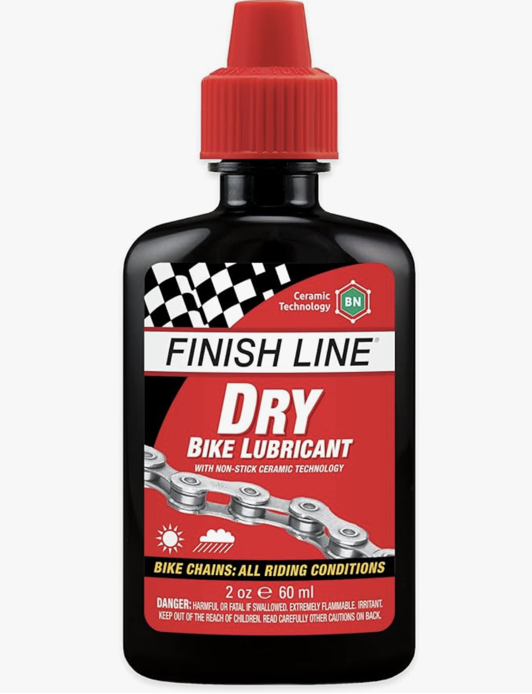

Last question ...
Before I attempt to re-install the fresh air box, should I lube each of the joints on the replacement wiper assembly and motor? And if so, what lube specifically should I use (a link would be great)?
As I understand it, the old style grease attracts dirt, which will be counter productive and cause wear. Is there a proven new product that is dry, but keeps things lubed to reduce friction?

QUOTE(DC_neun_vierzehn @ Jun 22 2024, 08:34 AM) *
Last question ...
Maybe something like this?
https://www.amazon.com/gp/product/B000C17HK...X0DER&psc=1
