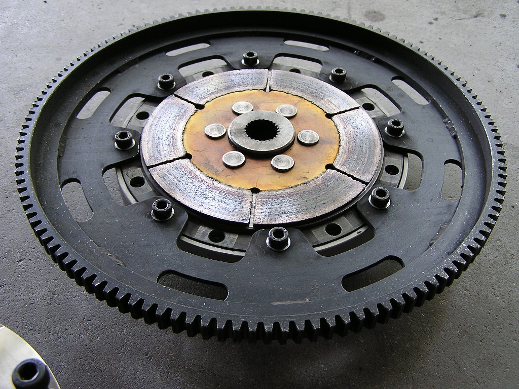

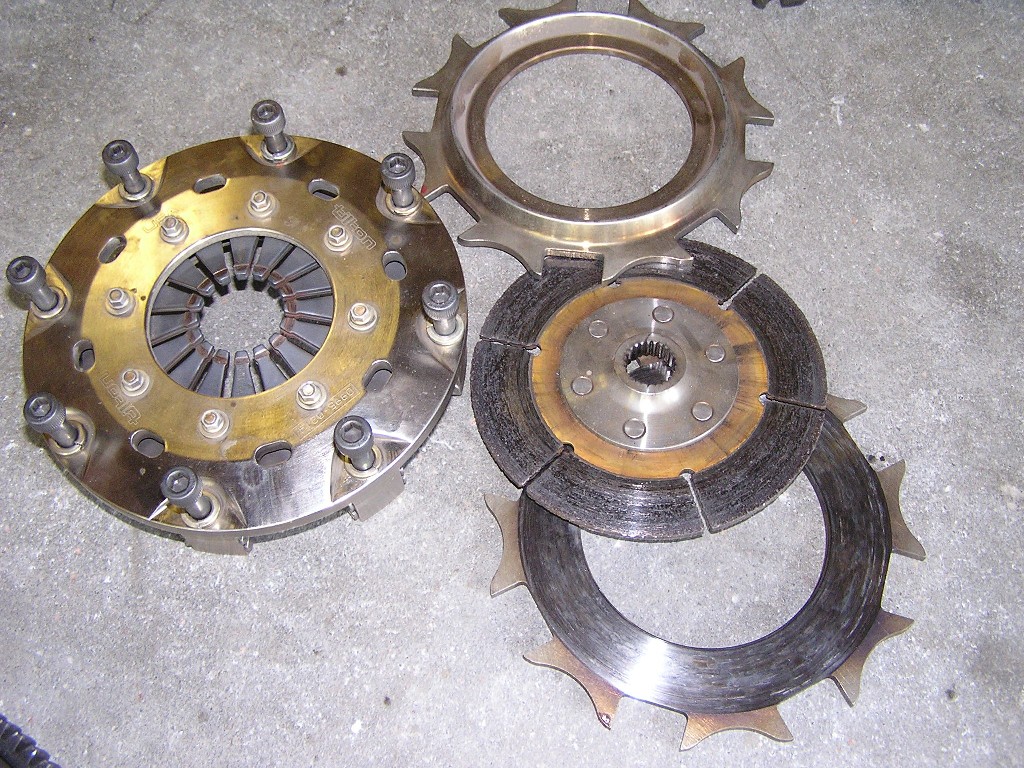

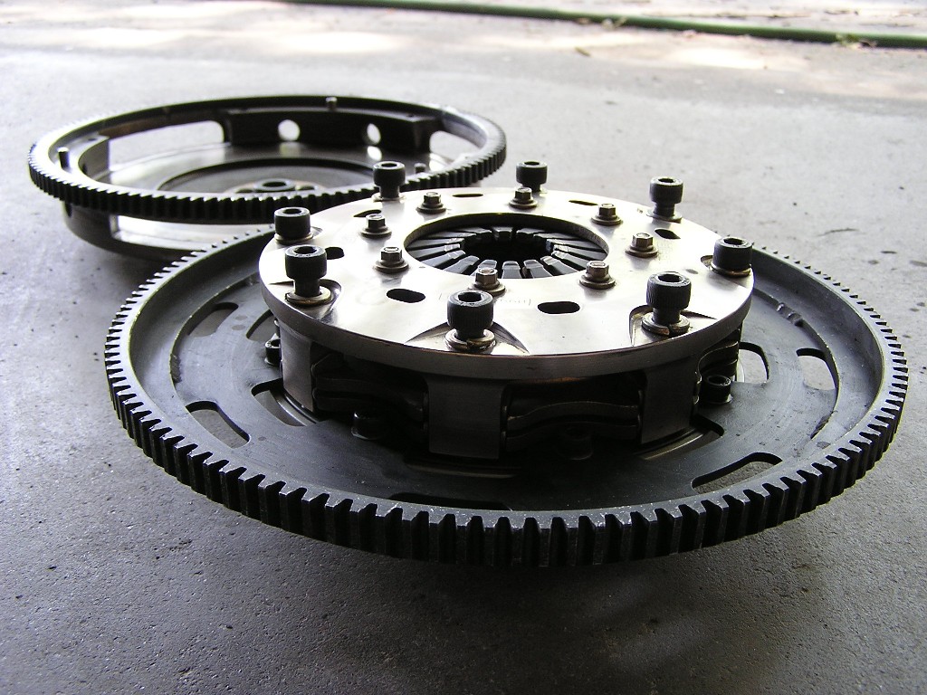

Dedicated track car I want the very least MOI in the clutch assembly.
Dual disc 5-6" tiny clutch on what looks like a TINY flywheel welded to a flex plate.
Weighs 1/4 what that stock stuff does...
Solid disc, no marcel, no springs in center, bitchy to launch, ceramic or sintered metal pucks, NOT street friendly at ALL!
This set up often rattles like a bitch at idle! Noisy, hard to launch, almost have to spin tires at launch. Bitchy to put on trailer...
The clutch pedal is more like an on/off switch and the initial bite is grabby as hell.

our old set up had a window'ed flywheel
the one I've ran for about the last 10 years
(wore out the first one and have already replaced all of the wear components)
is the tilton 5.5 inch, twin disc unit as described above.

QUOTE(technicalninja @ Mar 20 2024, 11:25 AM) *
(IMG:style_emoticons/default/agree.gif) (IMG:style_emoticons/default/agree.gif) (IMG:style_emoticons/default/agree.gif) (IMG:style_emoticons/default/agree.gif)
See, that stuff is available for 911s!
Was it as I described in use?
Those are usually stupid STRONG and last a long time.
Often, they have a very MILD clutch pedal not significantly heavier than stock.
Just difficult to modulate at low speed and at launch.
very much like you described...
literally an on/off switch
especially difficult in the pits and low speeds
perfectly fine on the track once rolling
absolutely no way you could drive on/off of a trailer.
I got tired of pushing into the trailer and had to buy a winch due to the clutch
wear and life.
they are pretty sensitive to over heating
the design creates NO slip...
the metal plates warp easily if the driver tries to slip the clutch (to get rolling etc.)

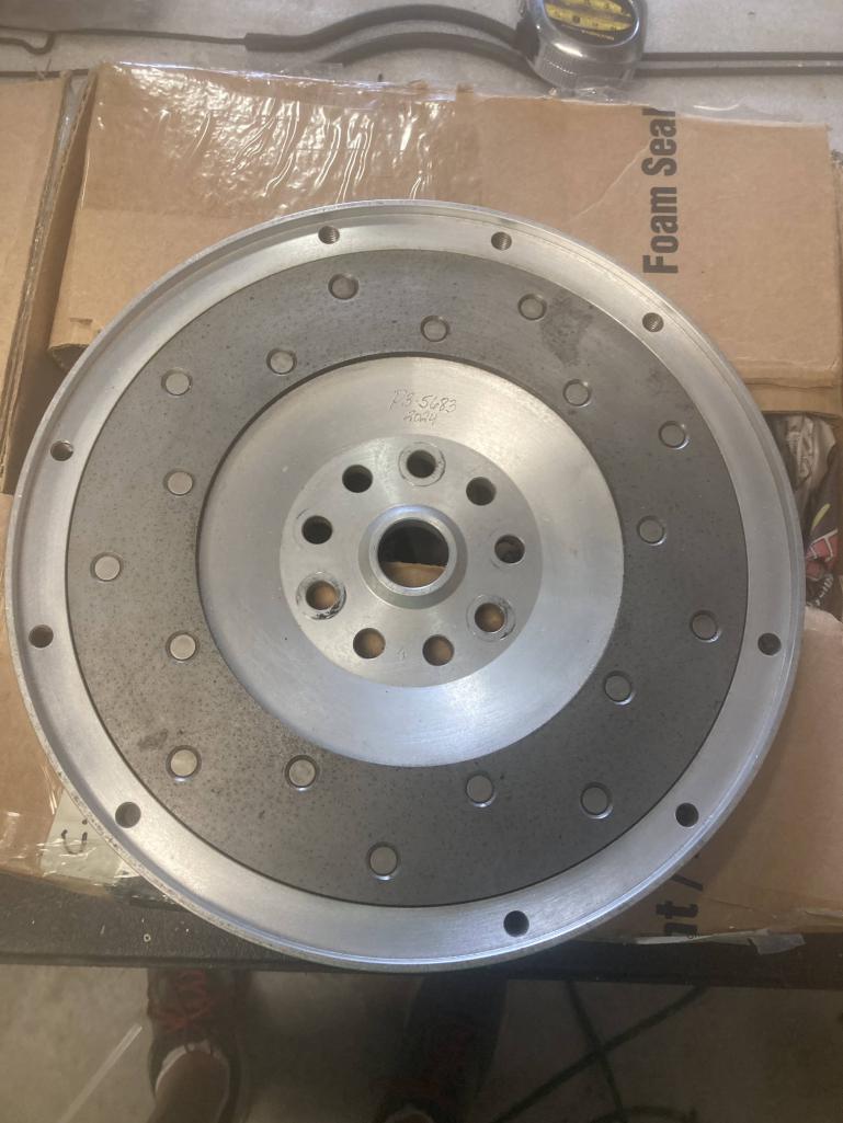

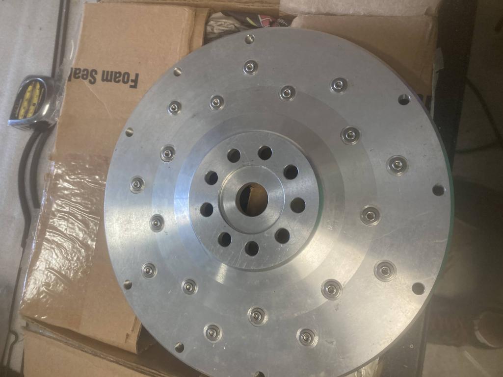

sixaddict
post Mar 23 2024, 12:27 PM
Posts: 1,067
Joined: 22-January 09
From: Panama City Beach, FL
Member No.: 9,961
Chris et Al……
Appreciate input.
Posting pics since it looks so much different than what has been posted.
Any idea what this is worth ……based on street useage probably going to sell.
Thanks again

Charles Freeborn

QUOTE(sixaddict @ Mar 23 2024, 11:27 AM) *
Chris et Al……
Appreciate input.
Thanks again
Interesting. I have no idea on value, especially not knowing if it also requires matching / dedicated pressure plate, disc, TO brg and starter ring gear... but interesting nonetheless...

I've seen a crap ton of multipiece flywheels...
Never seen a RIVETED wear surface.
That's one of the reasons for multipiece, you can replace the wear surface.
Also never seen one without a ring gear on it.
Value ?????
Accurate application from the maker would be only way to know IMO.

Is it an aluminum flywheel? Fidanza makes ones that look like that.
1970 and later 911 flywheels have the separate ring gear, so this looks like one of those.

QUOTE(Charles Freeborn @ Mar 27 2024, 10:46 AM) *
Chris et Al……
Appreciate input.
Thanks again
Looks like the AASCO unit that I've been running on the 2.7/6 and it's just fine for street or track--has separate ring gear, I use the "sport" Sachs pressure plate. Flywheel retails around $600....
