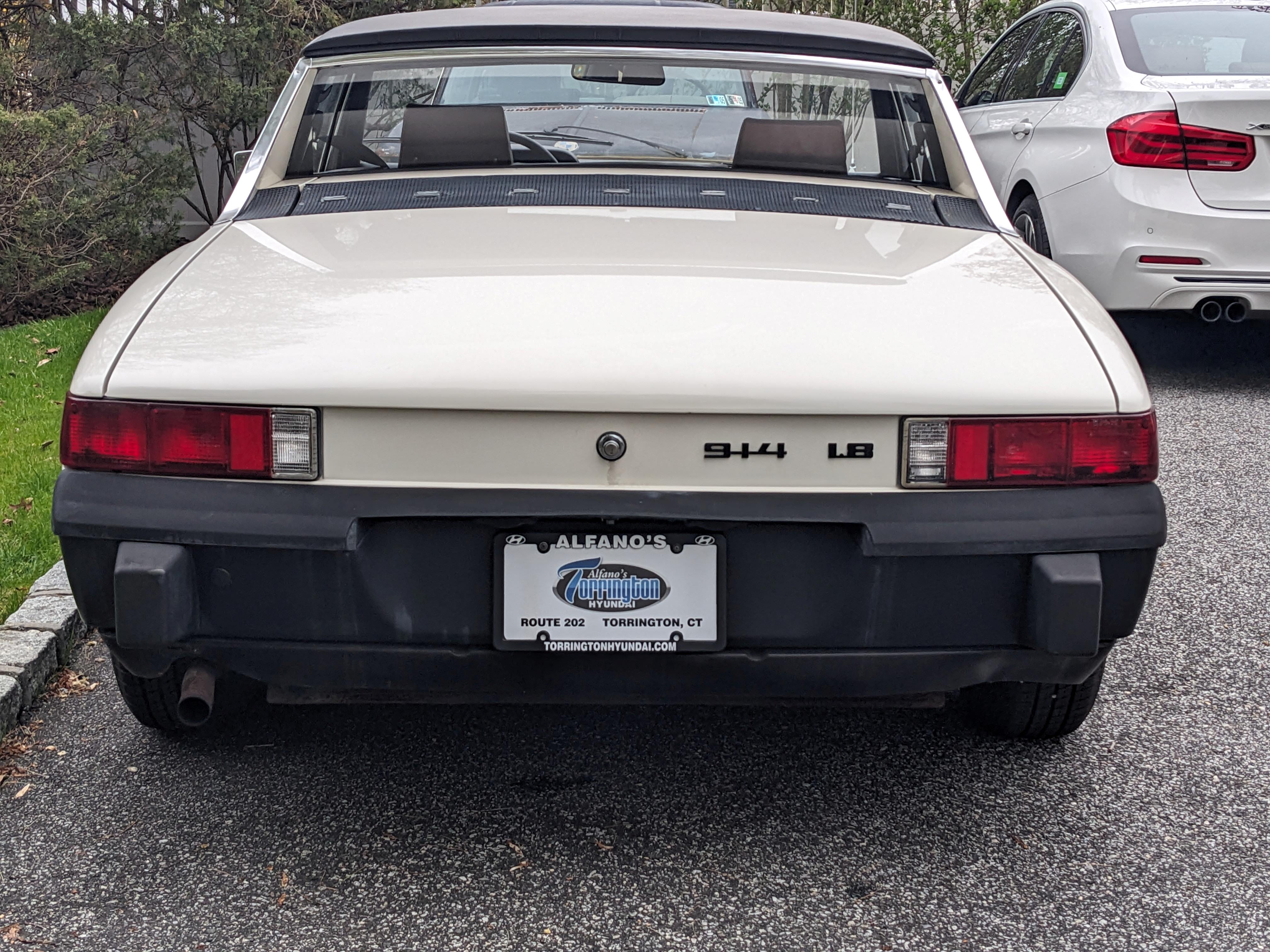

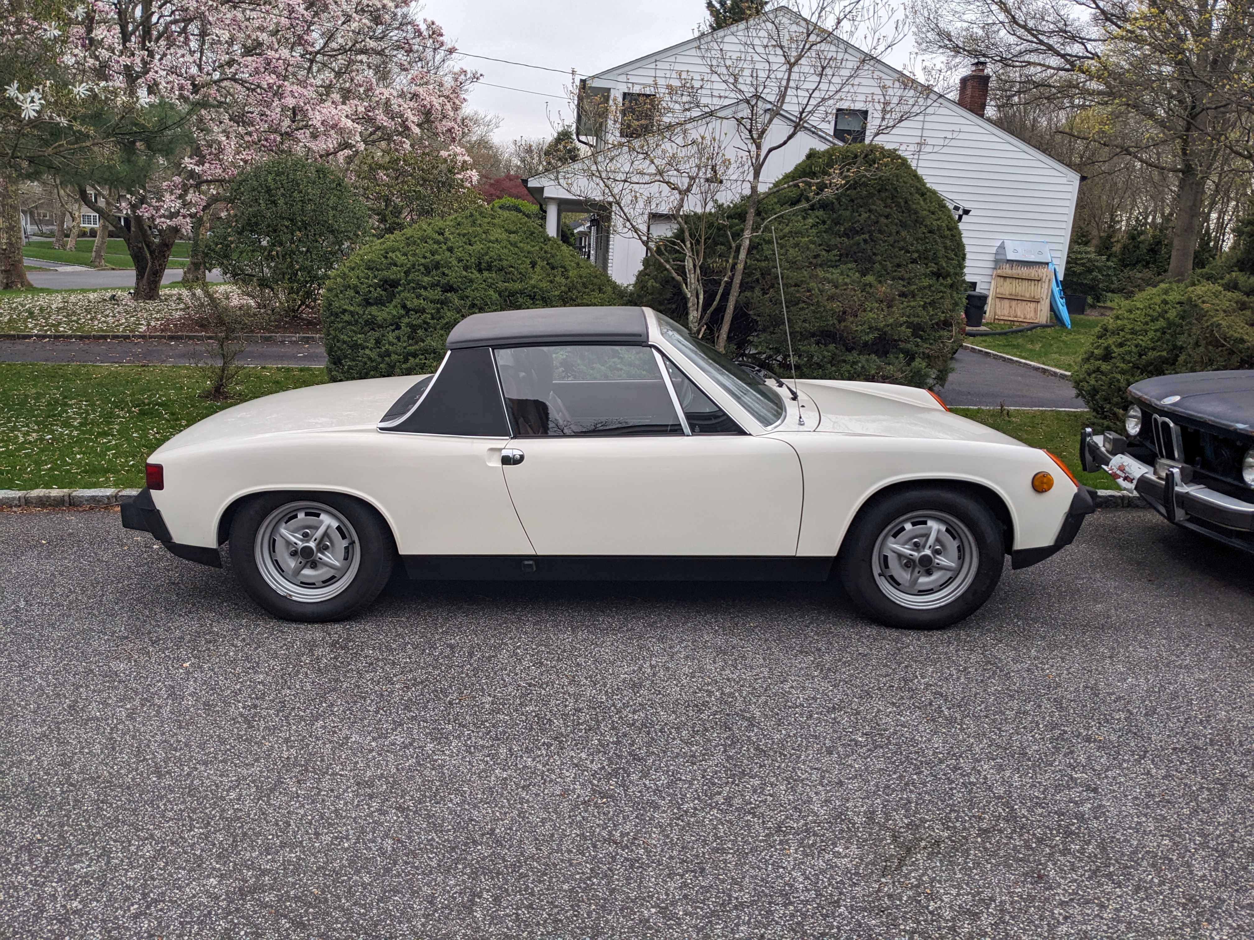

Got my new-to-me 1974 on Friday. One of the issues I knew about was that the car sits a little [too] low in the rear. I don't have plates yet, so I could only drive up and down my street a couple of times, but I don't hear any or feel anything funny from the rear and the ride is pretty nice.
Any ideas on where to start to level this or problems I should be looking at regarding the rear end sag?

Most likely you need new rear springs.

(IMG:style_emoticons/default/welcome.png) maybe lower the front torsion bars. (IMG:style_emoticons/default/thisthreadisworthlesswithoutpics.gif)

It is a gray area. Originally 914's were a little high in the front from the factory to meet headlight spec's. On the other side your rear springs are close to shot IF they have not been replaced.

From the factory the fronts were adjusted high so the headlights would meet the minimum height requirements at the time, AND your rears are probably worn out.
But, you can adjust the front very easily. Under the car there is an adjustment screw on the base of the A Arm that sets ride height. Many will adjust it until the A-Arm is horizontal under the weight of the car. Be aware that you can over adjust and the car will come off the screw and the front wheel will fully collapse into the fender. Its obvious, but still something to be aware of.

Two things:
As stated above, front looks high. Easily adjusted.
Rear looks low. Probably springs. Every 914 I’ve ever purchased had worn out springs. Easy to fix.

look under the rear and see if you have an adjustable spring plate first, you will see notches for setting the plate at different heights. This is on all koni and bilstein shocks which will be red or yellow.
If you have the standard gray boge shocks with affixed spring plate, the rear springs have sagged and need to be replaced with the stock set. This is typical for all 914s after years of age

Upon seeing the pics I'd say drop the front and get an alignment.

Thanks - I'm not looking to make a stance car. I have never been a fan of lowered or raised vehicles. They rarely look good to me.
I'm trying to figure out why the back end is so low - right now the concensus is worn out springs and possibly adjustable shocks adjusted too low.

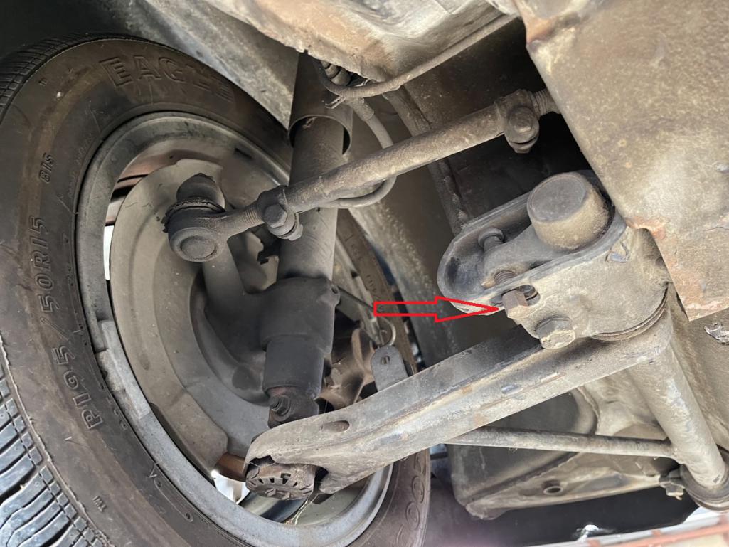

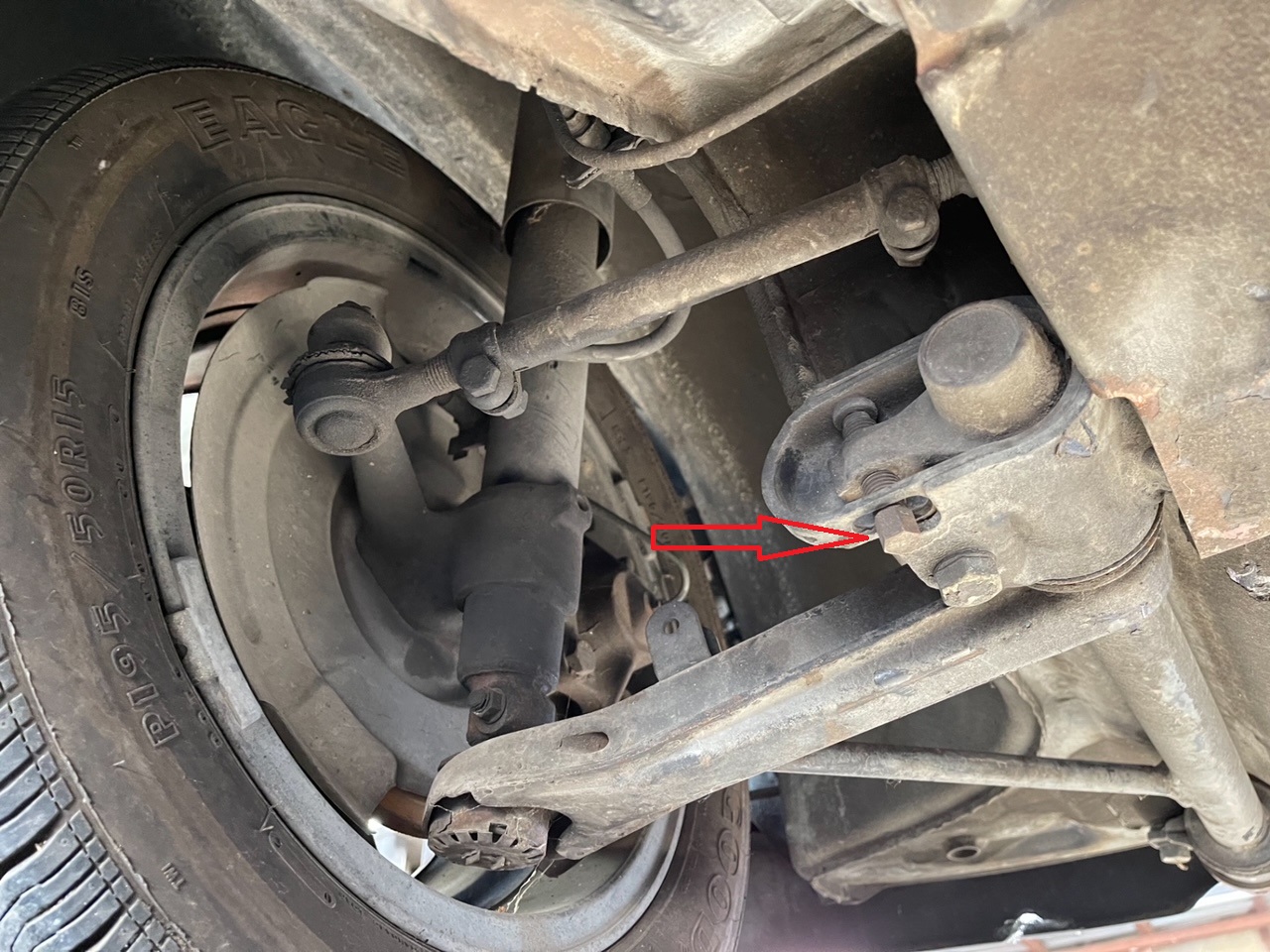

Here is a pic showing the adjustment for the front suspension. Nice car

The back does not look that low to me, it is the front that is so high
