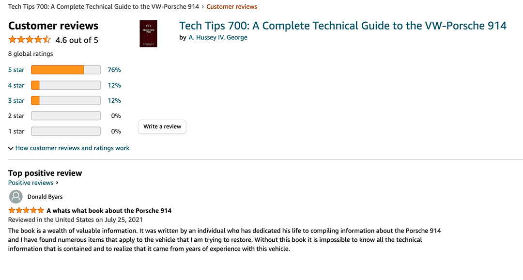

A great book to have is George Hussey’s Tech Tips 700
You can get it from Amazon. A good book to own

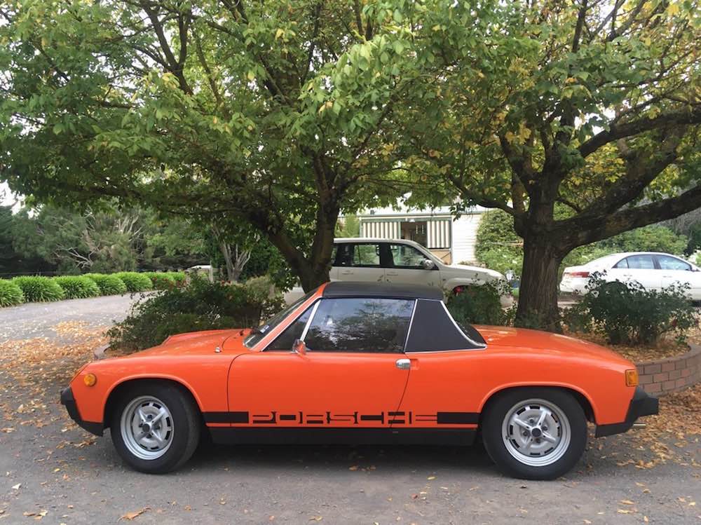

here is mine back in 89. a 74 L jet identical to yours.
when it was still on original boges with single fixed spring perch.
nose up as per yours.
how it is now (2022).
boges replaced with bilsteins. has a number of perches for adjustment of rear spring position. bils do not match spring perch position exactly of original boges.
one perch is a little higher and one a little lower.
we went for the slightly higher. still running original springs.
after rear spring position was set we levelled the car out by adjusting the front torsion bar settings to bring the nose down.
it could be set up lower by choosing the next spring perch on the rear and bringing the nose down level with that. but i am happy with this set up.
