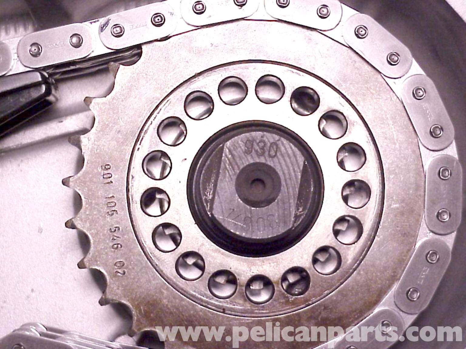

Remember 911 cam timing is set via index pin that has a multitude of possible “wrong” positions.
Doesn’t have to be out 180.
It sounds like there are still plenty of other assumptions that need to be verified and hopefully it isn’t cam timing.Attached Image
