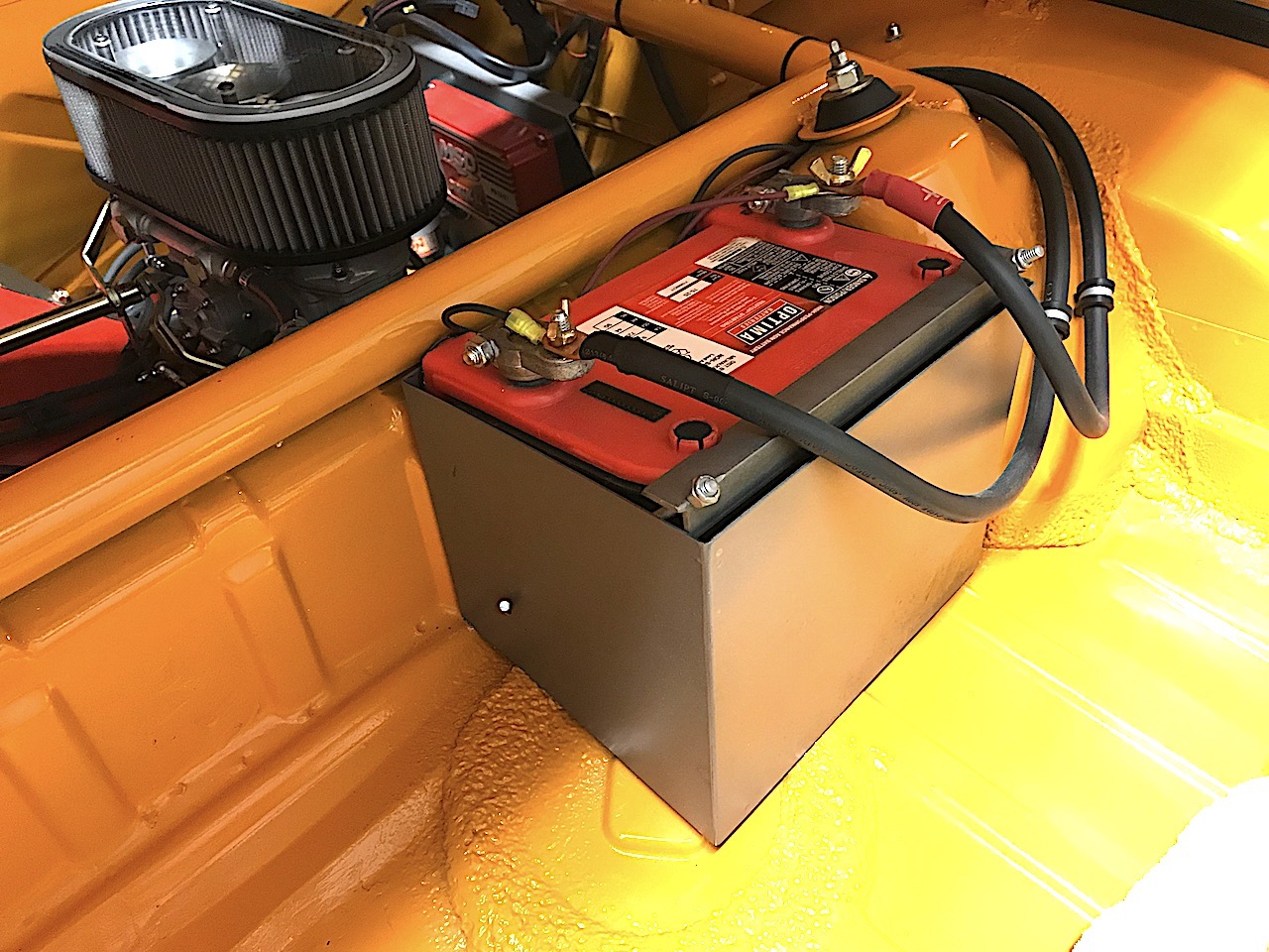

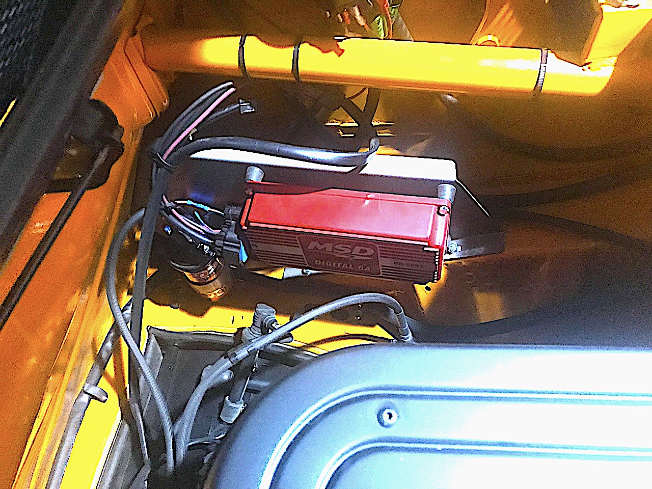

I moved the battery to the trunk. Then fabricated a panel to hold both the MSD box and coil. Did have to get a longer coil wire. It does open up the engine compartment a lot. MarkAttached Image Attached Image

I left the battery in the stock location and mounted the MSD box where you have the battery.
Somewhere there is a load (short) in the wiring, as far as I know there should be infinite ohms between the + and - battery cables, when disconnected of course.
