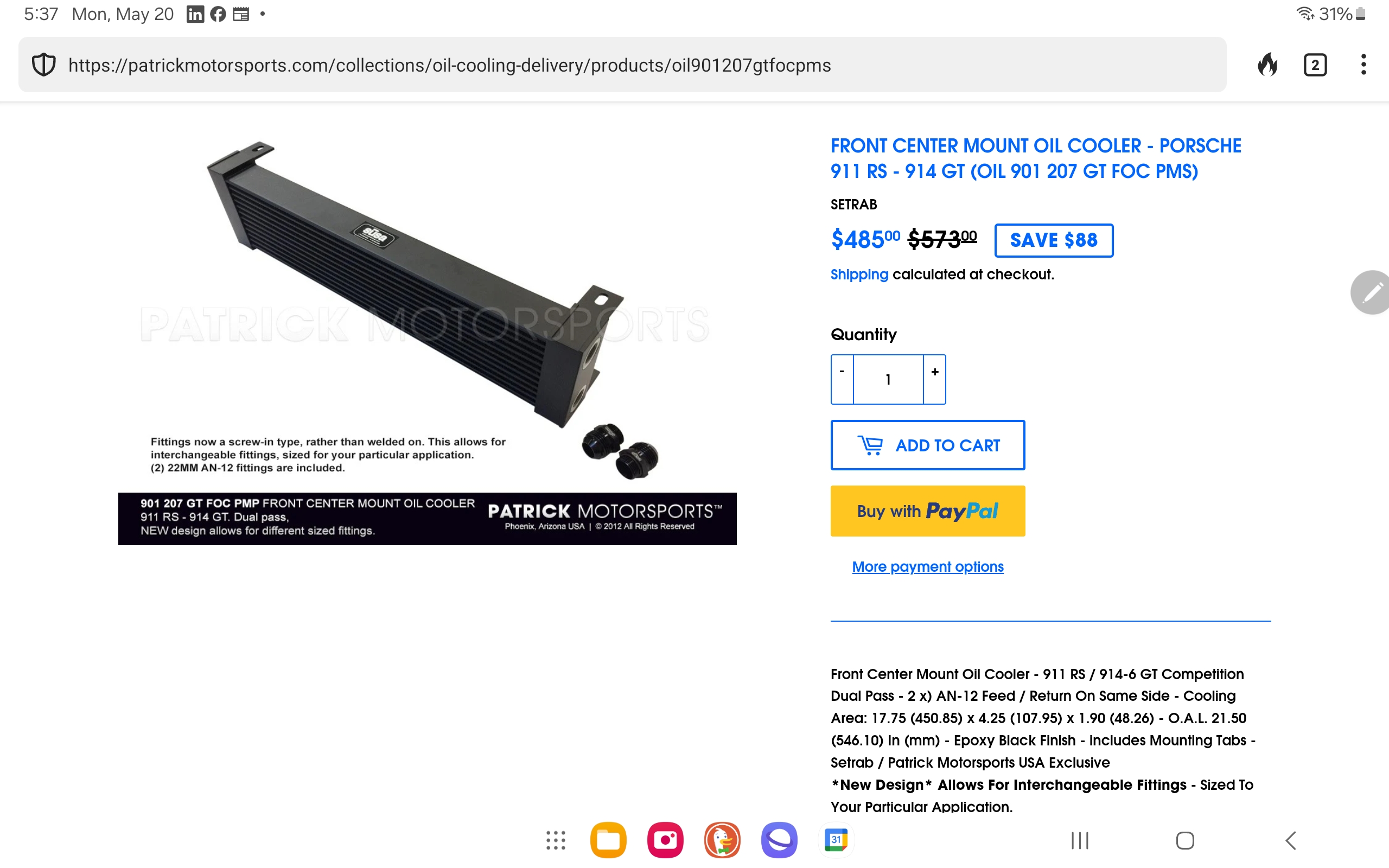

I run this setrab from Patrick Motorsport on my carbed 3.0. My engine also has a new factory engine oil cooler. On a 108* day at the track the oil temp was 230* the smaller one might be ok with it's 96 sq inches. Mines a little more than 75 sq inches. Put a thermostatically controlled fan on either cooler you choose for driving in traffic.
