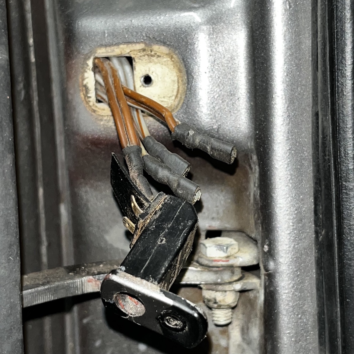

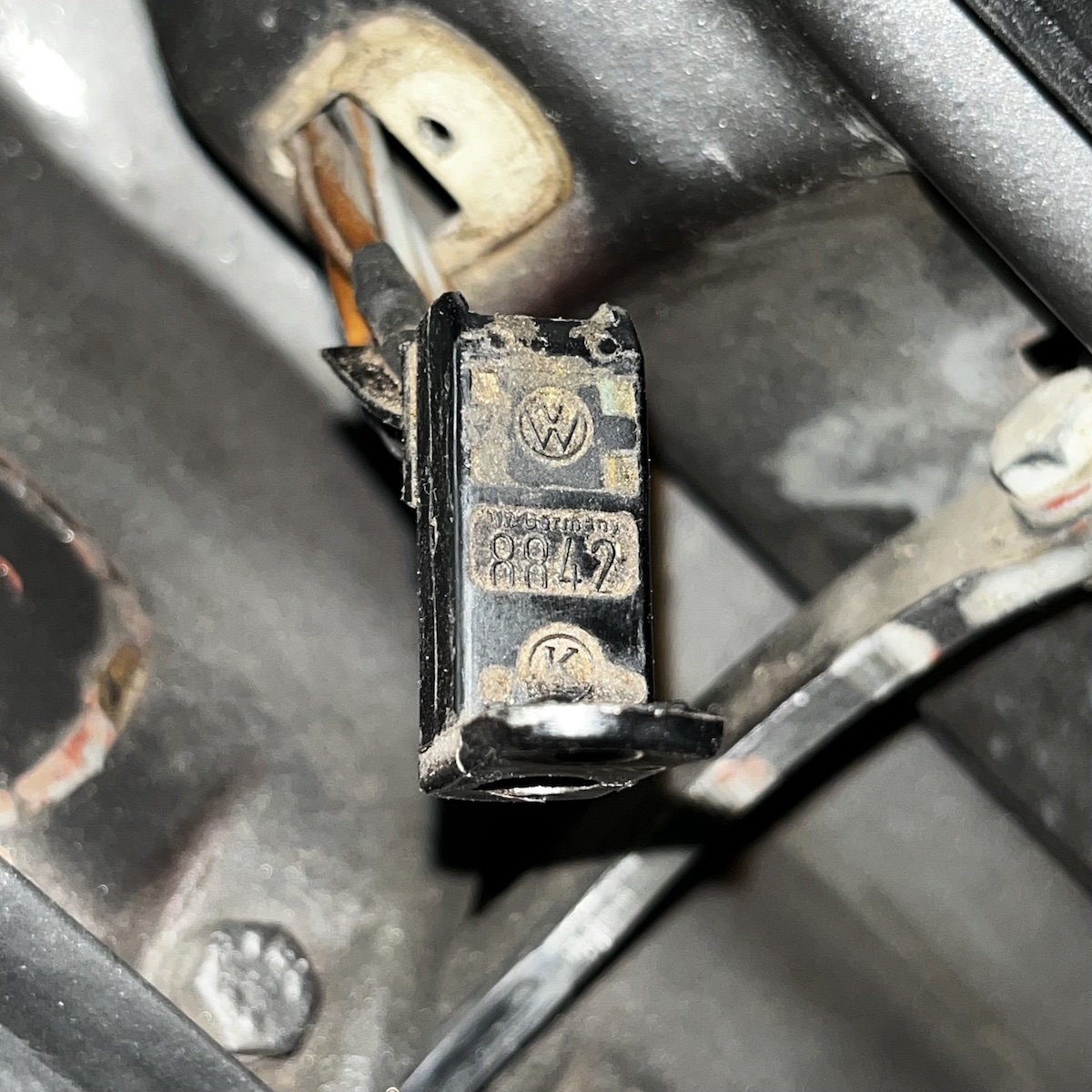

I bought two different kinds of door contact switches, based on what is listed in the PET catalogue. Then when I pulled the broken switch out of my door jamb, it was of the 4-pole variety, which is not listed in the PET at all.
I have not been able to find this part anywhere online, not even a proper part number other than the "8842 K" that is molded into the plastic.
Does anyone sell these?
Or is there a good way of wiring a replacement switch that preserves the buzzer circuit? Or will I just have to disconnect that and wire with the later year 2-pole + ground switch?

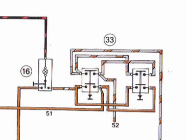

This is the relevant section of the wiring diagram (1972), in case anyone is wondering:
Any help would be much appreciated!

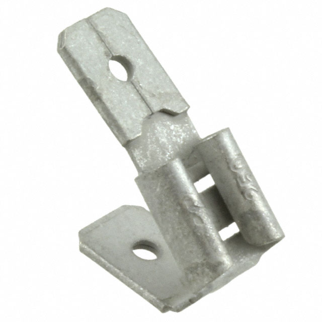

Something like this piggyback work to convert without changing the wiring?
(or are the switch connectors the smaller variety - i can't remember)
https://www.digikey.com/en/products/detail/...EcaAtbEEALw_wcB

QUOTE(FlacaProductions @ May 23 2024, 02:47 PM) *
Unfortunately it's not that simple. The original switch is DPST and closes two separate circuits: (1) it grounds the cabin light, and (2) it completes the circuit from the key-in ignition switch to the buzzer and seatbelt light... if you just piggyback the buzzer circuit on the cabin light circuit, the buzzer will sound every time the door is open, even without a key in the ignition... (IMG:style_emoticons/default/headbang.gif)

Thanks. I found a pair on ebay. The lack of a part reference is really strange - it's clearly stamped as VW part, but I can't find it described anywhere and there seems to be no Porsche part number attached to it either, or it would be correctly listed in the PET.

113 947 561 E
Not easy to find as most parts houses have that part number shown with the 2 pole version but...
Here you go
https://www.volkswagen-classic-parts.com/ca...11-412&ct=2
If you have used ones though they are pretty easy to dissemble and not a complicated part or prone to breaking other than the internal spring rusting out.

1970-73 = 4-pole door switches
1974-76 = 2-pole door switches
