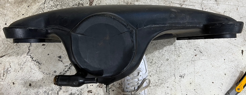

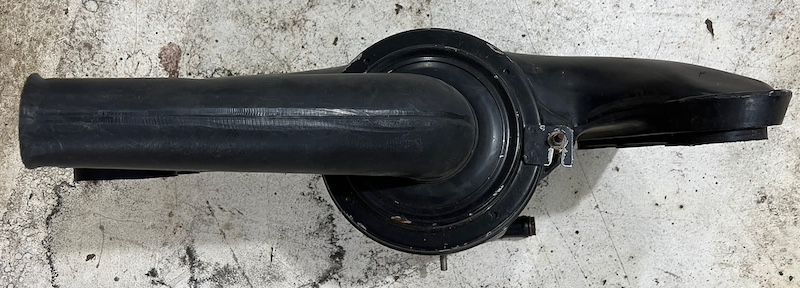

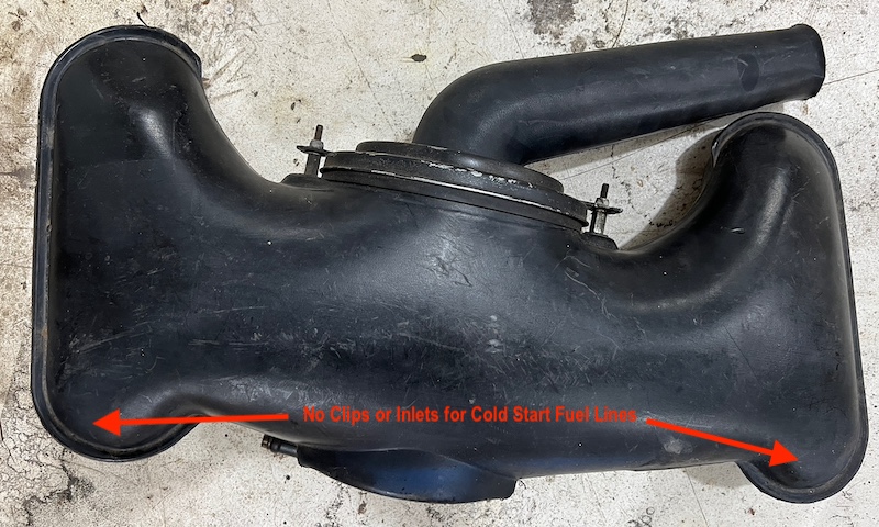

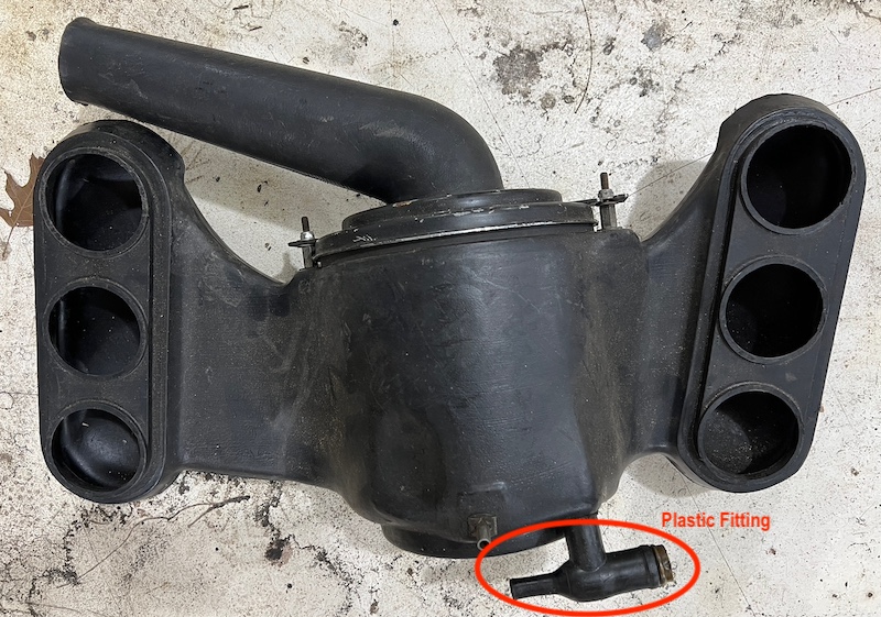

Is this air cleaner correct for 1970 914-6? Am I missing any components?
I went through the other air cleaner threads I could find. A couple things about our plastic one that seems curious when I compare it to the photos I'm finding of others identified as 914-6:
  1. No clips or inlets for cold start fuel lines
  2. Large to small outlet plastic fitting
Thanks.
P.S. I am unclear about the fittings. My best guess is the small single port metal one is a water drain valve and big plastic one with two outlets is oil breather? Not sure how to connect either.
