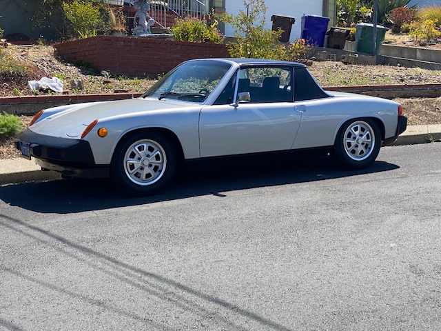

1975 1.8 fully stock California car. I just put in turbo tie rods as well as a new trailing arm bushing, so alignment was needed. Not easy to find shops that do alignment on these cars, but a local member recommended a racing shop about 30 miles away and I took it there. They asked if I wanted it aligned for "street driving" and I confirmed that was the case. Let me emphasize that this is a stock California car in well maintained condition (a previous owner had it for 44 years and really took care of it) and I'm a really mild street driver. It is rare I'll use every one of the 76hp this can put out (IMG:style_emoticons/default/biggrin.gif) . Street driving only, no AX, no racing. It drove fine getting to the shop, no pulling, no vibration, etc. They told me it drove "much better" after alignment, and that the alignment was way off, especially in the rear. I couldn't tell any difference in how it drove pre and post alignment, but remember I drive for fun and I'm not by any means an aggressive driver. I brought a bunch of 914Rubber sourced shims with me, but they needed none of them and in fact returned to me a bunch of shims that were already on the car. I didn't notice it at the time I got the car back, but the next day I could see the rear wheel stance was significantly different, with (in my opinion) a lot of camber. Prior to the alignment it had maybe 1-2 degrees of camber. Again, I can't tell any difference in how the car drives, but maybe I could if I really pushed it? My question is, is this correct? I've really not seen this amount of camber on other members cars. Also, I kind of hate the rear tires leaning inward look. Not sure if I should take it back and ask for this to be "corrected." Other options are to live with it, or take it to another shop. Any thoughts? Is this amount of camber correct?
Superhawk996
post Jul 5 2024, 08:25 AM
Posts: 8,141
Joined: 25-August 18
From: Woods of N. Idaho
Member No.: 22,428
What the alignment sheet say they set it to? The spec is -0.5 degrees +/- 20 minutes. So -1 degree is max camber
By the picture alone, it looks like too much negative camber.
Not a matter of opinion, or how it “looks”. The shop should have set it to spec and have the numbers to prove it.

I'm gonna guess -2 degrees+
Be fine for an autocross go cart.
Rip up tires on a streetcar.

To my eye it looks like more than negative two degrees.
My bet is the jokers pulled all the shims and are too lazy to use the shims to set the camber properly; takes too much time.

Car seems lowered although difficult to say.
Lowered cars by geometry creates negative carber if I recall.

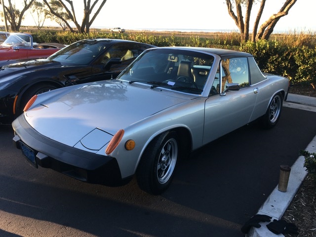

This is a picture of your car when I sold it to you. It looks to me like it is too much now.
Nice looking car.

What does the side view look like? Does the car sit level, nose high, tail low? How does it drive post alignment? Twitchy? Looks to have plenty of tire to well lip clearance. Run the correct cold tire pressure F&R. What size are the tires? Nice looking car.

It looks low (which adds negative camber) and improperly set (i.e. not enough shims in the outer mounting point).
So don't just go by the camber spec on the alignment report but also measure the ride height.

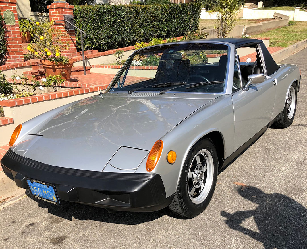

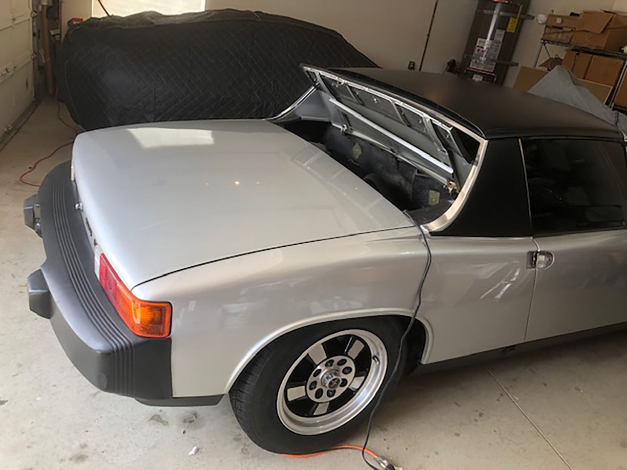

@914_teener Interesting that you know the car and the previous owner. Other than a large binder of records, I have no backstory on the car. As he pointed out earlier, I bought it from Bob Burton, who essentially was just a middle man that was flipping it for a profit and didn't have much of the car's backstory. Care to share what you know? PM me.
To answer a few questions:
No, it is not lowered. The car is bone stock, other than the turbo tie rods. I did replace the Rivieras it came with, but the Fuchs were an option so I consider them stock. Trailing arms appear original to the car. I did the bushing on the right side, but not the left. The work was done a week before the alignment, and the alignment was done was last week. This is all recent work. It drives fine, and is not twitchy. I can't tell any difference between how it drives pre and post alignment. The ride height is equal between the front and rear, at least by eye. There is no indication that the pivot is binding on the bushing. In any case, I only did the one side and this is wonky bilaterally. It was fine when I drove it into the alignment shop, and didn't have any obvious excessive camber. I did not change the springs. I can check to see if there are any shims in place. I'll check the specs on the sheet I was given as soon as I can get back to the car, which is over at my second garage. I'll report back tomorrow. The consensus seems to confirm my feeling that this just isn't set correctly. I'm pretty sure I'm just going to bring it back to the shop that did the alignment and have them fix their error. That seems the logical thing to do, although I'm game to try it myself. They deserve a chance to make it right. That's what I would want someone to do if I did something incorrectly.
Two pictures of what it looked like right before I took it to the alignment shop. This was after I finished the last round of work (new calipers, soft lines, turbo tie rods, MC, trailing arm bushing, changing to the Fuchs). To my eye the car looks level. Not a good angle to see rear wheel camber, but I can assure you the wheels were not leaning in.

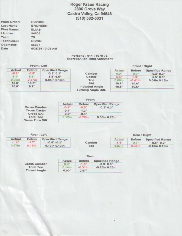

OK, here's the sheet from the shop:
Superhawk996
post Jul 6 2024, 06:03 PM
Posts: 8,141
Member No.: 22,428
QUOTE(fiacra @ Jul 6 2024, 05:03 PM) *
Gotta love it. So they made rear camber worse and out of spec on both sides instead of just one side. (IMG:style_emoticons/default/chair.gif) Left front camber is also jacked and out of spec. (IMG:style_emoticons/default/headbang.gif)
So now the dilemma: return it to the folks that are incompetent and hope they somehow improved since your last visit or find an old school alignment shop that is competent.
I’ve lived this scenario multiple times in my life. Personally I’ve never had success trying to turn incompetent people around. Your best bet is to find a small shop, and talk to the tech beforehand so they understand the scope of the work (i.e. trial and error shims to set rear camber) and the specs (-0.5 degrees +/- 0.3 degrees)
Note: their specs for rear toe are also wrong. Rear toe should never be allowed to be toe out. So someone set up the specs wrong. Your car is fine (toe in) but I don’t like that they have set up the machine to allow toe out to be “in spec”.

My advice...don't go to the same shop and yes...it appears they did it wrong. The cars stock didn't have much rake in the ride height. The torsions can be adjusted if you don't like that...plenty of threads on it and very easy to do.
Good luck...but still my advice is learn to do it yourself.
