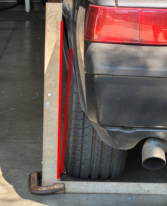

Sorry it took so long to post this.

QUOTE(MartyYeoman @ Jul 20 2024, 11:11 AM) *
Back of the napkin trig calcs....just by quessing aprox. -5.7 degrees.
Thanks Marty! Looks pretty much the same as mine. I did speak to the shop and initially got a wall of defensiveness, but he calmed down after a while and offered to recheck it last week. In the meantime I took it to our local expert, Bill Eason, who gave it a pretty thorough checking over and a hard drive and basically advised to drive it for a while and see how the tires wear. He feels the back end feels soft when changing lanes, but he attributes that to the springs rather than the alignment. Otherwise the car handles well. I decided not to go back to the shop (it's a long drive and I don't need to deal with anybody's attitude), but I do feel like I'd like the rear camber to be closer to factory spec rather than what the shop felt was going to give the best handling. I don't push the car nearly as hard as Bill did when he drove it, and I kind of hate that "knock knees" look. I'm wondering if I put the smallest shim (2mm) back in on both sides if that would be a bit better. This is all new stuff to me, so I'm doing a bit more research and trying to figure out if my thinking is too simplistic.

QUOTE(914_teener @ Jul 20 2024, 01:22 PM) *
Copy that.
tan^-1 or arctan(2"/20") = 5.71 degrees.
(IMG:style_emoticons/default/beer3.gif) (IMG:style_emoticons/default/beer3.gif) (IMG:style_emoticons/default/beer3.gif)

QUOTE(fiacra @ Jul 20 2024, 02:37 PM) *
Probably a good decision. And I will always start with numbers first and then feelings (about most things in life). Almost 6° (if Marty is right) is insane, and 3° is way too much for driving on the street. I would advise aiming for 0.5°, even on both sides, and with proper toe. Whatever shims it takes to do that are the correct shims.

QUOTE(bkrantz @ Jul 20 2024, 10:09 PM) *
(IMG:style_emoticons/default/agree.gif) (IMG:style_emoticons/default/agree.gif) (IMG:style_emoticons/default/agree.gif)
I don’t think you can even get to -6 degrees of camber without lowering and/or mods to the consoles. Camber need to be measured off the rim. Measuring camber off the tire will be misleading.
Take Chris up on the offer to set you up with his alignment guy.

The post stating -5.7 degrees was SATIRE!
914_teener was bull shitting... (IMG:style_emoticons/default/av-943.gif)
Windforfun had to add a math comment that further led astray. (IMG:style_emoticons/default/stirthepot.gif)
MartyYeoman had posted his actual numbers long before the picture at -2.3 and -2.5
Then he posted the pics...
I agree! The ONLY route I'd suggest now (and on post 35) is to bug Chris. (IMG:style_emoticons/default/devil.gif)

QUOTE(technicalninja @ Jul 21 2024, 12:29 PM) *
Now, I LIKE my camber and will accept slightly lower tire life to be a tiny bit on the "fat" side.
For a 914 that was street based I'd be hunting -.75 to -1.
OK, I plead drug-induced stupidity (had knee surgery last week).
Yup, -2° for the street is insane.
And -.75 to -1° might be the sweet spot for people willing to trade tire wear for a little extra cornering fun.
