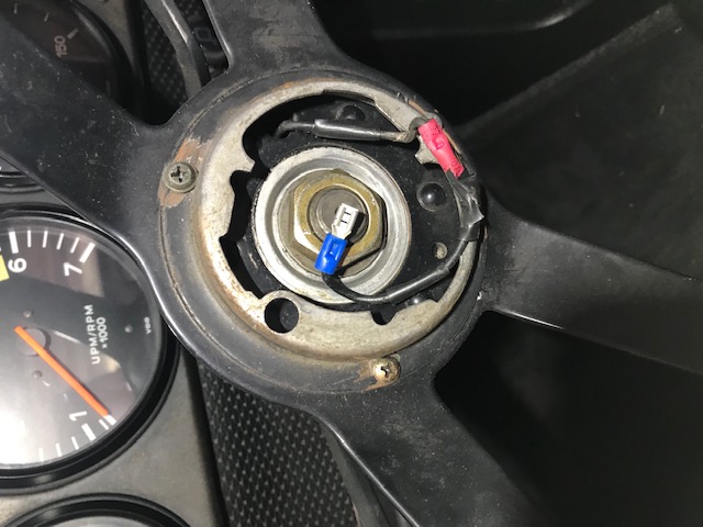

I have taken the center off the steering wheel and there doesn’t seem to be any thing for the horn. No plunger, just a wire. Looking for an illustration of some sort in order to get parts etc. I will be removing the horn itself to see if it is functional as well. Not much out there in any of the manuals referencing these. Any help on this is appreciated. Thanks.

mepstein On 72-76, Just a wire that attaches from the the t... Jul 16 2024, 11:16 AM
Babydogforme@me.com This is what I’ve got! Jul 16 2024, 05:11 PM
Babydogforme@me.com
Pulled the horn and... Jul 22 2024, 12:52 PM
76-914 Ground that blue spade terminal with the ignition ... Jul 22 2024, 02:26 PM
Babydogforme@me.com Connected OHM meter for continuity on the black/ye... Jul 23 2024, 01:01 PM![]() ![]() |
