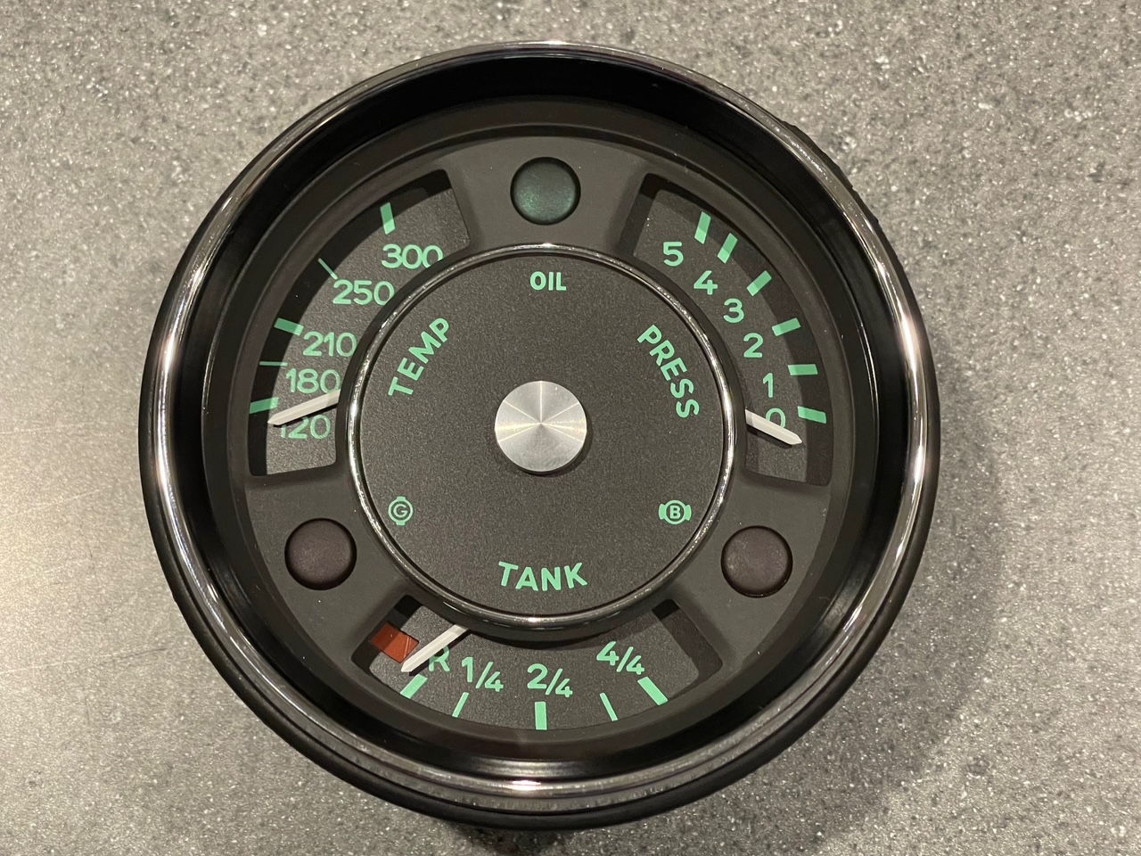

I’ve been in contact with him. He was kind enough to offer sending the speedo back to him so that he could open it up to determine the issue (since he was the person who restored it).
Before sending it back, I’m trying to eliminate all potential external issues. It’s odd bc on some days it works fine, but in other days it takes about 20-30 minutes to start working … like it needs to warm up or something. Very odd.
