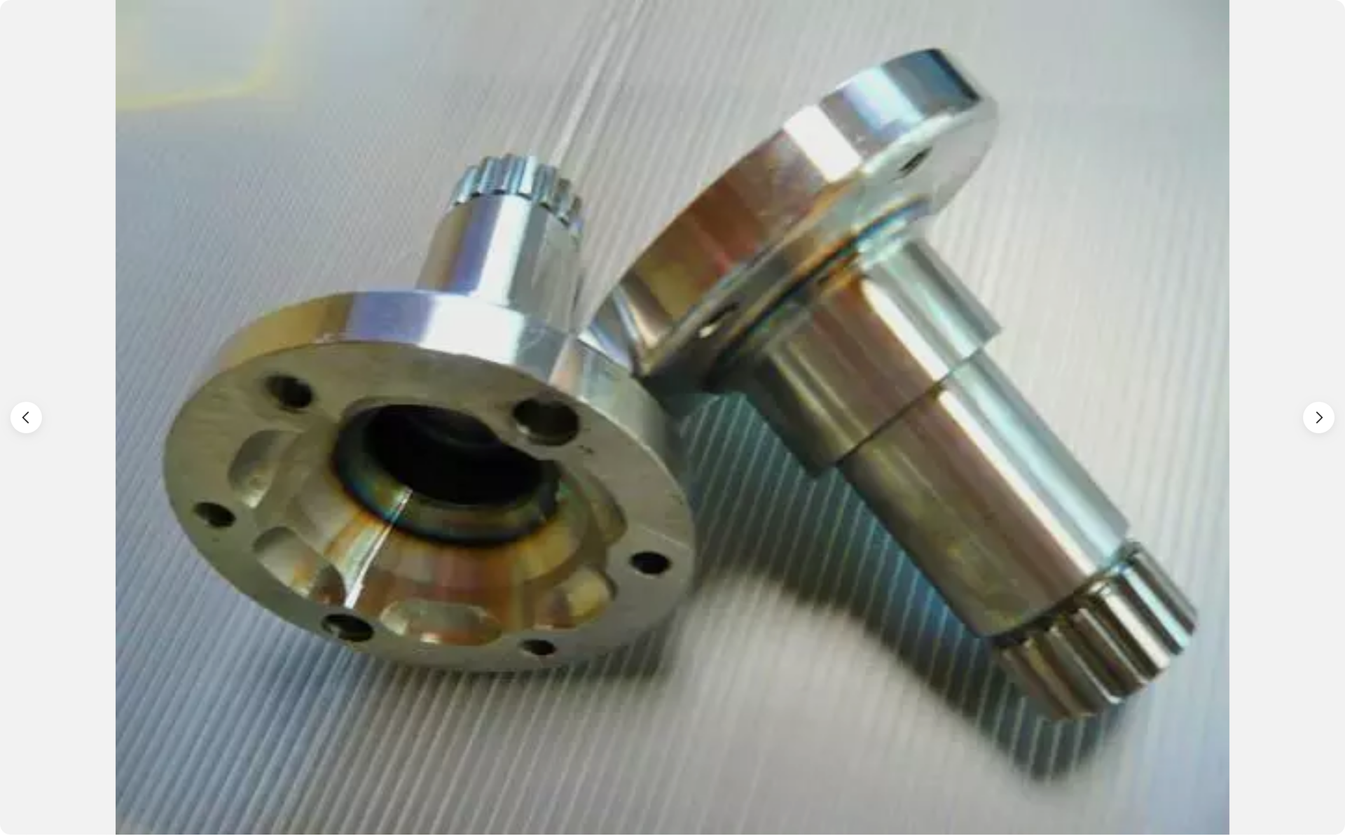

Lot thicker and longer shaft.

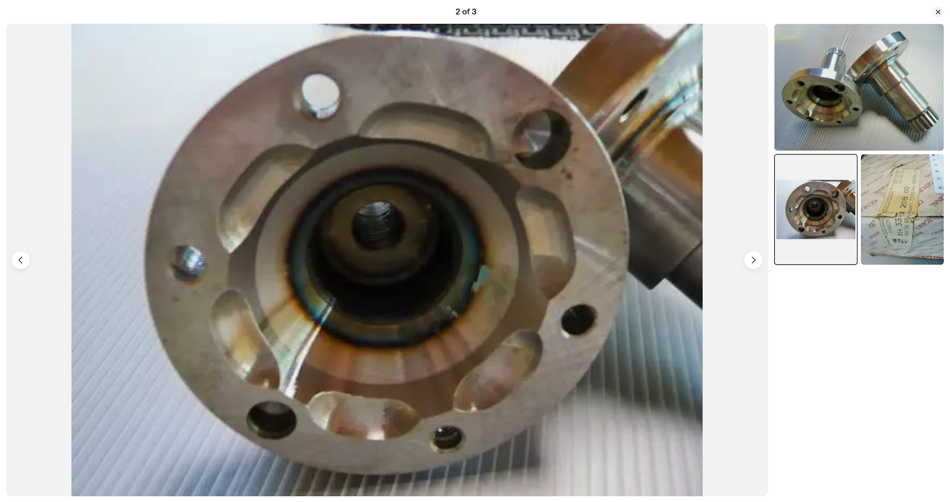

Saw these, was wondering how these may hold up. I believe the originals were forged. These appear to be welded.

QUOTE(Mikey914 @ Aug 9 2024, 12:48 PM) *
Not welded that is heat treat zone from induction hardening

That color is from burnishing not welding

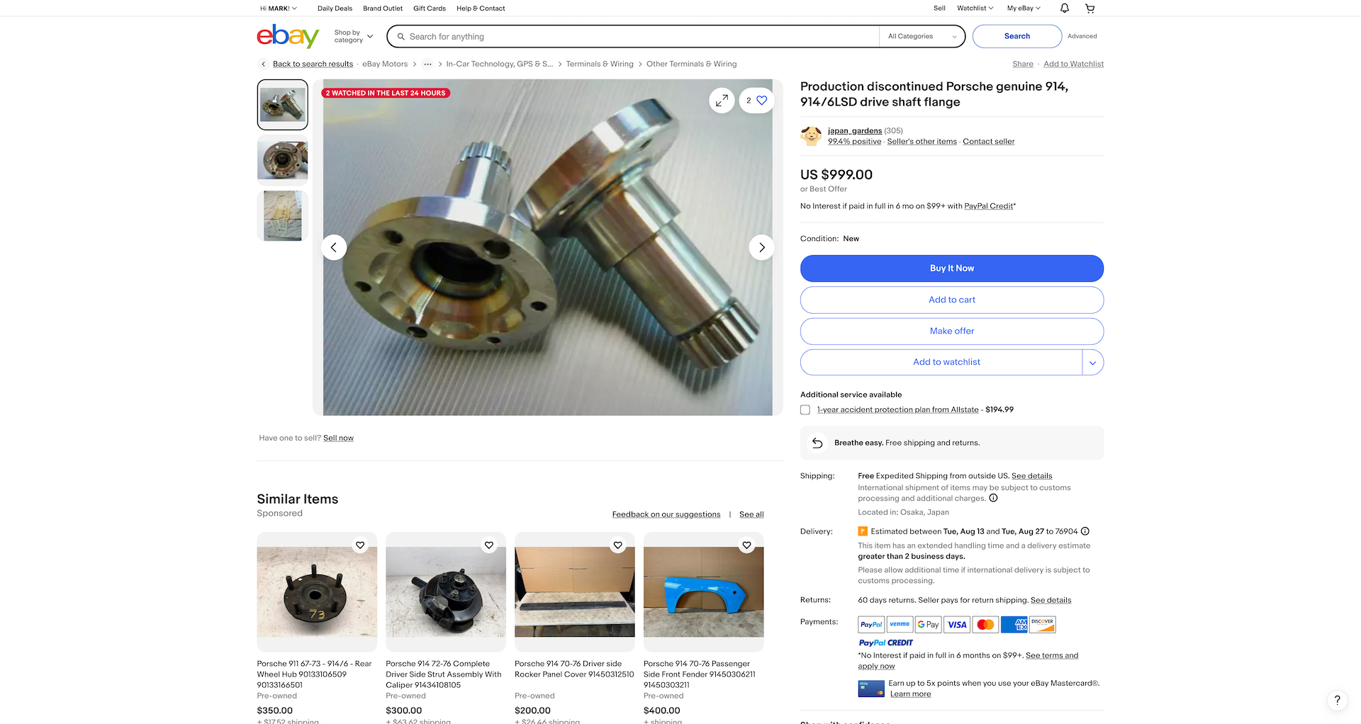

The ad reads like these were once made by Porsche, right? I’ve never seen a Porsche stub like this. Looks aftermarket to me. Maybe I’m missing something since I’m not looking at the actual ebay description.

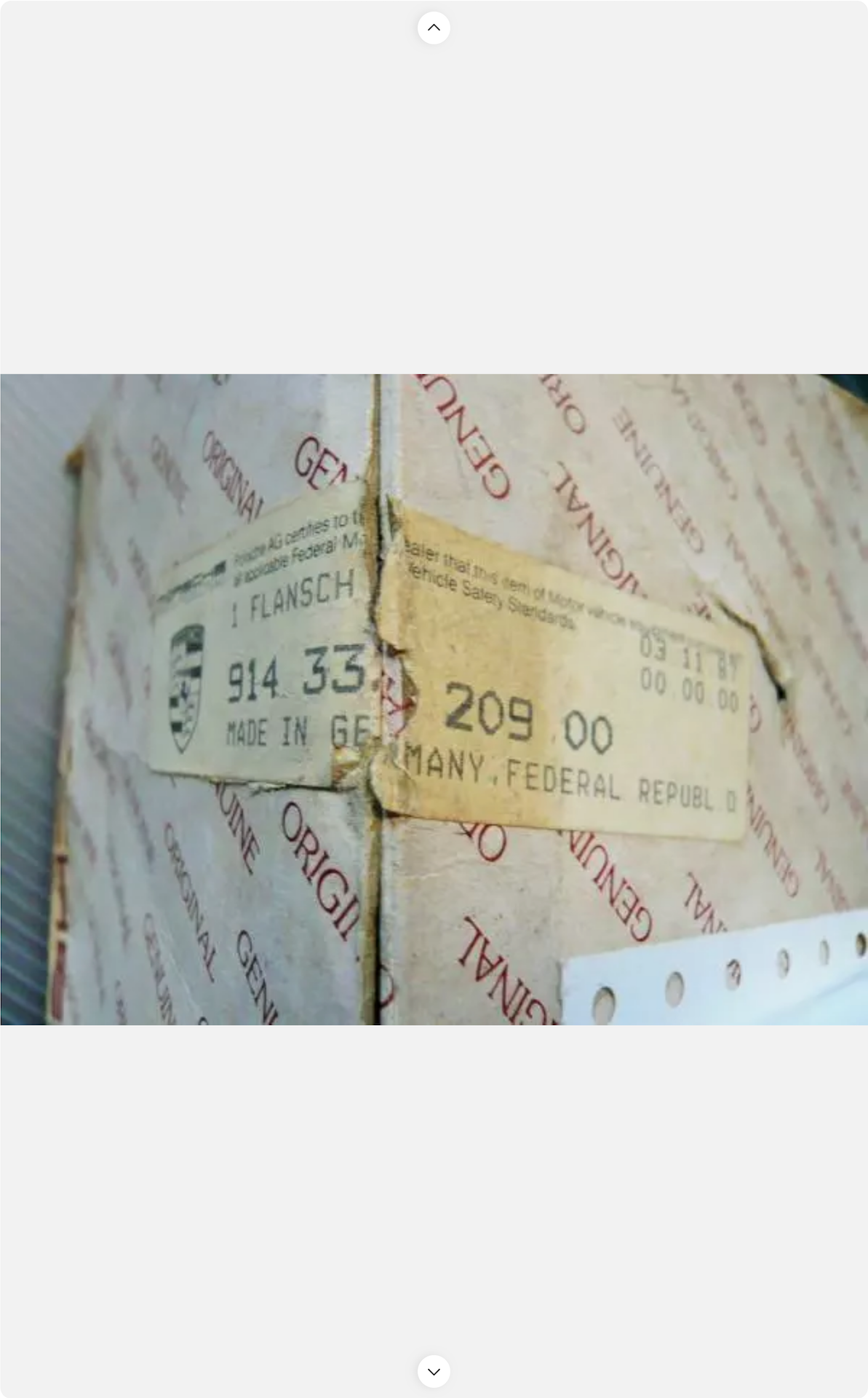

Added picture of box with part number.

QUOTE(mepstein @ Aug 9 2024, 06:18 PM) *
That’s because we are used to seeing them rust covered. Uhmm, I mean with patina. (IMG:style_emoticons/default/happy11.gif)
Like you, I’m a bit surprised to see the induction hardening and wondered about the part. I would have thought they would be oven treated which results in a black / blue oxidation over the entire part. But it is plausible that it was induction hardened, Germany used to be a manufacturing powerhouse. Or, could be a part produced later for service after induction hardening became more common place and better suited to small production runs vs oven heat treat.
It is interesting to see one untouched like this. (IMG:style_emoticons/default/beerchug.gif)

box says one flange.

aftermarket product, original box…
original flanges feature at least a part number besides the fact that these are typically made from cast iron that have been turned to spec…

I would bet money on aftermarket.
I’m not saying it’s a Martin Bott product but it looks nothing like a Porsche part.
Seller might have bought it in the Porsche boxes and been sold a story along with the part.

As far as I know, the 914/6 transmissions were built using the internal parts from the 2.2 liter 911 transmission. 914/6 gear ratios are the same as the 2.2 911.
I went on a factory tour in 1971 and saw a 914/6 on the assembly line and also saw a 914/6 engine being assembled. Did not notice any 914s on the transmission line.
That being said, the only difference between flanges for 2.2 with factory LSD and stock is the length. The LSD is about 15mm longer.
The LSD flanges are rare and valuable so this may be a reproduction being offered, perhaps by Porsche. I wouldn't touch it unless the seller could provide dimensions. The box shows a sales date 03.11.97 (3Nov1997) and does not belong to the flanges.

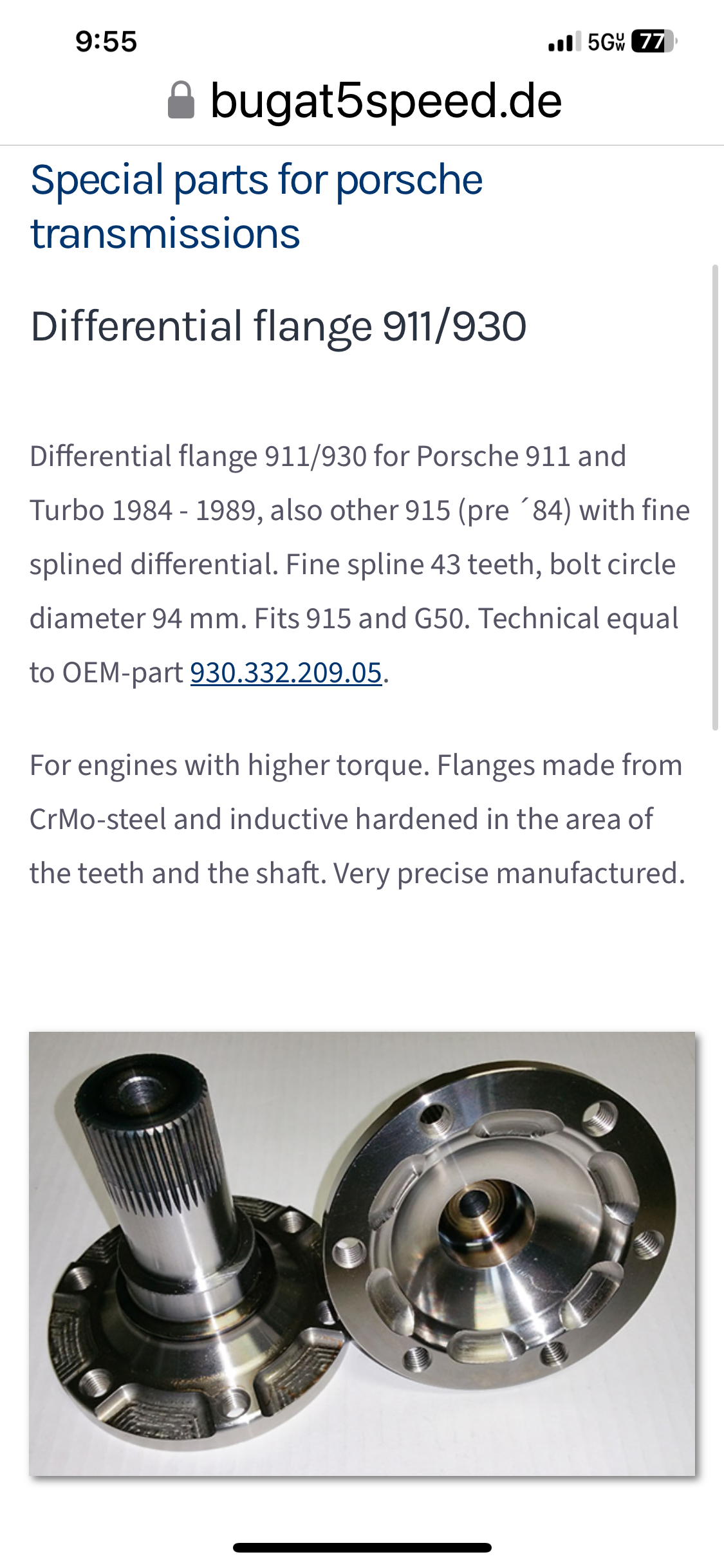

Look at the Pelican 911 Forum for tech information on flanges.

Maybe it's just ME!
The dowel pin holes look oversized to me...
Those look nice but I'm in agreement with everyone else.
Those DON"T look "Porsche" to me either!
