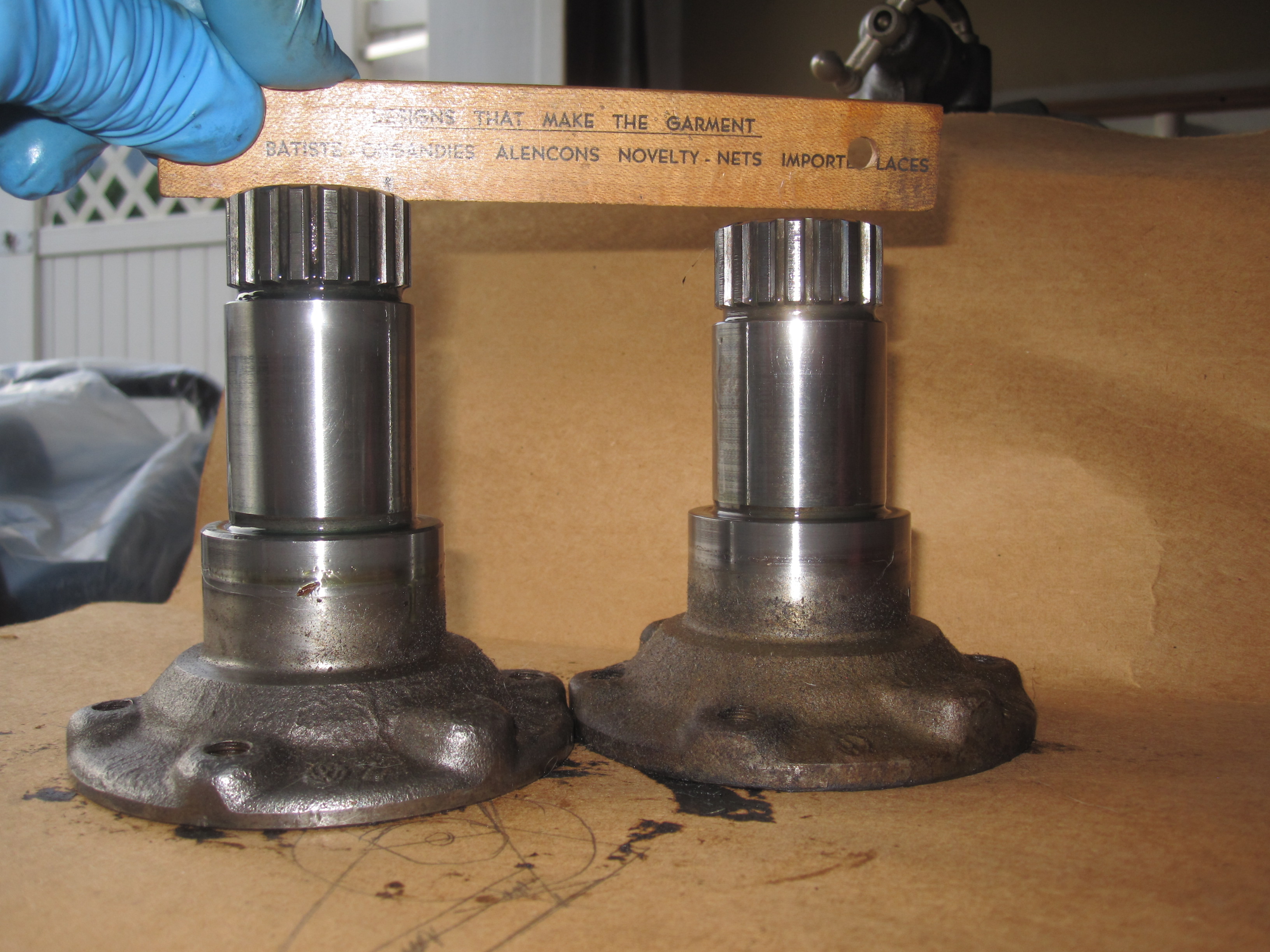

Lot thicker and longer shaft.
Not a single ... Aug 10 2024, 04:26 PM

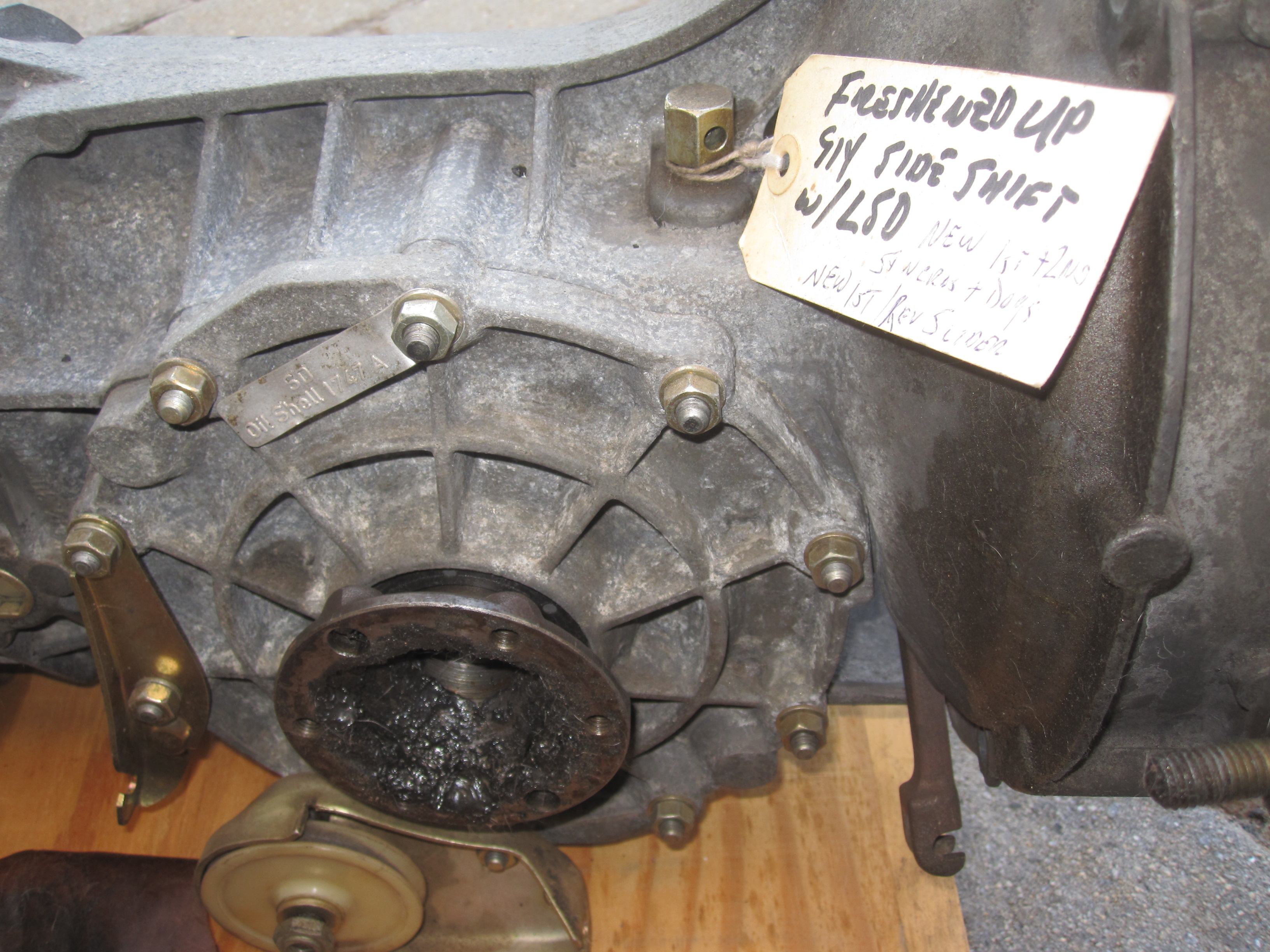

mepstein Currently on the bench. Early 911 mechanical 915 g... Aug 11 2024, 05:53 AM
technicalninja Thanks for the pics @Mepstein
I stand corrected... Aug 11 2024, 09:19 AM
mepstein All good. We keep a low profile but try to put out... Aug 11 2024, 10:04 AM

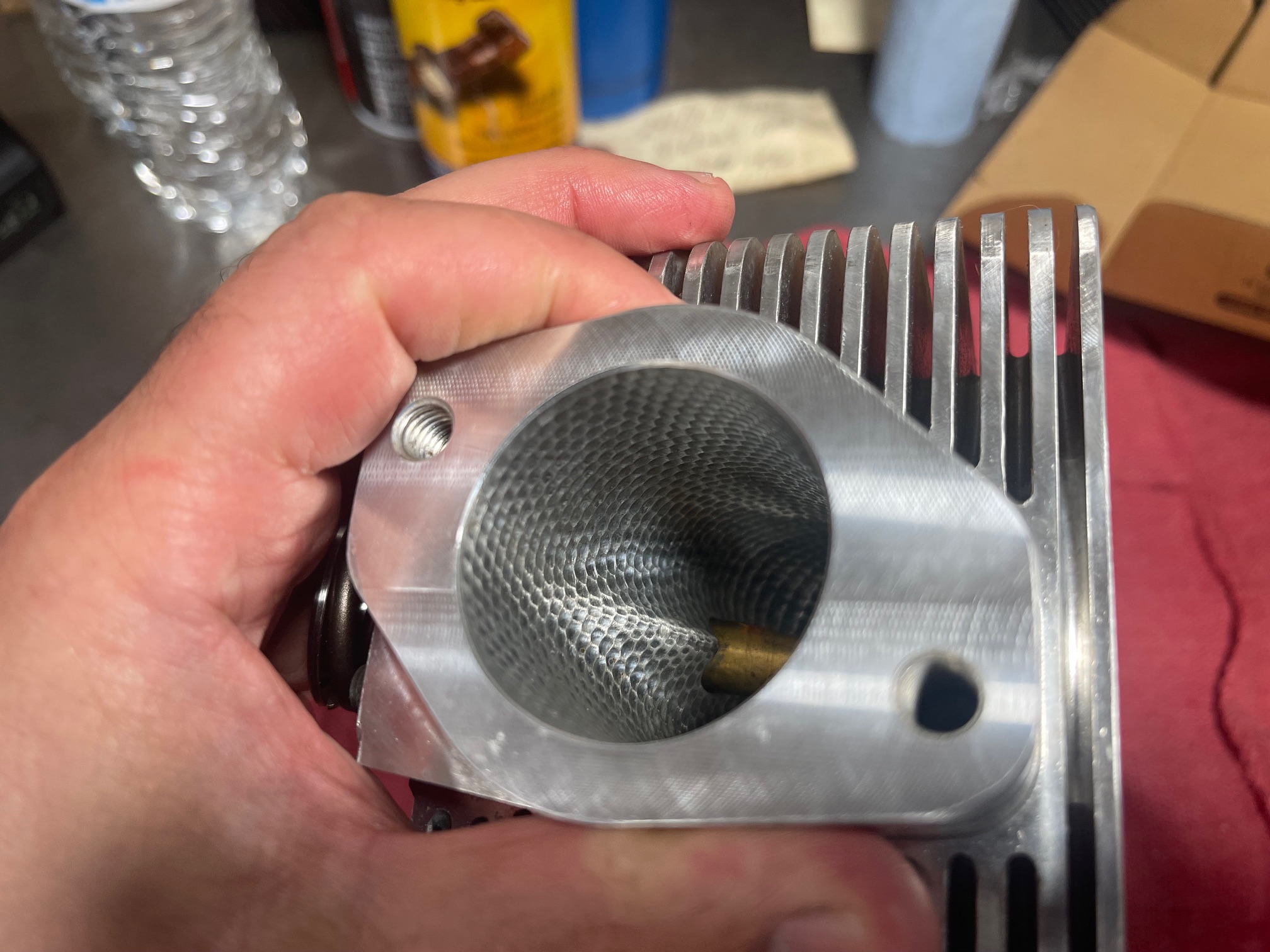

technicalninja One of the "horrifying thoughts" was wha... Aug 11 2024, 10:54 AM
rhodyguy WOW! A lot of space to heat during a cold east... Aug 11 2024, 11:06 AM
live free & drive Dig the high flow skin effect dimpling on those he... Aug 11 2024, 11:13 AM
technicalninja He didn't have the eye candy pics up at my las... Aug 11 2024, 11:20 AM
technicalninja @mepstein
We are committing the dreaded "th... Aug 11 2024, 12:04 PM
mepstein The big shop is a complicated story. Still too man... Aug 11 2024, 02:17 PM
mepstein The heads are super cool. The dimples are for a ca... Aug 11 2024, 02:25 PM
live free & drive For Technical Ninja regarding dimpling in manifold... Aug 11 2024, 06:10 PM
technicalninja Thank you for the link!
It got deep in a big ... Aug 11 2024, 06:27 PM

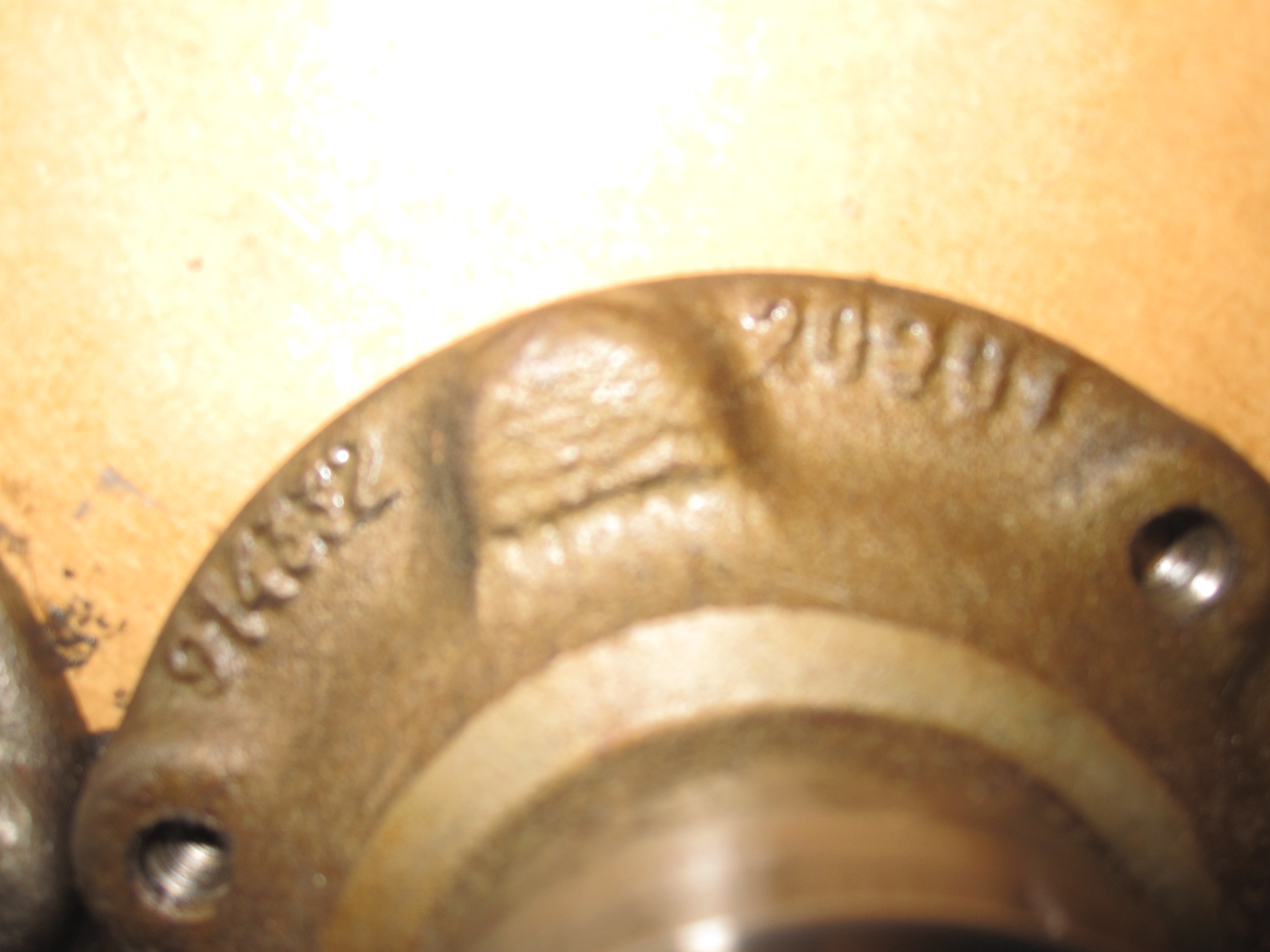

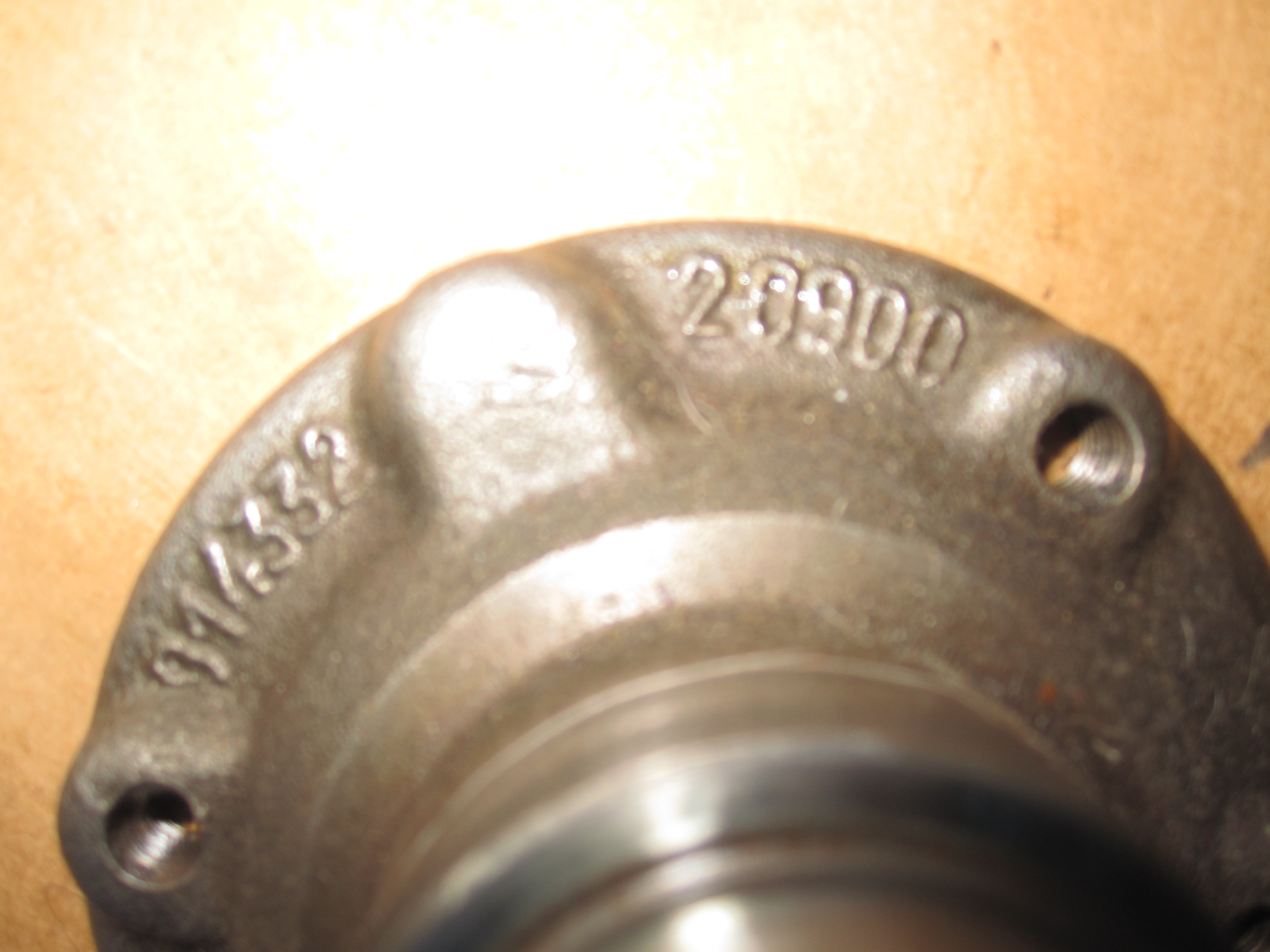

rgalla9146 Finally got back to this subject.
LSD flange ... Aug 23 2024, 05:50 PM
rgalla9146 LSD output flange Aug 23 2024, 05:52 PM
Dr Evil
LSD output flange
Bingo. Also a lot of confusion... Aug 24 2024, 08:33 AM
