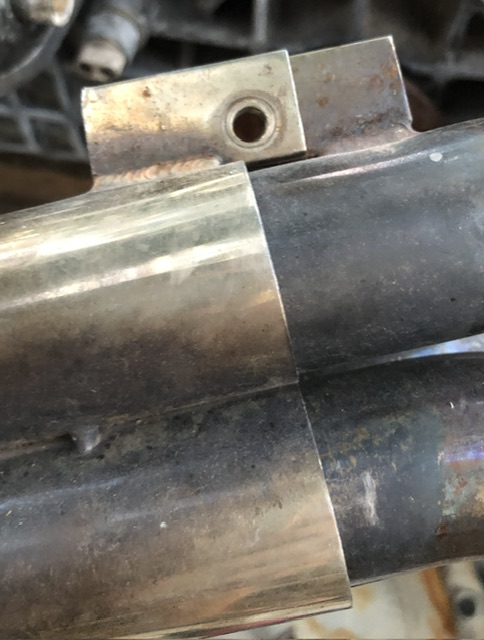

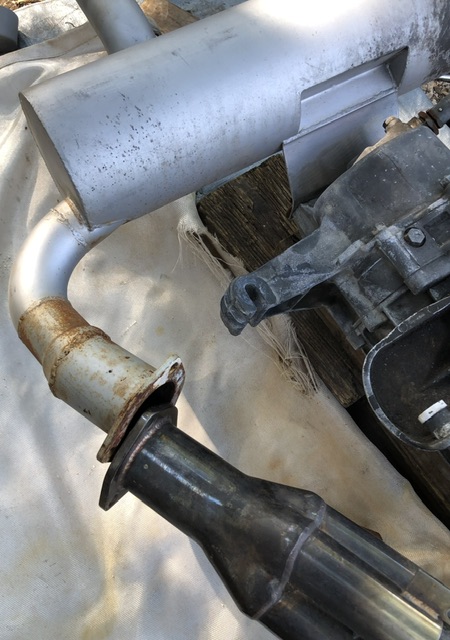

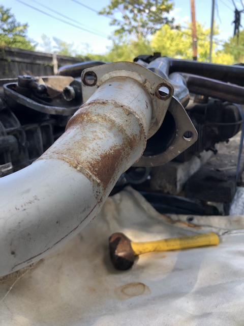

I have a set of 4 into 1 stainless headers that I want to connect up with an old stainless steel 1in-2out Tangerine muffler. The muffler was obviously not made for this header system but they are not that far off either. Well a little is a lot in this case I guess.
I have a MIG welder and thought I’d buy some self-shielded stainless wire (rather than invest in a whole tank of gas), and try to fix the gap. If nothing else I figured I could tack up a solution and let a real welder finish it (if blowing holes became unavoidable).
I’ve found that the tube exiting the muffler is apparently made up of mild steel at the flange (magnet sticks strongly), then the curved mid-section of the tube is a low carbon steel (magnet sticks BUT NOT strongly), then the very short part is all stainless as is the rest of the muffler (magnet does not stick).
I’m looking for suggestions as to where you guys would cut, maybe good only spots to buy pre-curved stainless or what to search for. General suggestions would be appreciated. Part of wanting to take on this task is that I’d like to add to my welding experience if I can. Here are some pics of the project:

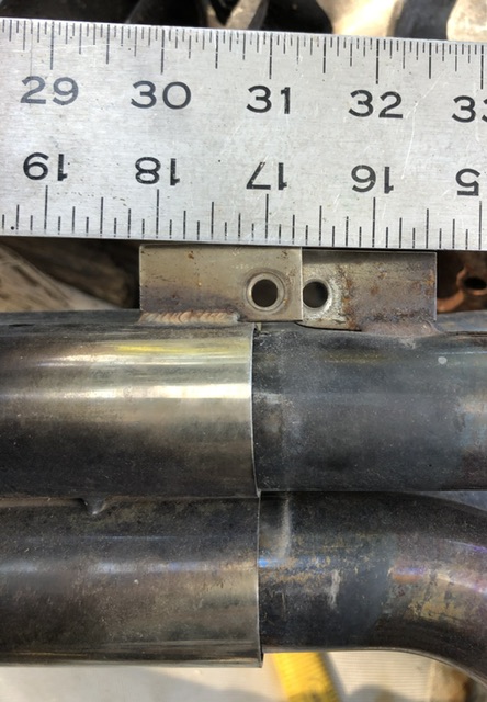

At the header, I’ve actually slid the collector down about 1/2” in these pics so that the flanges would touch. I think there is still plenty primary pipe inside the collector, but is there a minimum I should be concerned with? I could obviously move it back where it was designed to sit, if changing the muffler input area anyway.

Ok there is no way that muffler is stainless as it is rusting in a way stainless doesn’t. Are wanting to modify the header or the muffler? Always cut the straight section never in a bend
ChrisFoley
post Aug 14 2024, 04:57 AM
I am Tangerine Racing
Posts: 8,016
Joined: 29-January 03
From: Bolton, CT
Member No.: 209
I think the muffler inlet was altered by someone else already. Everything but the flange and first few inches is stainless. (I could be wrong. It was made a long time ago.)
It appears that two cuts and two short pieces of tubing would get you where you're trying to go.

(IMG:style_emoticons/default/agree.gif) cut in 2 places where shown, you have to extend it out away from the muffler, then you need to rotate the flange, so you might as well extend the flange so the collectors are fit in the correct position.

Right, your suggestions are along the lines of what I’ve been thinking.. only thing though is that I’m gonna need a “small drop down” section (probably just off the muffler) - like a soft “Z” shape, to get to the lower placement of the header flange. Is anything like that even available- or would it need to be made ?

Googling, apparently it’s called an ‘s‘ bend. They look to be much longer than what it appears you need.
Let’s call the cut next to the muffler cut 1 and the one near the flange cut 2.
Seems you could rotate cut 1 to account for the drop, then the extension piece you need to add at cut 2 could be slightly to account for any alignment. This would essentially create the “z’ you mention.

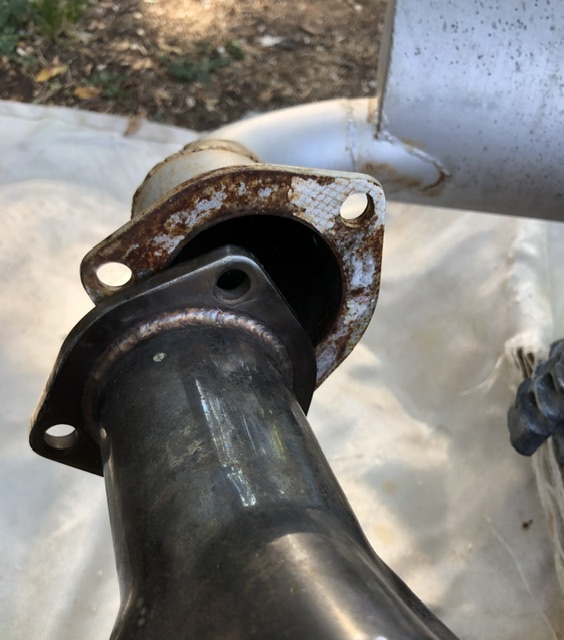

assuming the muffler body is released from it's mounting point... and the flanges are then bolted together - the muffler would then be pointing upwards at about a 45degree angle.
Getting the curved pipe red hot and pushing the muffler downwards to meet it's original mounting locations would probably just twist/collapse the curved pipe in on itself, no? Also, that would likely take more heat than I could build up too (only got a small bottle MAP torch, besides the Mig welder)
I think I'm gonna buy a "U" shape pieces and cut several pieces from it, possibly to include small "pie" cuts for a gradual step down if needed.

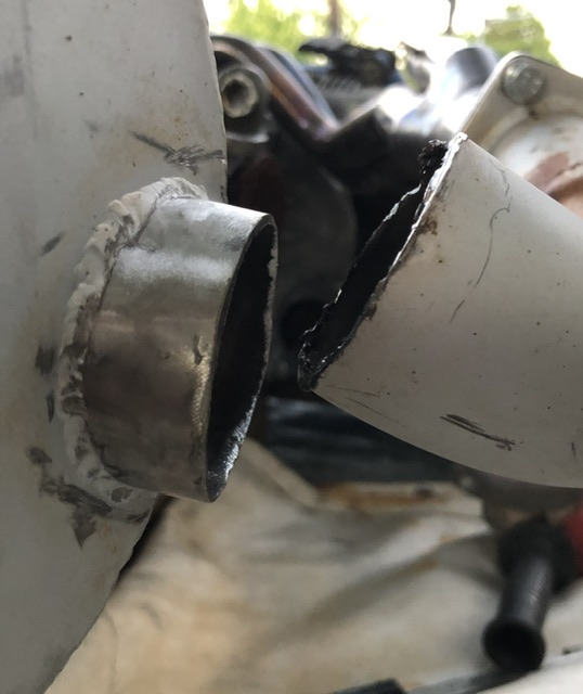

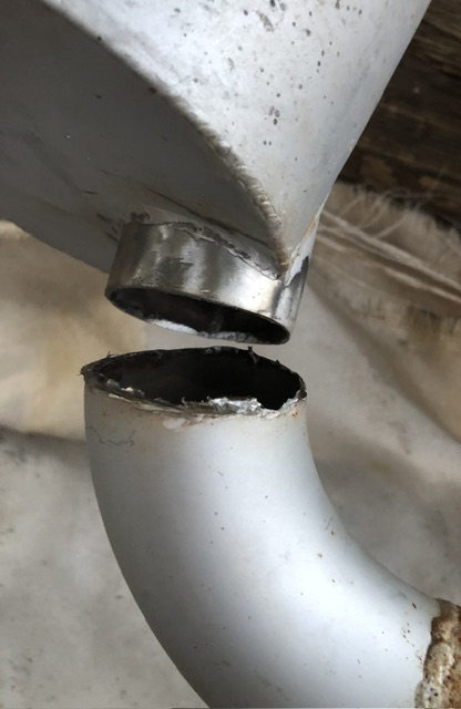

Ok well I made the cut at the muffler end of the curved pipe.. and bolted the flanges together
Literati914
post Aug 14 2024, 07:48 PM
Posts: 2,165
Joined: 16-November 06
From: Dallas, TX
Member No.: 7,222

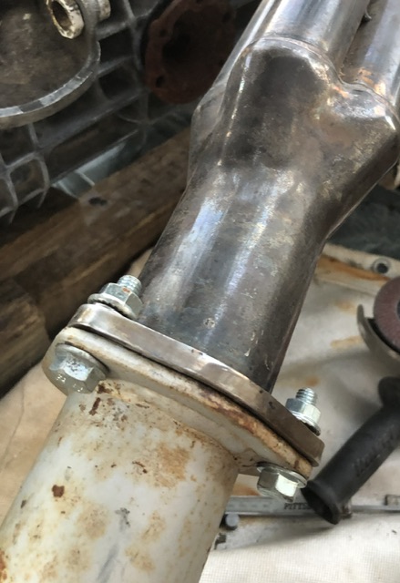

Also drove the collector up to where it’s supposed to sit:
Literati914
post Aug 14 2024, 07:51 PM
Posts: 2,165
From: Dallas, TX
Member No.: 7,222
Now I can see the situation better..
if I now make a cut at the muffler’s flange and clock the curved pipe downward just a little bit, the pieces will line up nicely. No need for a “Z/S” shape:
Literati914
post Aug 14 2024, 07:52 PM
Posts: 2,165
From: Dallas, TX
Member No.: 7,222
Looks like only a 1/2”- 3/4” filler piece of stainless will be needed to bridge the gap:

I would still make the second cut where infraredcalvin drew it. That will give you more flexibility to make adjustments when you try to align it all together, and it will be easier to weld than right at the flange.
