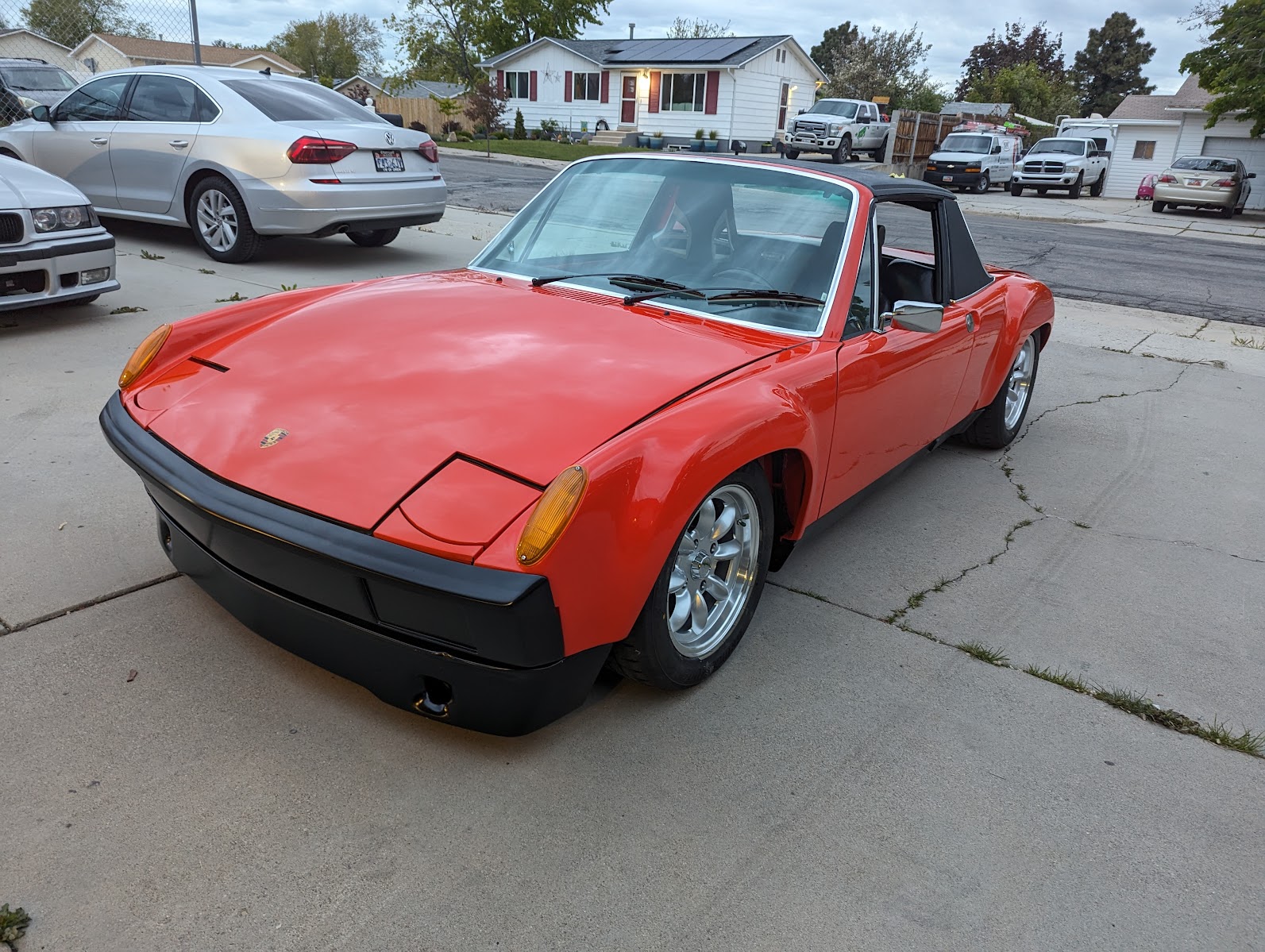

QUOTE(Superhawk996 @ Aug 17 2024, 11:40 AM) *
Without clear coat you’re not going to end up with depth and shine.

That comment was when I was under the impression that he was taking about doing a base coat / clear coat system as base coat only.

Base coat without clear coat barely looks like paint, has no gloss, has no durability, and is never done. OP was talking about single stage (all-in-one) paint. It already has the gloss and UV stuff built in. Because it is in direct contact with the elements it needs to be cut & polished & waxed often to keep it's luster. Clear over SS keeps it pretty longer.
