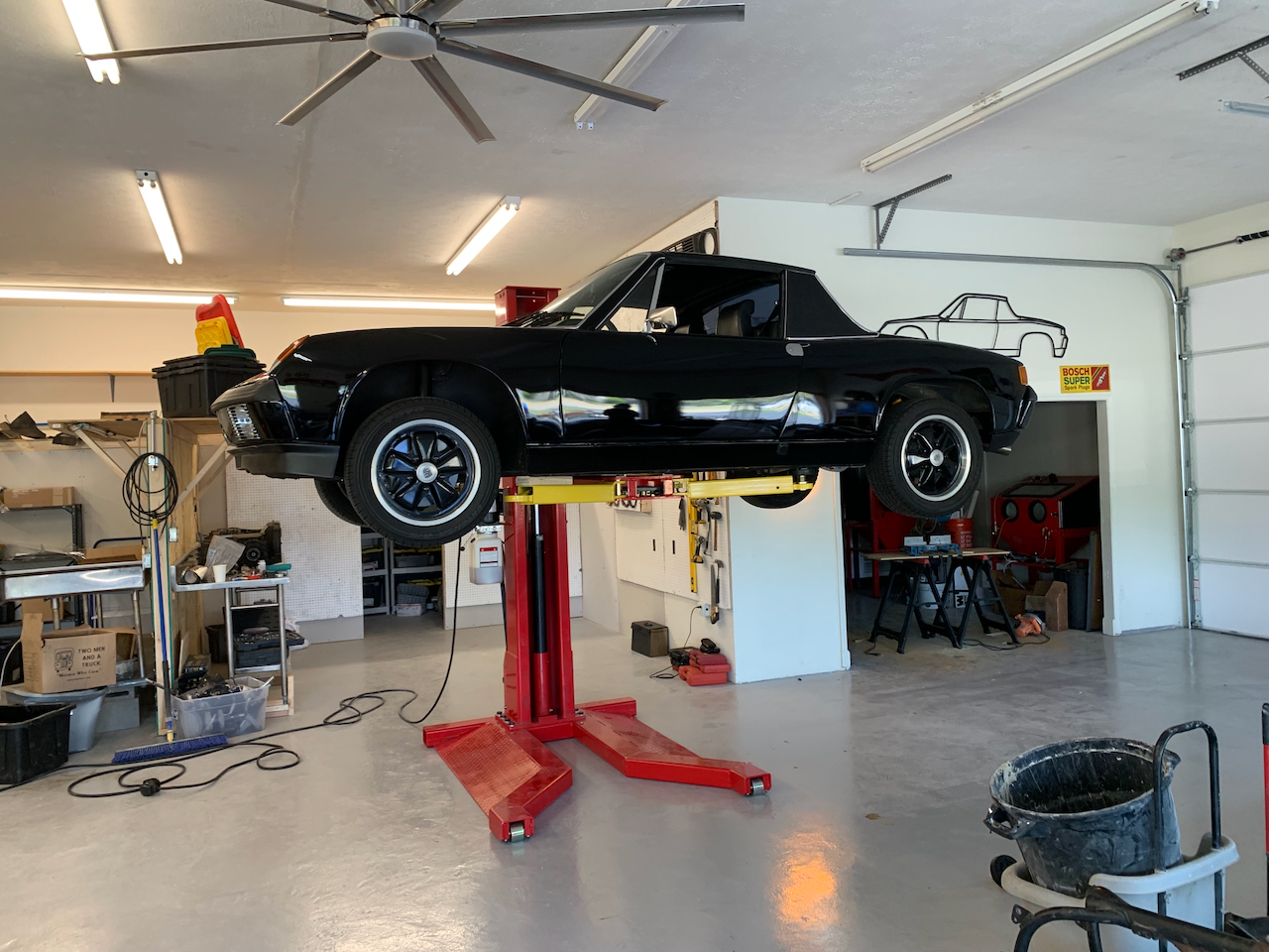

Nice car ! And a very nice floor lift. Who makes it ?

QUOTE(jim_hoyland @ Aug 17 2024, 07:03 PM) *
According to Dr Evil, the proprietor:
https://www.bestbuyautoequipment.com/amgo-h...ift-p/sml-7.htm

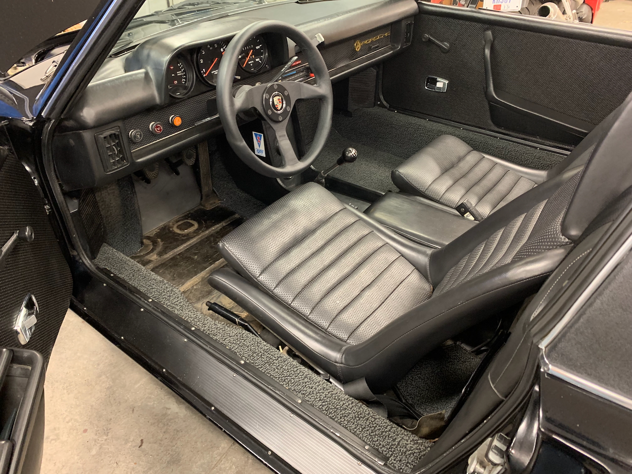

Interior is very clean and fairly original other than the steering wheel and the glove box badge. There is a battery cutoff tucked up on the side of the center console. The driver's carpet isn't installed, it has no grommets and climbs up under the petals; I'm working on that. I haven't yet opened the door panels to see if the frame was cut for speakers.

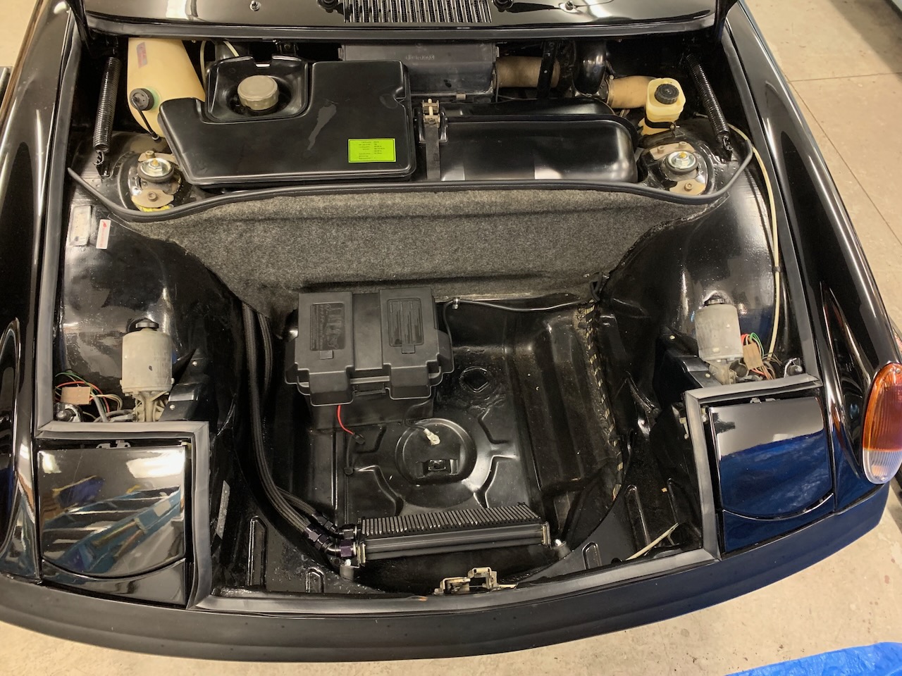

Front Trunk has the battery box and oil cooler. The cooler is plumbed through the heater tube with braided line; I'm sure there are opinions about that. The round in the front panel have been removed, but there isn't any other ventilation. It should heat the battery, but I haven't done any measurements. Anyone have any experience with this kind of setup?
The trunk shows signs of something applied to the rear corners under the shiny paint. I haven't looked too hard yet. Looking up from the bottom may reveal something.

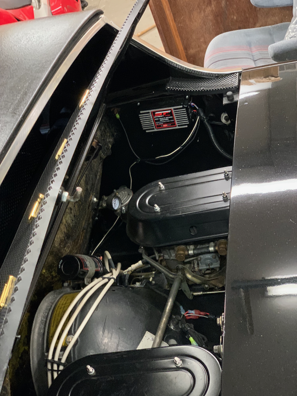

Engine bay looks pretty good. Black cars are so dark in here. You can see that this car was originally yellow.

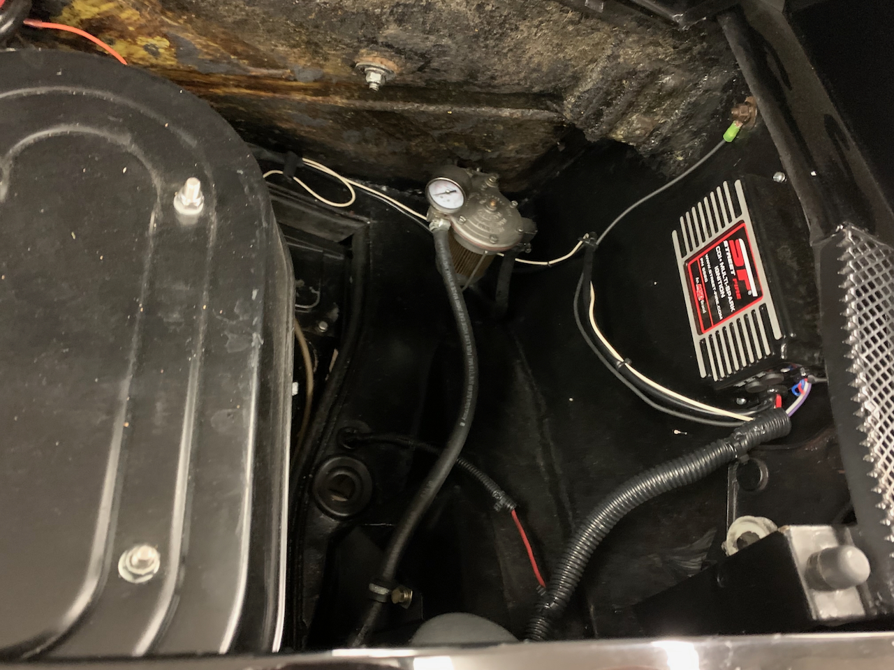

Hell hole, with the battery moved to the front trunk there's space for an enormous fuel filter.

QUOTE(zoomCat @ Aug 18 2024, 11:24 AM) *
Nice looking 914. Looks like it really scoots.

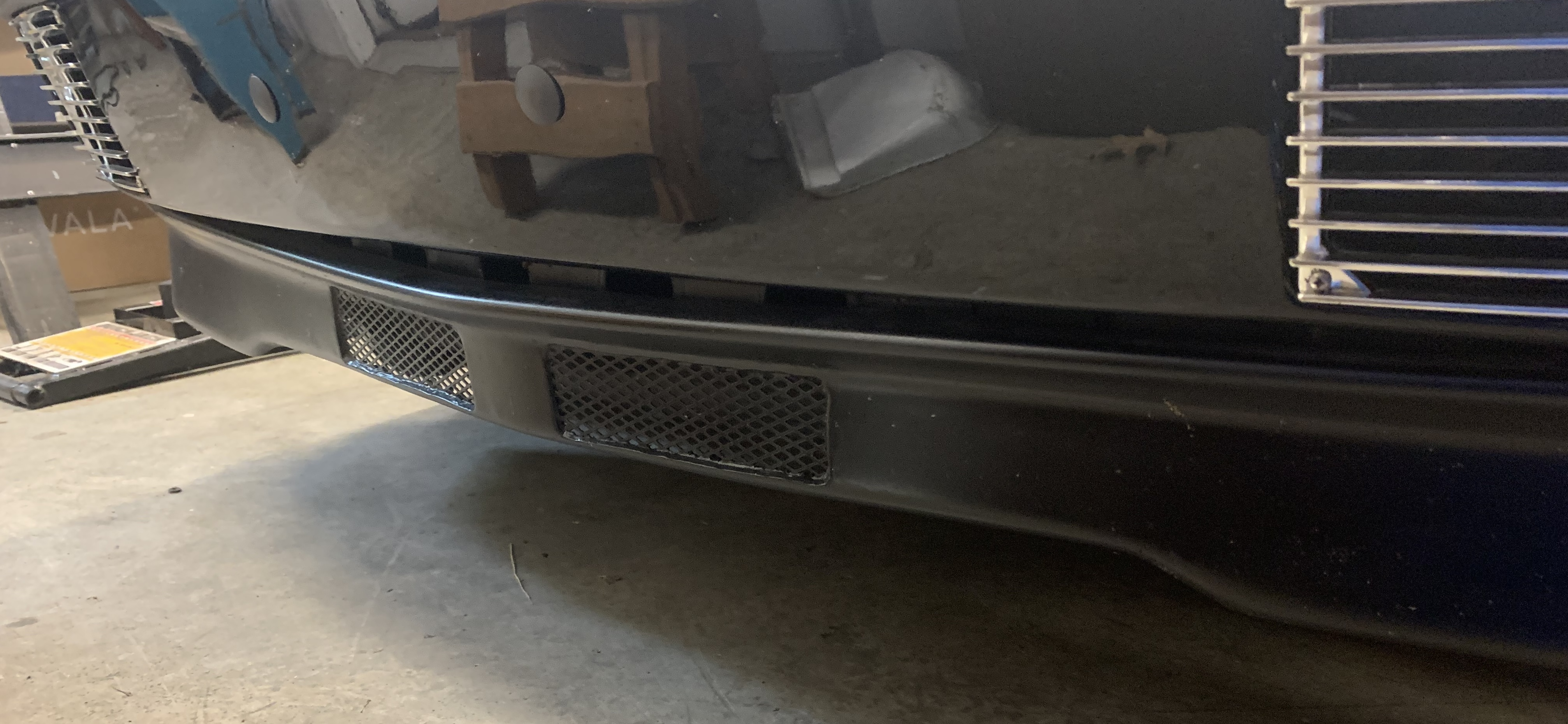

About the oil cooler, you mention the round cut outs in the front panel are open to let air in. Is there a cutout in the front bumper to clear the holes for air?
Once air comes in through the holes, were does it escape? I didn't see any exhaust holes for the heated air.
Reminds me of the oil cooler in my 930 being located in the front fender directly behind the headlight fixture blocking the top 1/2 of the cooler while the lower half of the cooler only has a small opening below the bumper. While sitting still the cooler does nothing so I added a thermostat-driven fan which helps remove heat tremendously. I can see the oil temp plateau on the gauge when the fan kicks on.

Please get that fire hazard of a fuel filter and pressure gauge out of the engine compartment ASAP.

QUOTE(Superhawk996 @ Aug 20 2024, 09:15 AM) *
What is the specific concern? It’s a Malpassi Filter King which has been in production for some time, and I don’t see reports of issues.

QUOTE(Spoke @ Aug 20 2024, 01:29 AM) *
There is no apparent escape for airflow, other than what filters into the interior and around the trunk gaskets. The engine has its original oil cooler so this cooler may not see much load in normal driving. I haven’t driven the longer than 40 minutes at a time so it may simply not have saturated the enclosed spaces in that short time. I’m thinking to set up a wireless barbecue temperature probe and see what actually is happening.
Here’s a shot of the openings behind the bumper:

QUOTE(zoomCat @ Aug 20 2024, 12:02 PM) *
It’s poor design practice to have a fuel filter in the engine compartment, particularly where leaking fuel (due to poor seals or a cracked glass fuel bowl) can leak down onto a hot exhaust system.
With respect to reports of issues, search this site and you’ll see the recent posts of vehicles totaled by engine bay fires.
In my opinion, there is no reason to take unnecessary risks. As always, it’s your car, you get to decide what to do.

QUOTE(Superhawk996 @ Aug 20 2024, 11:17 AM) *
Looks to be a very nice car - enjoy it!
Trying to not be a jerk, but I have always had a fuel filter in the engine compartment

QUOTE(zoomCat @ Aug 20 2024, 12:40 PM) *
You can always remove the round access panel from the bottom of the front trunk. They are held in with seam sealer. I removed them on my 6 conversion to give the air an exit point.

Also, I agree with Mark - I would provide some sort of exit for the hot air from the trunk. Be that the round access holes in the trunk floor or something else. (IMG:style_emoticons/default/smile.gif)
