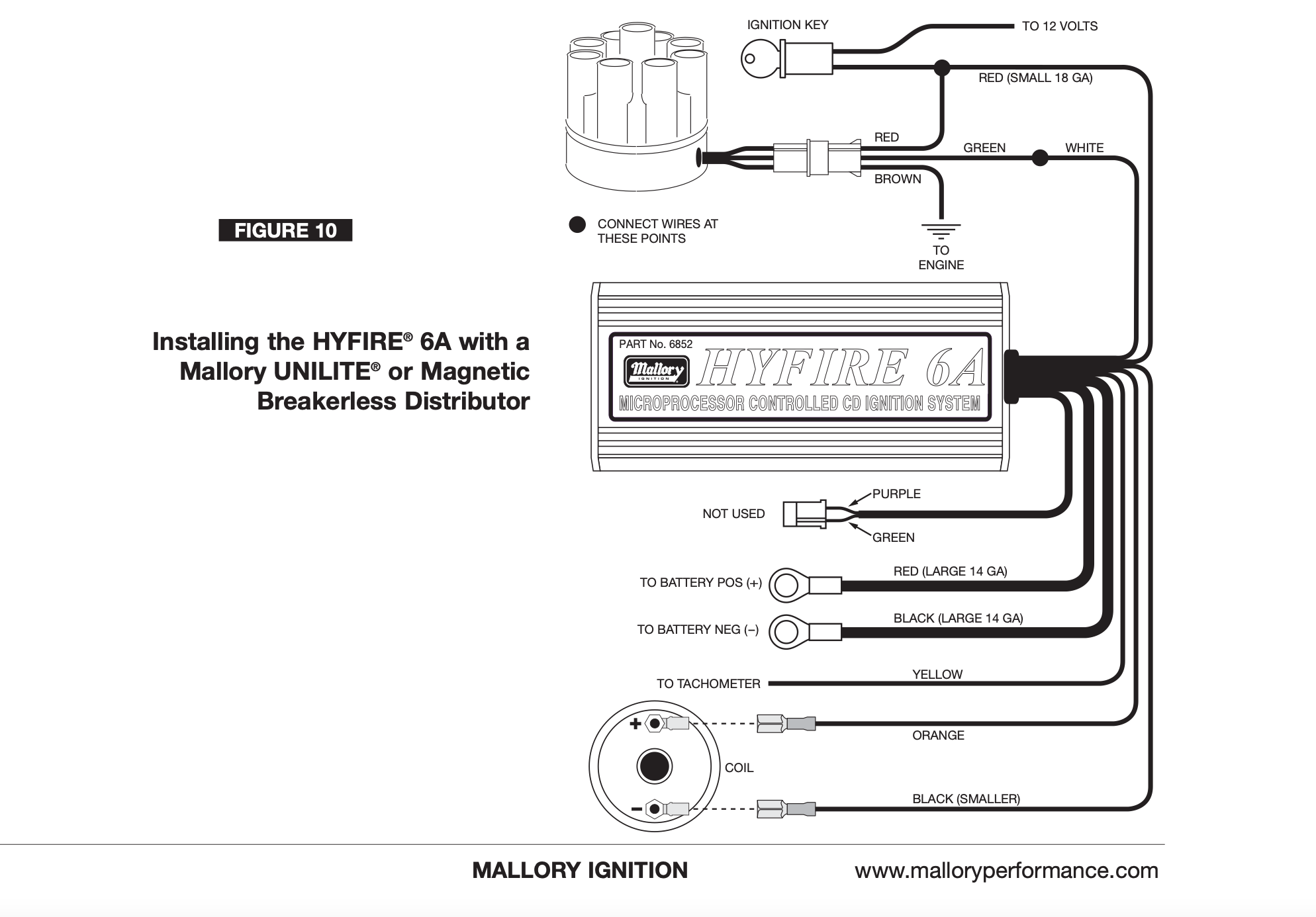

I have the Mallory HIFIre VI al (rev limiter)model and the Unlit distributor for the trigger. The yellow wire is the tach signal and the coil has multiple pulses. NO tack signal buffer in use
https://documents.holley.com/6852m.pdf
rfinegan
post Aug 23 2024, 01:35 PM
Posts: 1,194
Joined: 8-February 13
From: NC
Member No.: 15,499
pic
