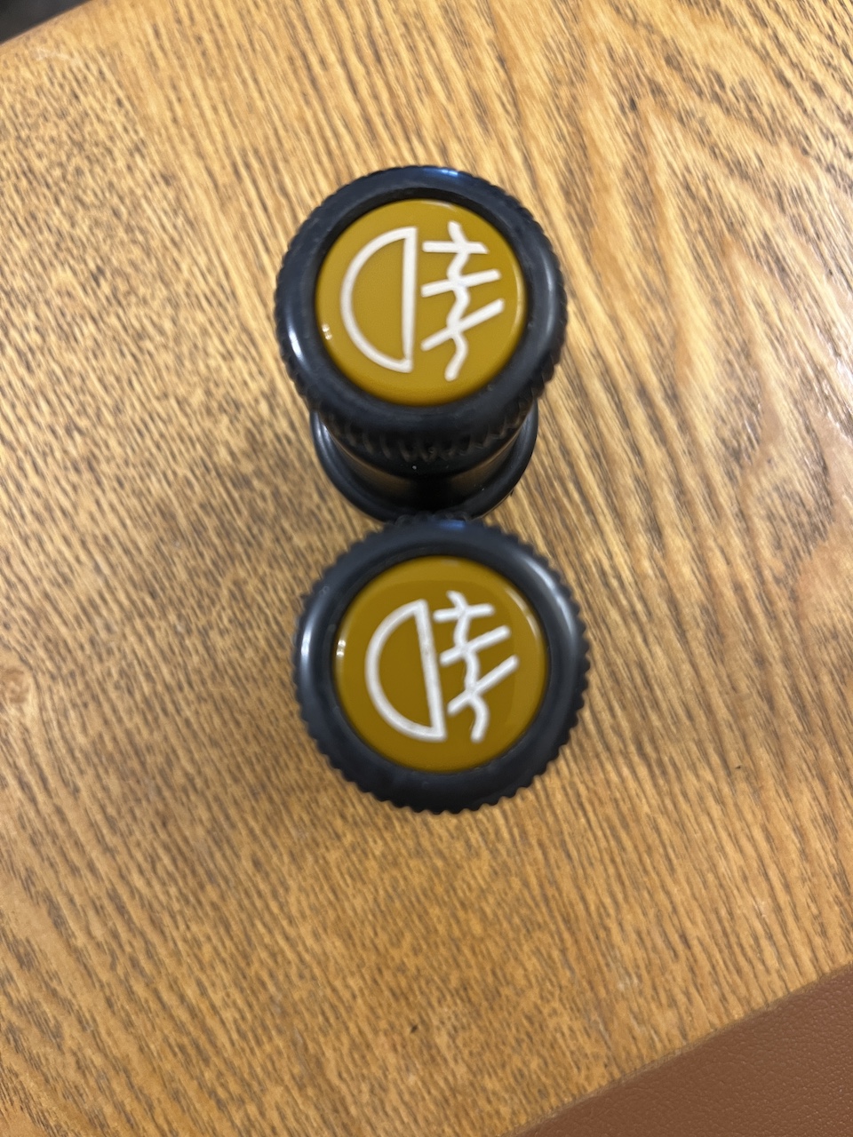

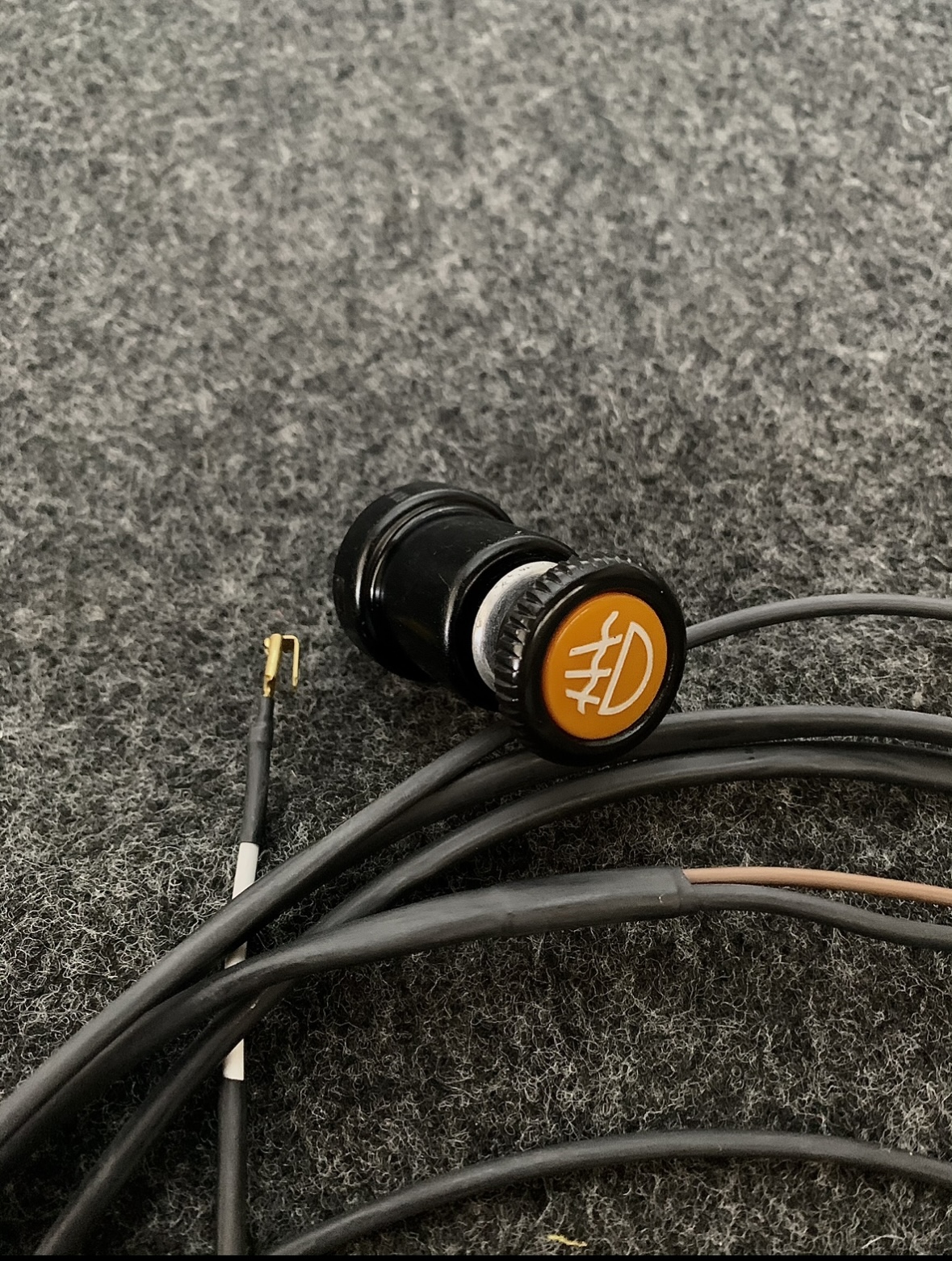

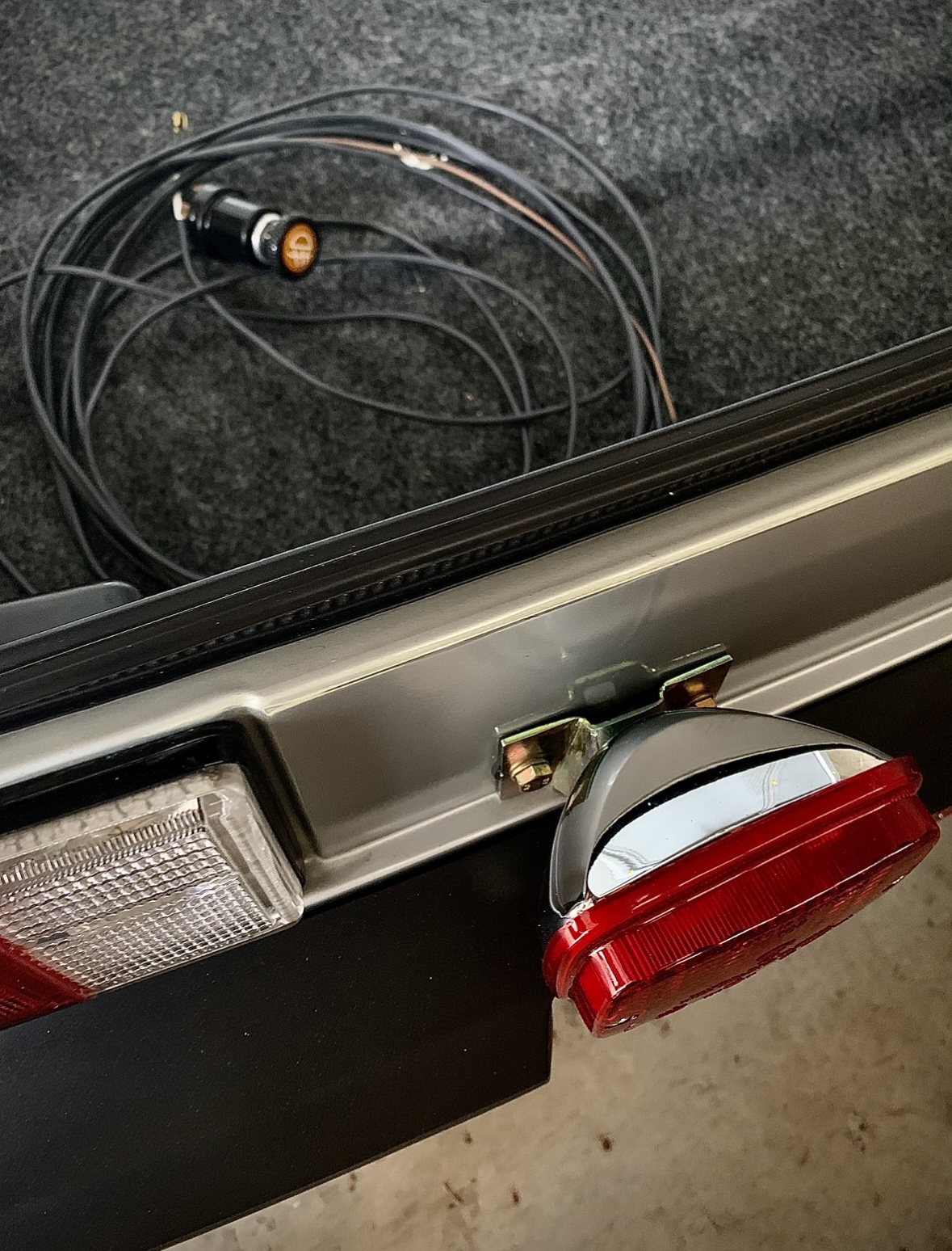

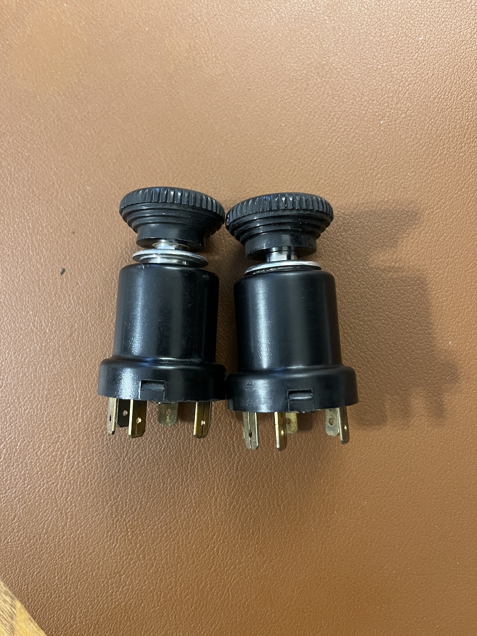

I made these up using 911 fog light switches. Pull out for the fronts and then twist to the right for the rear. 914 fog light knobs and escutcheon added for the conversion.

Do you know the part # for the 911 switch you used?

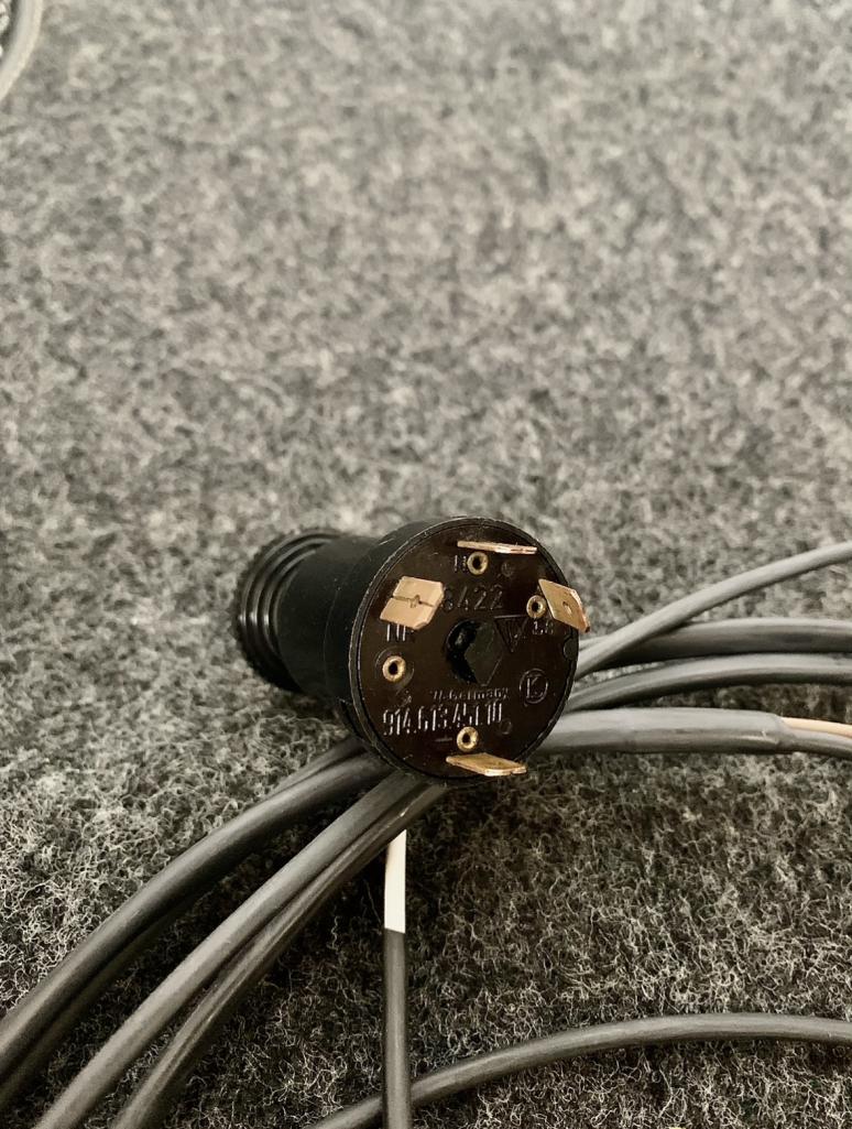

There’s actually an original 914 switch for this application….part number #914.613.451.10. I used this switch along with an original wiring harness to operate the rear fog on my ‘74 2.0L.

Part number 911 613 147 00. 914 switch is NLA
