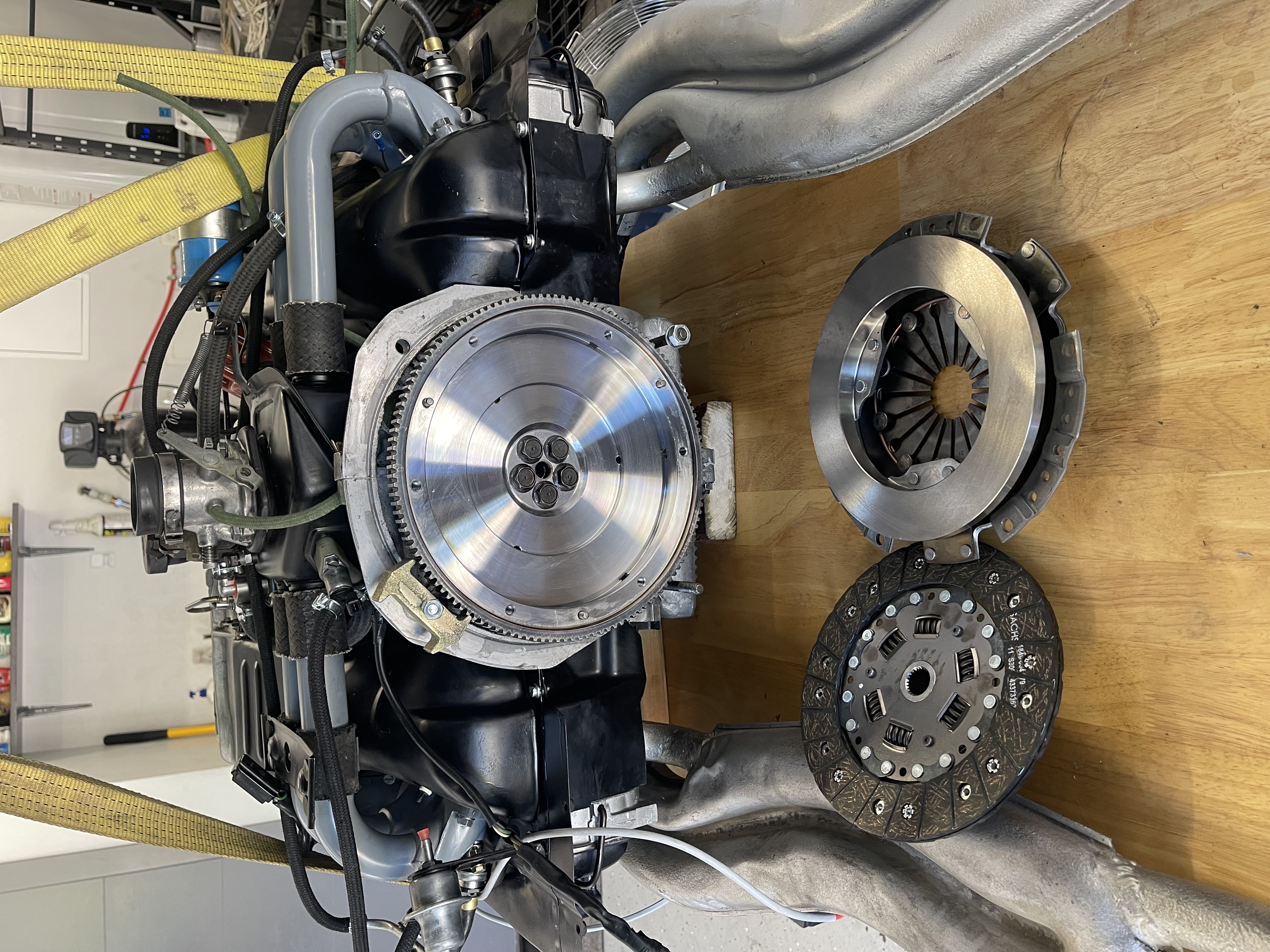

I have rebuilt my 2.0L and am down to mating trans to motor. When I did this I noticed I have no free play in the t/o bearing arm. I have measured and does not appear to be pressing the pressure plate fingers but is on them. Is that acceptable? I expected to have some level of free movement in the arm. Is there something else I can check? Flywheel, clutch disc, pressure plate and Throwout bearing are all new. Crank, flywheel and pressure plate was balanced at machine shop. Except for the flywheel that was completely shot all measurements on new parts Attached Imagematch old parts except slight wear on disc.

The pivot bolt behind the fork had 1 flat and 3 spring washers. I went down to just the flat washer and how have 1/4 free play. Thanks

The only way for the space between the TOB and pressure plate to narrow is if the clutch bits are protruding. When the PP and disk are bolted on, can you move the disk at all? Is the disk hitting the bolts for the flywheel? Is the disk in upside down?
