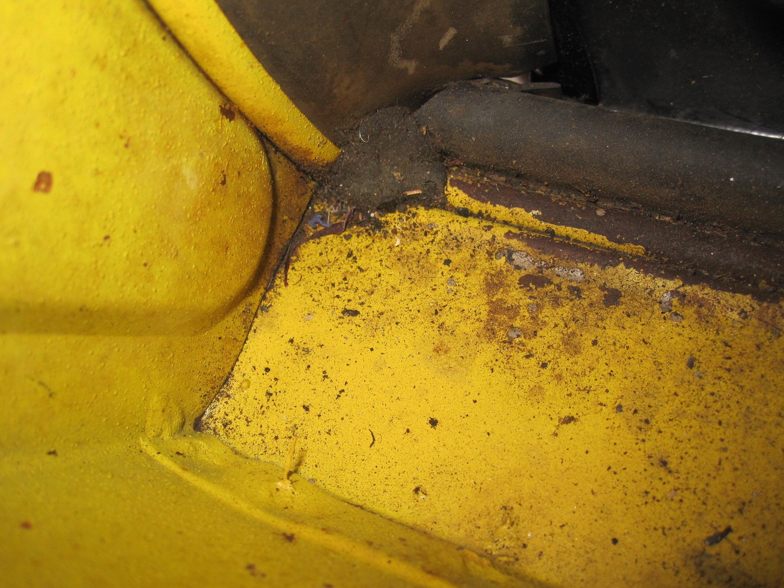

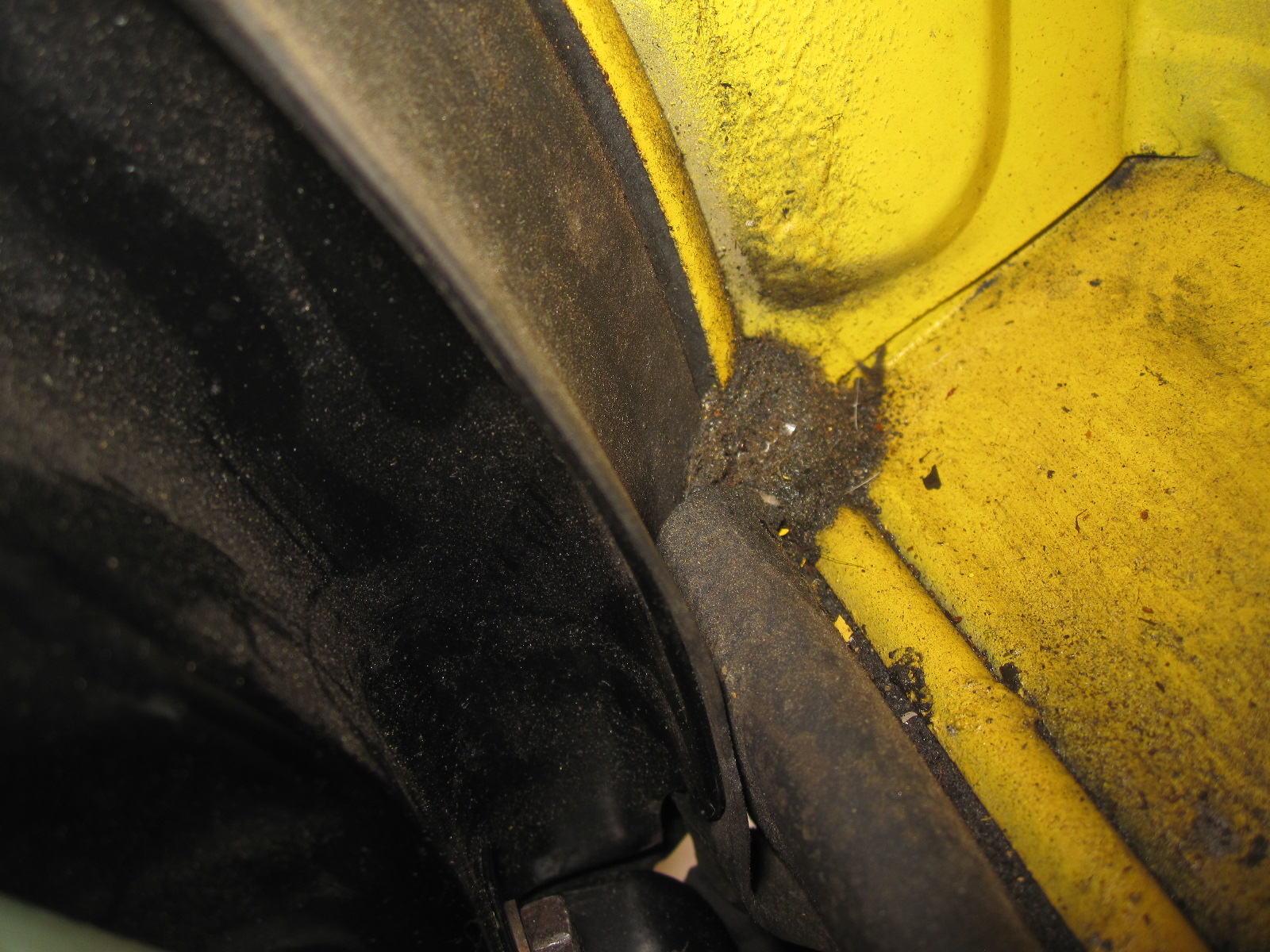

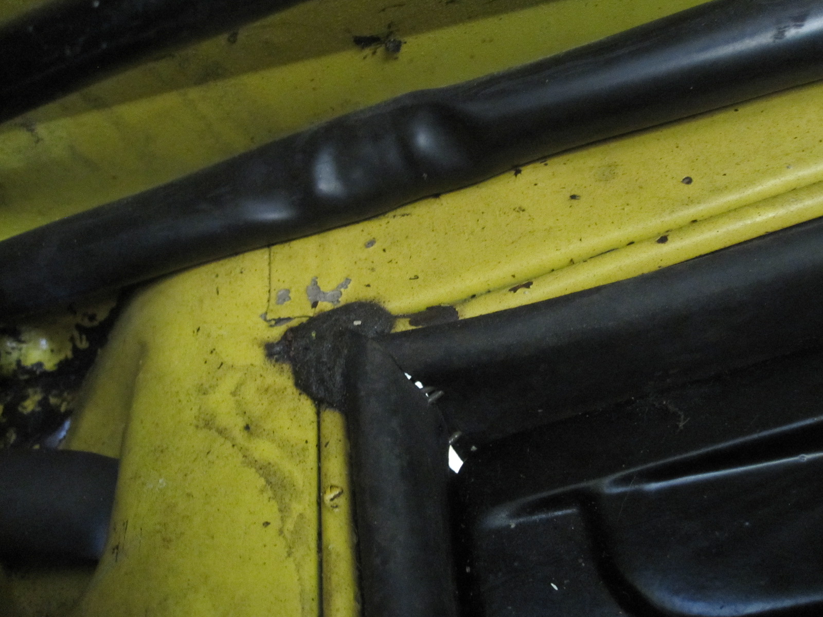

I don't have pictures of the hog rings used in all four corners or details of how the
corners were cut to fit
I do have pics of a detail I've seen in three cars now.
Coincidentally all were 914 6s
All had a small blob of 'dum dum' in each corner to insure a better seal.
In the first pic the hog rings can be seen.
