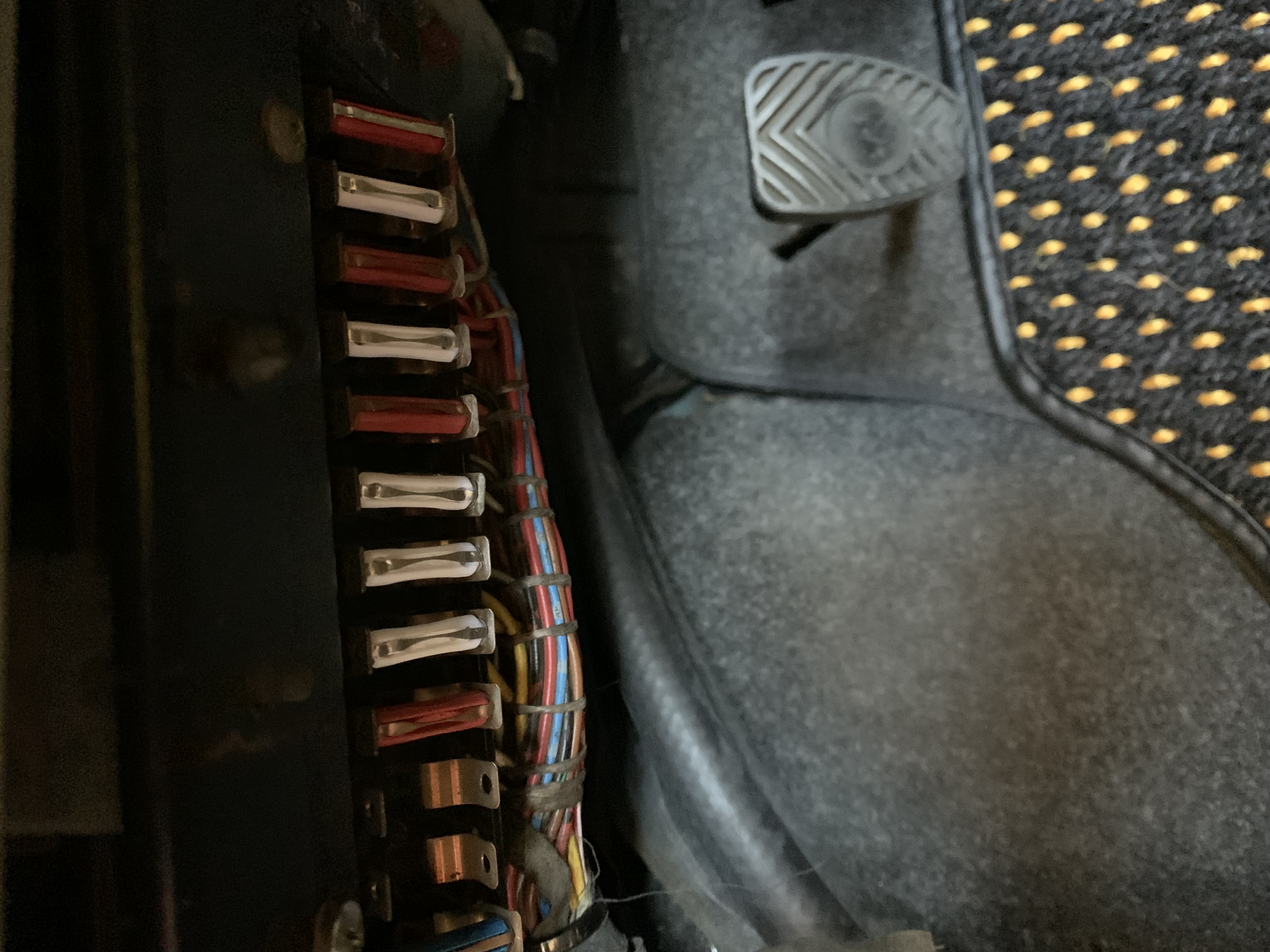

> Fuse panel, Missing 2 fuses

Hey guys missing the first 2 fuses on my 74. What are the first 2 used for and what size should the be?
Thanks

Do you have the owner's manual in the glove box? You'll find this info in there.
I have a '73. This is what's in my manual. Might be different for a '74.

here you go

Thanks guys!
