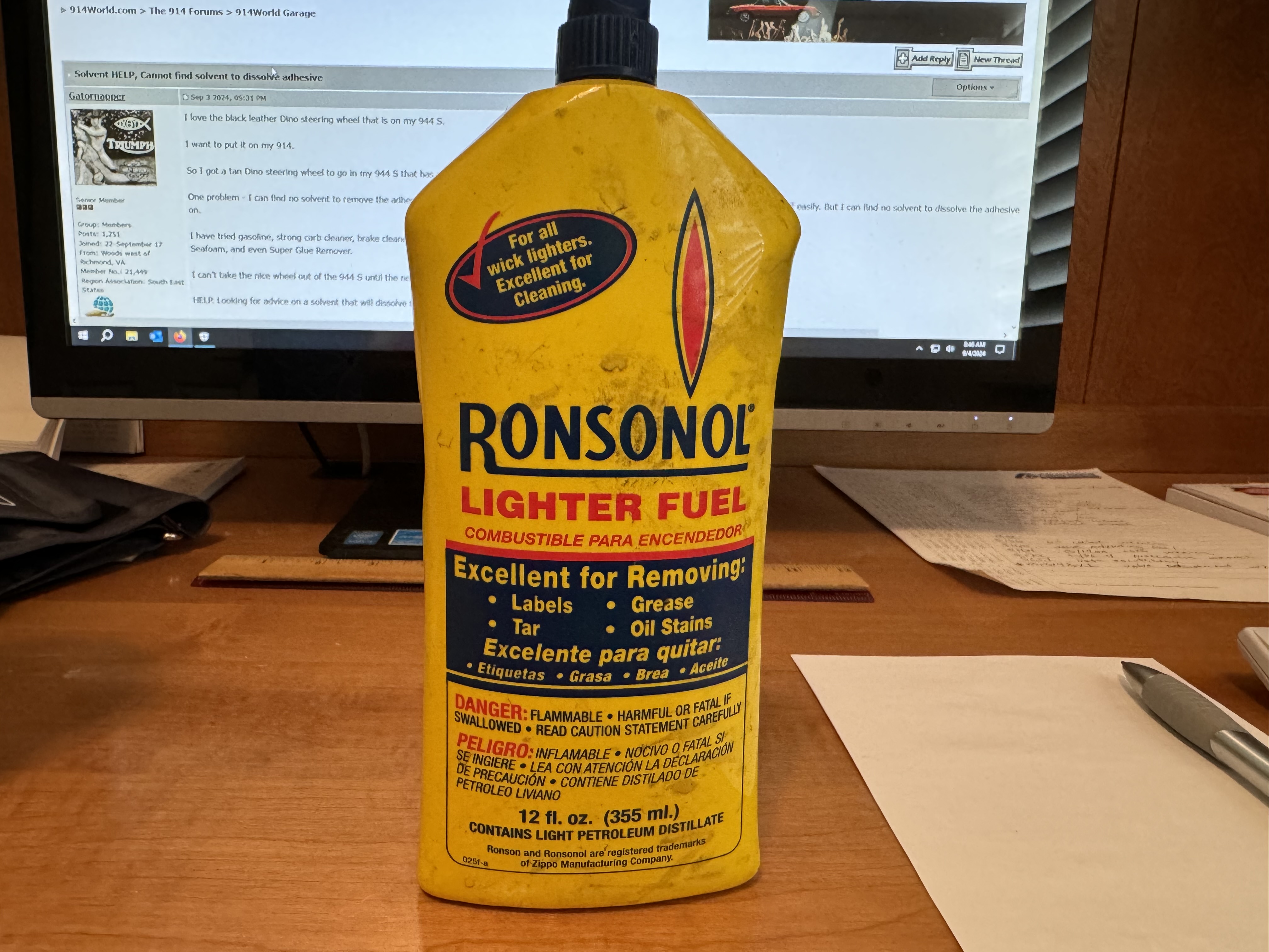

One more vote for "lighter fuel" not lighter fluid. You might even have it in your cupboard already. I'd try it first before stepping up to the 3M.
Mike
