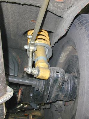

What do you have now? Any bar?
As mentioned Welt when it was available, was the go to.

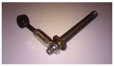

Unless you find one used or a NOS part Rose passion (who bought Automotion) stopped making them & now carries Tarret stuff.
The Welt unit used a slider adjustment to tune the bar (tighter / looser)
If you have a OE bar the only option is to use adjustable links, but the bulb
attachment means custom hardware.
I make a kit to use on the stock bar including modified shock bolts & custom links
but it ended up kinda spendy. (IMG:style_emoticons/default/rolleyes.gif)
