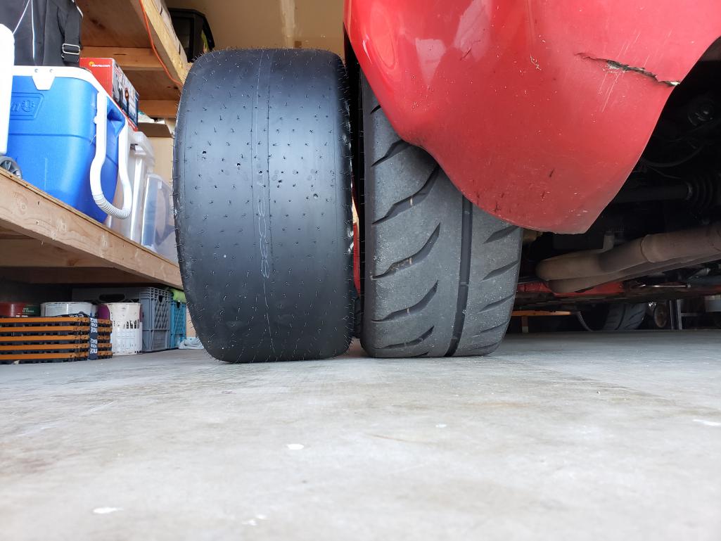

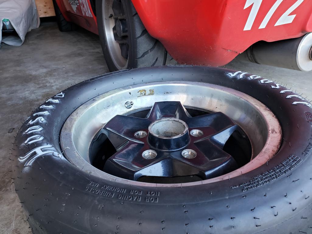

SirAndy   No stagger, Hoosier 23.0 x 9.5 x 15 C3500 R35B on ...   Feb 4 2025, 05:17 PM
FastFroggy   Great option, unfortunately looks like it has been...   Feb 20 2025, 06:35 PM
wndsrfr   Great option, unfortunately looks like it has bee...   Feb 20 2025, 08:24 PM
SirAndy   [quote name='FastFroggy' post='3192802' date='Feb...   Feb 20 2025, 08:58 PM
SirAndy   Great option, unfortunately looks like it has bee...   Feb 21 2025, 05:37 PM
stownsen914   Pretty sure GY bias slicks (and Hoosier too) are n...   Feb 23 2025, 02:25 PM
SirAndy   Pretty sure GY bias slicks (and Hoosier too) are ...   Feb 23 2025, 03:23 PM

GregM   Confirmed by Hoosier, they are discontinued   Feb 21 2025, 11:02 AM
SirAndy   Confirmed by Hoosier, they are discontinued :(   Feb 21 2025, 03:34 PM
