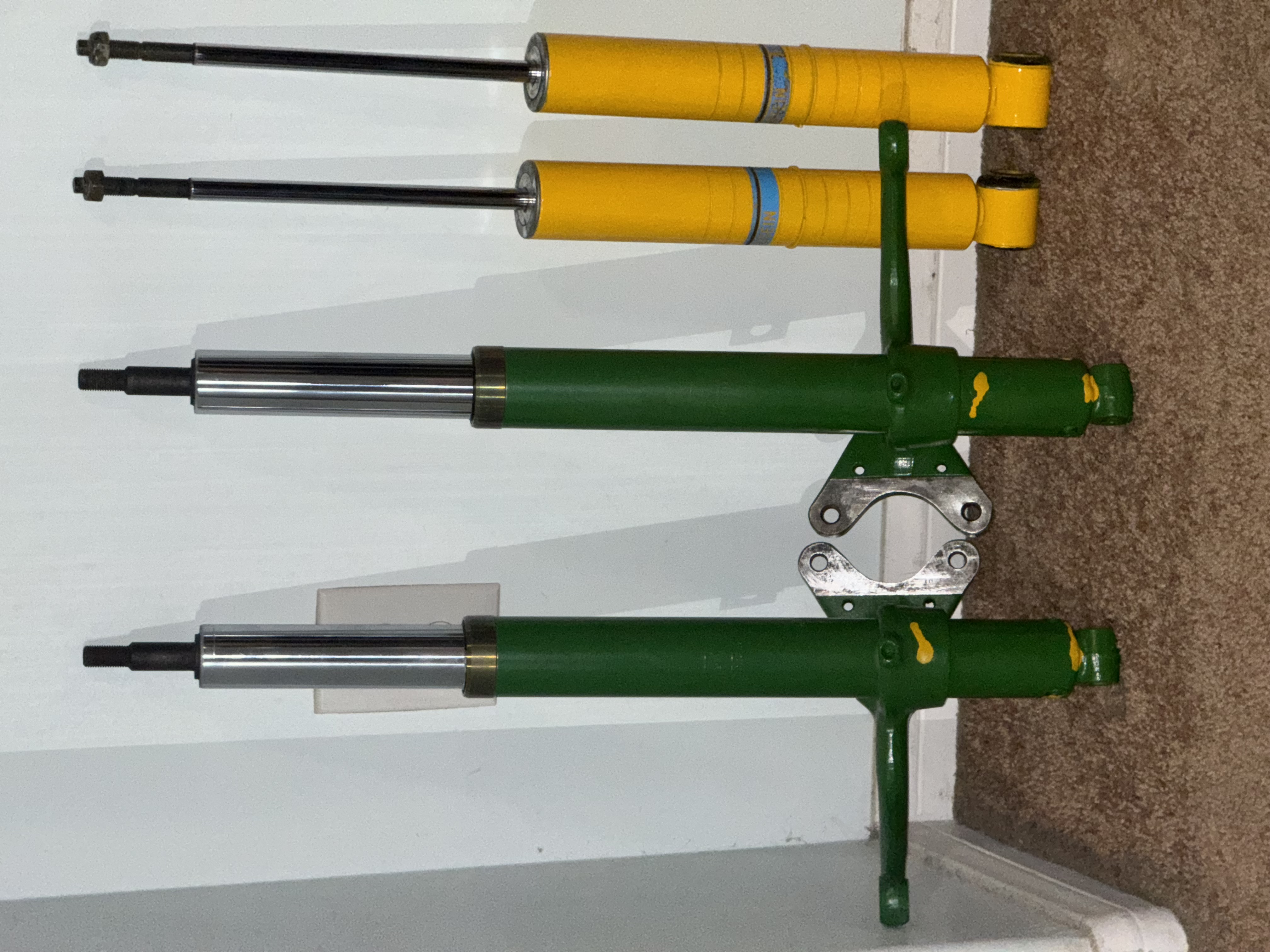

I raised mine 30 mm, I was going to run a bellow boot. Maybe yellow, if it doesn’t look too John Deere

Might not matter...
How low will the covers go installed on the car?
If you have interference, you could shorten the dust cover a bit.
Normally I try to leave weather protection devices on a street use vehicle.

So when you replace a steel trailing arm with an aluminum one on a LWB 911, you have to leave off the dust cap (cylinder) or it will hit the chassis. Unless the car is a daily driver, it’s not an issue. Might it wear out sooner than one with a dust cap, maybe but that’s not usually a concern on play cars.
