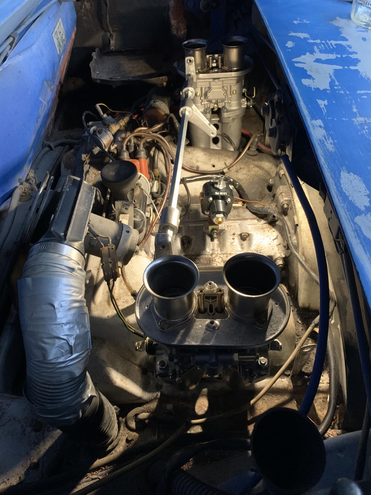

Hi friends. I'm currently installing some Weber clones on my 70 and have run into some issues. I'm using a CB linkage and filter bases. I tried installing the carbs with the linkage to the rear of the car, but the drop links hit the torsion springs used on the trunk. I flipped the bases so the crossbar is towards the front of the car, but the linkage needs to rotate counter-clockwise (see photo) in order to operate the carbs. I guess I could run the throttle arm on the top of the linkage and pull it that way, but I would prefer the arm to be in the down position. I was thinking maybe a custom cable which would be longer and come in from the back or perhaps some kind of lever to reverse the rotation?
I don't know, but I'm sure this has been dealt with in the past. Just looking for an elegant solution. As a side note, tall air cleaners most definitely don't fit the passengers side.
(IMG:http://www.914world.com/bbs2/uploads_offsite/www.thesamba.com-27418-1727464006.1.jpg)
Thanks in advance.

The tangerine solution is elegant if it fits your budget. I have mine roughly like you do, not the same bar though. There are some different accel cable mounts to help out too.
Maybe more pics will show up.

Move the bracket on the cross bar to something like this one (or get just get shorter intake manifolds):
http://www.914world.com/bbs2/lofiversion/i...php?t43028.html
Scroll down the thread in the post to see several options.
However, I agree with the other posters that the Tangerine Racing solution is a lot better (once you go through the pain of installing it, as it's not a simple bolt-on part). No longer use cross bar linkage.

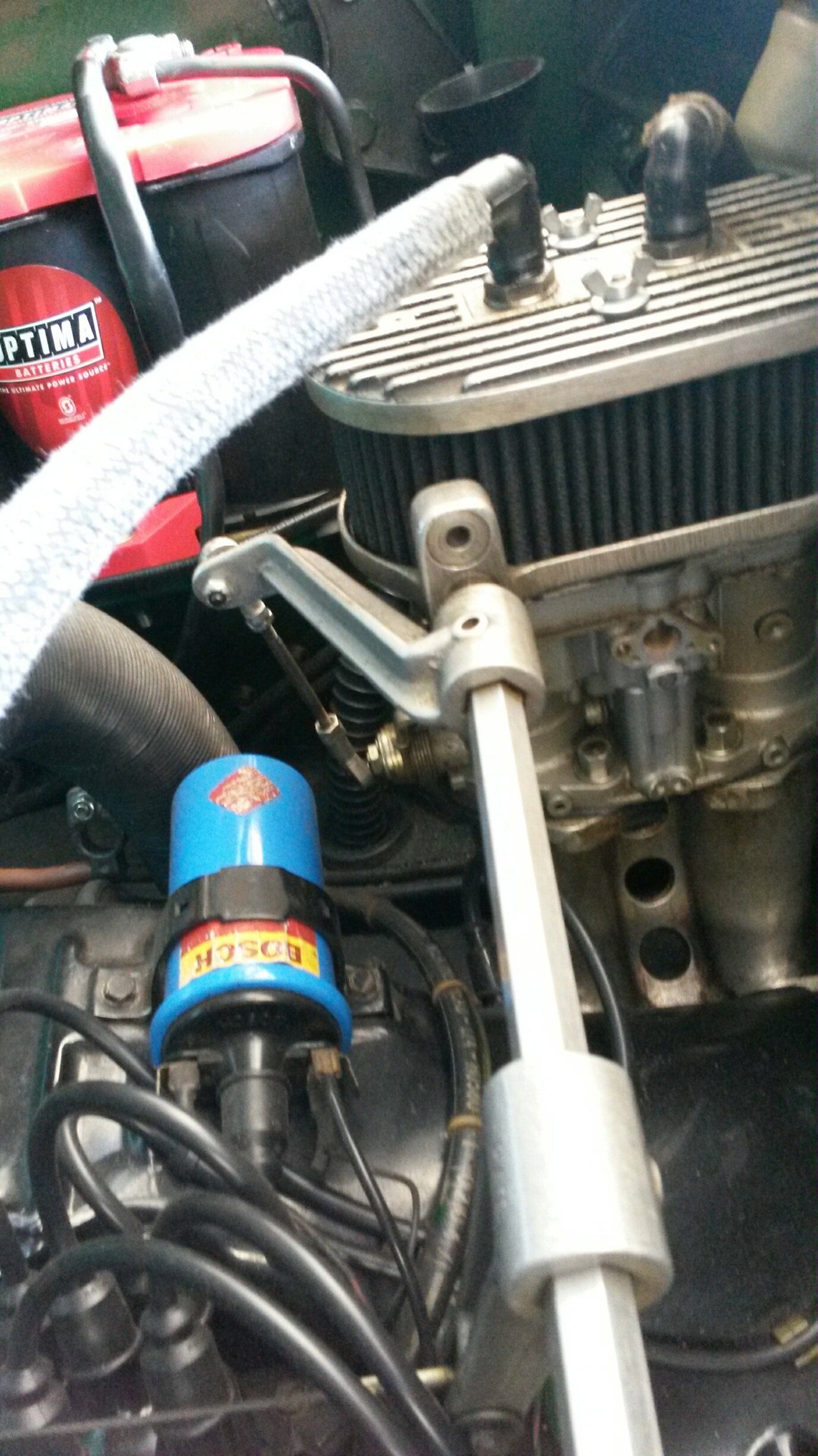

Here's my set-up. i had to flip the linkage around also, works well.

I thought of putting the pull arm on top. but I just don't care for the look. Maybe it's all the time I spend around non-mittlemotor cars. It just looks kind of weird and clunky to me...but it works!
After looking at some of the setups in the photos, especially the one with the UNI filters, it makes me wonder how well that setup works. I was always taught that the sweep of the arm should sweep at equal lengths through it's axis, like how you set up rockers. Middle of the sweep parallel to the tip of the valve, then even sweep on either side. Wouldn't that apply to all points of the carb linkage as well?

QUOTE(barefoot @ Sep 28 2024, 07:13 AM) *
Now we're getting somewhere! You must have flipped the arms on the carbs so they pull up instead of down?
Why didn't I think of that?
I'll try what I think you did and report back.

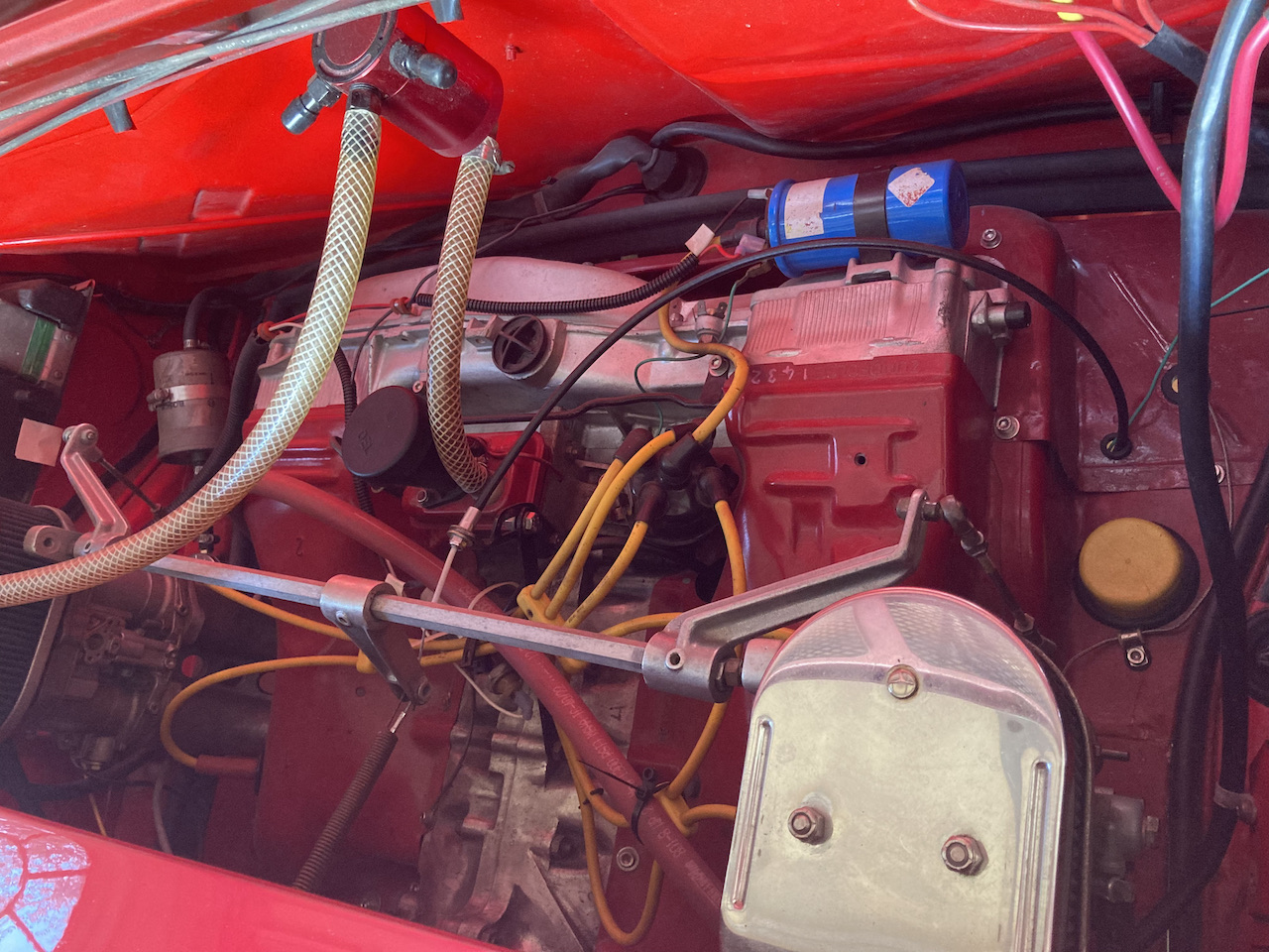

I have two different setups, different linkages. Both required a custom bracket for the cable. I'll see if I can get some pics to work later.

The only crossbar system I like has a round crossbar. I’m a fan of the CSP center pull bellcrank linkage. All the other linkage makes it harder to adjust the drop links. I have a carb tuning article I can email or post, if you want it.

The two setups I have, one is round cross bar, the other is center pull, pics later hopefully.

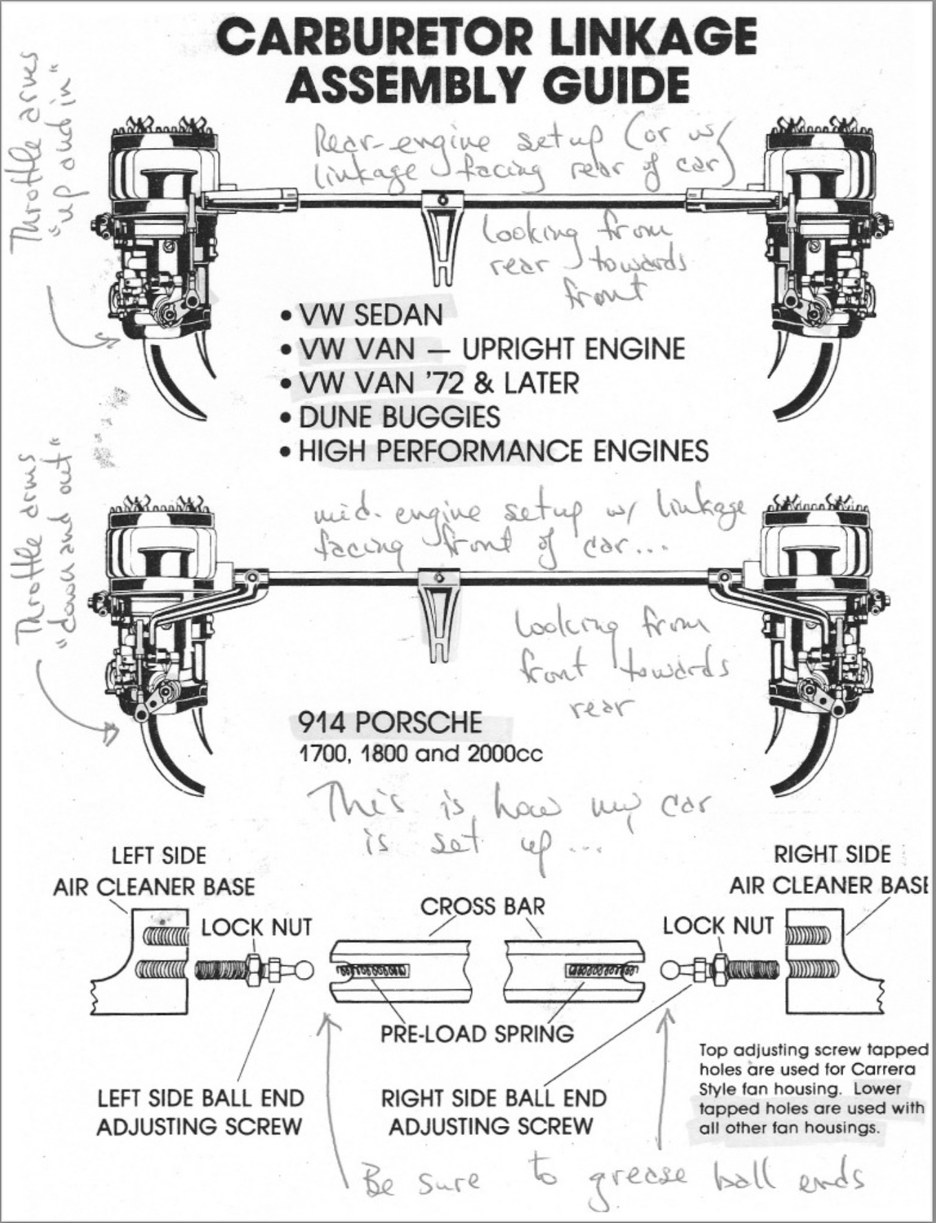

Running Dells on my car, but the linkage set up is similar--towards the front of the car/engine:
Here's a copy of the set-up sheet I got from Claude's Buggies when I bought the carbs back in 1983 ( (IMG:style_emoticons/default/WTF.gif) ):
Note the orientation of the linkage arms--"down and out"
