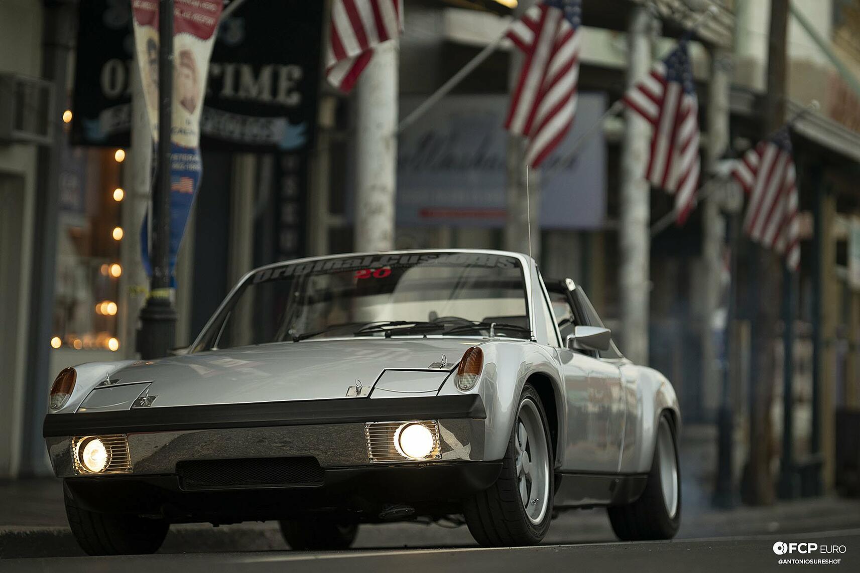

I’d guess I do about the same. 3.2 with stock DME injection. I use a tank or two each driving season and drive every weekend…

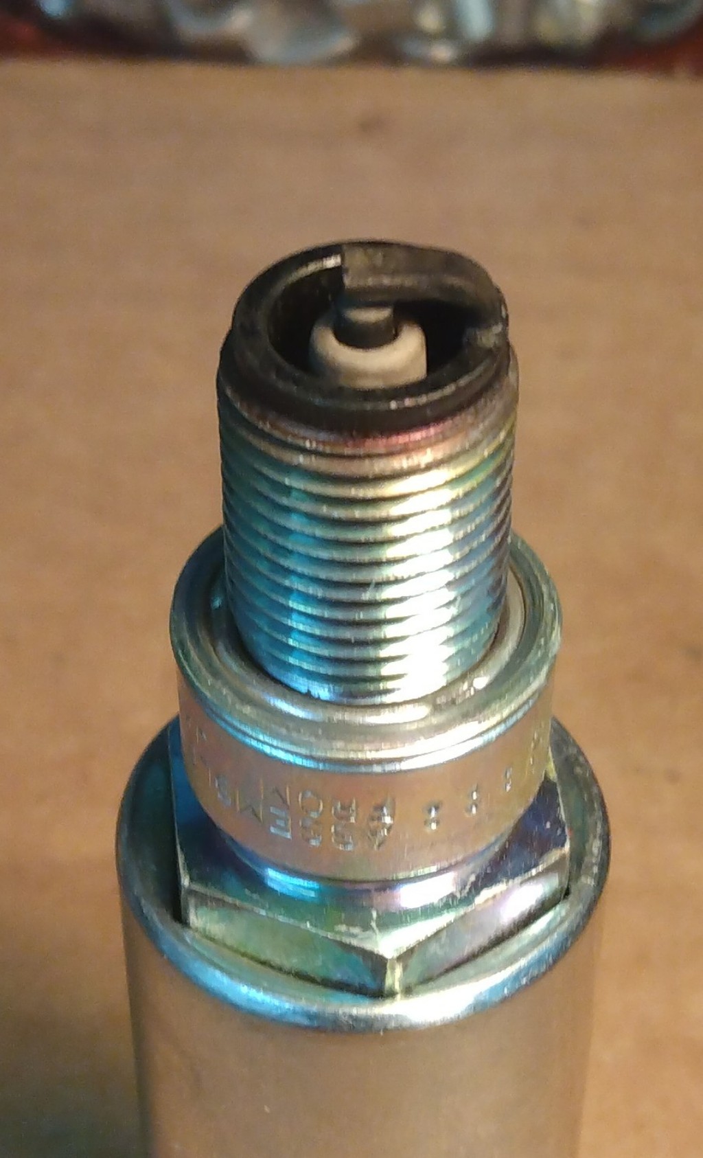

13.2-13.4 AFR. Attached Image

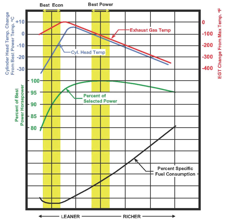

Made me do a bit of research. Found this which explains it a little deeper (and I like his videos)
https://www.youtube.com/watch?v=vcgmEKhCFTs
So, running lean does not specifically increase temps.
@Geezer914 If I was running carbs and non-computer-controlled timing the numbers you're hitting are EXACTLY what I'd be hunting (average).
Your plugs show this nicely.
Now, computer-controlled fuel and spark with proper data gathering I would be hunting in the 16+ range at cruise.
The "data" I'd want the system to make changes on is as follows.
Crank/cam degrees/position.
MAP/MAF.
Baro.
Throttle position, rate of advance.
AFR wideband
Cylinder head temps (all during provisioning, highest one in daily use)
Knock sensors. I'd want one for each bank.
EGT. useful during provisioning. CHT sensor may be enough for daily use.
Now, I believe running lean gives less room for error.
You have to be on top of everything to achieve reliability and longevity.
Once you update to modern equipment lots of improvements are possible.
To those folks who are getting crappy mileage my questions would be.
Are you running a wideband?
Are you logging the results?
And if so, what's your average cruise AFR?
I'd bet most of them are too rich.

Here is some really well presented data you might find helpful.
https://www.kitplanes.com/adding-direct-air...tio-monitoring/
Id suspect you are correct in that most if not all are running rich. Almost every car I have retuned for people has been rich, many VERY rich.
Rich is just the easy answer, far easier to get things to run without to many noticeable issues just by dumping a bunch of fuel in. Without vacuum advance you can usually be anywhere pretty much from 14.7 to 9.5:1 on the rich side of stoich and have an engine that runs without bucking or popping. On the lean side of 14.7 you can get to maybe 15.5 but you are already loosing power pretty quickly, so yeah, quick tuning by ear or feel its almost always going rich.
When you get near 16:1 you need to add advance to get a complete burn in time, but throw in the necessary advance and it cruises along just fine at 16 and leaner.
I don't generally talk about lean tuning because so many people don't have a good understanding of what they are doing and are more likely to create problems and/or damage something if they attempt it without a solid understanding of EFI, because as I said, rich is easy. Easier to explain to someone they can just setup their entire tune in the 12.1-13.5 range and everything just works VS explaining where in their map they can go lean, how lean they need to be, and how to setup the transitions from lean to rich in their fuel and timing maps to have a smooth experience and no hot spots etc.

That second link (kit planes) is EXCELLENT!!!
It gets pretty deep quickly but was damn interesting to read.
I've always wondered about widebands and 100LL!
One of the vehicles I service is the fuel truck for the Pecan Plantation airfield.
I can have 100LL delivered!
NTK sensors are the way to go.
The Japanese kick ass again!
@JamesM thank you for the link.
With what you know don't you absolutely hate it when you cannot adjust fuel/timing at will, with the stroke of a few keys?
Having to resort to mechanical advance with vacuum operated advance/retard just seems "Retarded" in my book.
It's a wonder it worked as well as it did! (IMG:style_emoticons/default/beerchug.gif)

QUOTE(worn @ Oct 5 2024, 09:59 PM) *
QUOTE(ConeDodger @ Oct 3 2024, 07:42 AM) *
Oh, but that looks like fun to drive.
Yup! And the reliability of the mostly stock 3.2 Carrera motor gives me the confidence to take it anywhere.
