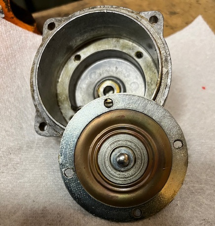

I did open the body of the MPS and yes the diaphragm on the top is brass and looks like the one on the tangerine racing website. Maybe they all are brass, I don't know. Its definitely been rebuilt. When I put my ear up to it with vacuum, it sounded like it was leaking through the top vents. I taped them off and check and it is. With the tape, the vacuum just barely leaks at all.

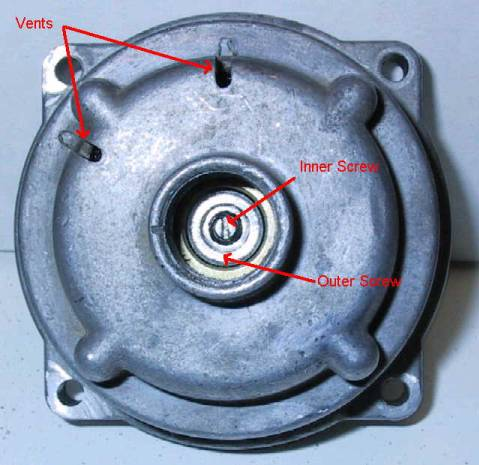

You won't damage the engine. Adjusting the inner screw clockwise will lean out the mixture, counter-clockwise will richen the mixture. It's farily sensitive, which is why I only suggested 1/4-1/2 a turn, but you won't break anything if you go further. Note that you need the Tangerine Racing adjusting tool so that you don't also turn the outer screw that the inner screw sits in (not the outer screw you're talking about which is more commonly referred to as the full-load stop screw).

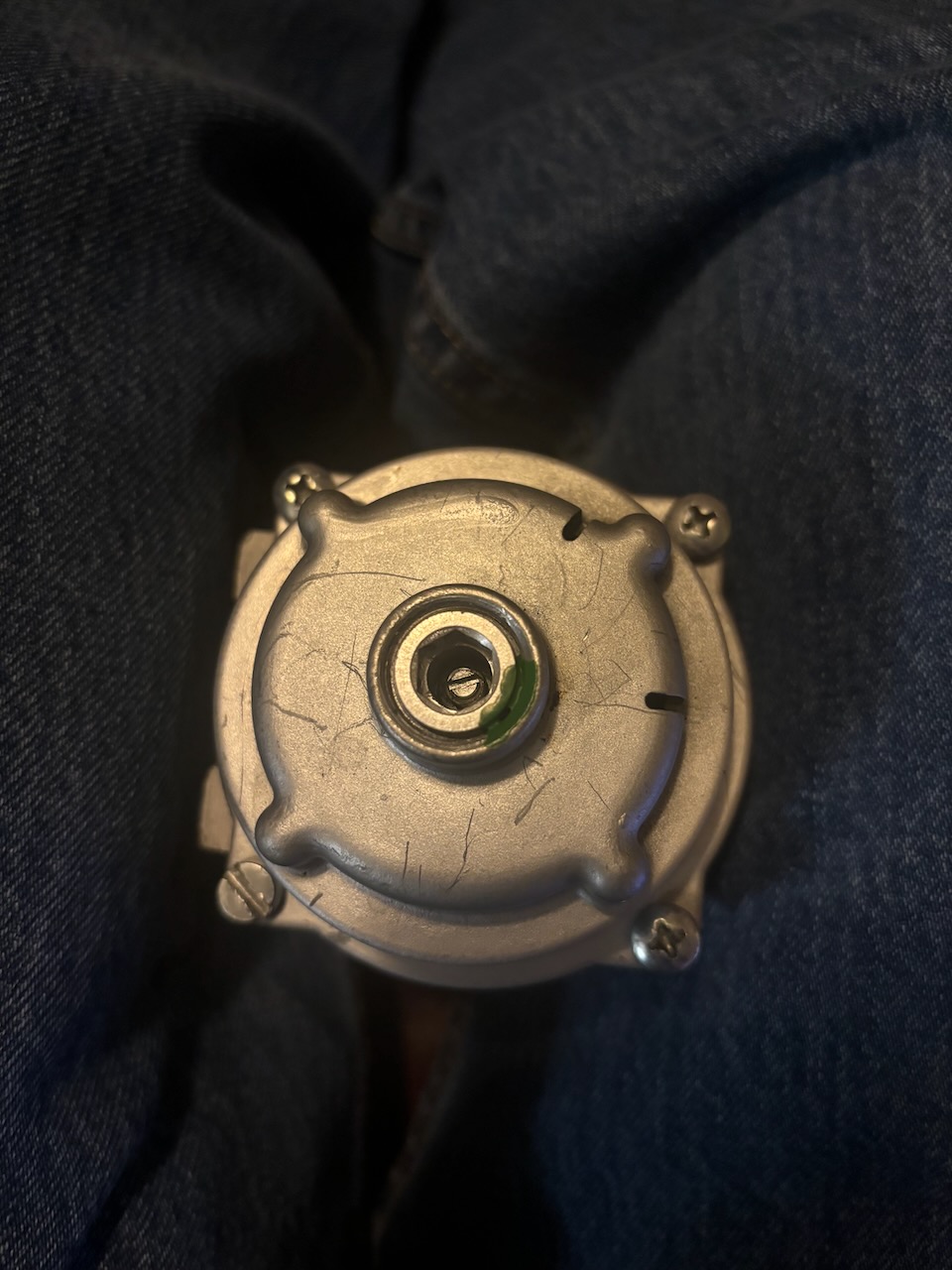

I'm not sure I follow on what is the full-load stop screw. Is that just the outer allen wrench nut? Here's a pic of the top of mine.
Yes, the outer most screw is the full load stop screw.

I haven't pulled out the diaphragm on mine. I tried it get my finger nail under the metal space but I didn't want to damage it and wasn't able to pull it out to see what is underneath. It didn't appear to have a paper gasket but it could be so thin I didn't see it.
Can I just push on the inner screw to pop the diaphragm out? I suspect it would damage any gasket that was underneath it. Hopefully not. I would like to see if a little grease is all it needs to seal.
