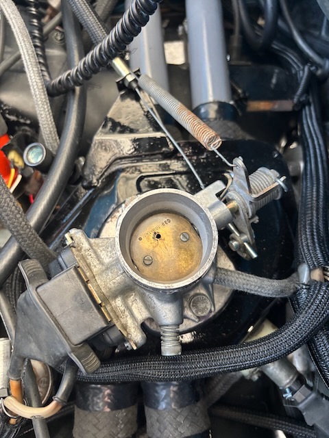

QUOTE(slapshot @ Oct 25 2024, 07:42 AM) *
With the smoke test, I get smoke coming out each side of the throttle shaft. Is there a bushing kit for this? Is it rebuildable or can I pack with grease?
Each side? Assuming you've sealed the top of the TB when testing, there are only 3 possible areas from the TB itself where leaks could occur (unless there is a crack somewhere):
Idle screw
Vacuum port 1 (for advance- facing rear of car)
vacuum port 2 (for retard facing front of car- not all cars had this port)
When doing the smoke test, plug both vacuum ports.
Are you sure the leak isn't coming where the throttle body sits on the plenum? You may just need to tighten the bolts holding it down, or more likely you need a new throttle body gasket.

QUOTE(rjames @ Oct 25 2024, 12:37 PM) *
Idle screw
From what I could tell it is coming from both sides of the shaft holes. nothing from the new vacuum hose on the body. The gasket on under the TB is new. I'll check the bolts again.

That throttle shaft leak will add some rpms, is your vacuum retard port plugged? I see the hose running off somewhere. If your distributor is set for retard and you have it disconnected, that might be what you need to bring the idle down. I have found the retard does not work on my 123dizzy but it is not the Bluetooth version. I think you would be best served by just plugging that port at the throttle body and not using retard at all. At worst your dizzy is set for advance and it is getting the advance signal when the throttle is closed and no other time.
1150 is very close. Yes the hole is supposed to be there. Also, try plugging the hole inside the throttle body with your finger. Sometimes that idle screw does not seal perfectly. And by hole I mean the one in the casting not the butterfly.

There are throttle body shaft seals you can order.
slapshot
post Oct 26 2024, 10:06 AM
Post #93
Posts: 146
Joined: 11-June 23
From: Utah
Member No.: 27,409
QUOTE(Geezer914 @ Oct 26 2024, 06:59 AM) *
Good deal. I'll be looking for some. If you know a part # for a 2.0 let me know. Thanks

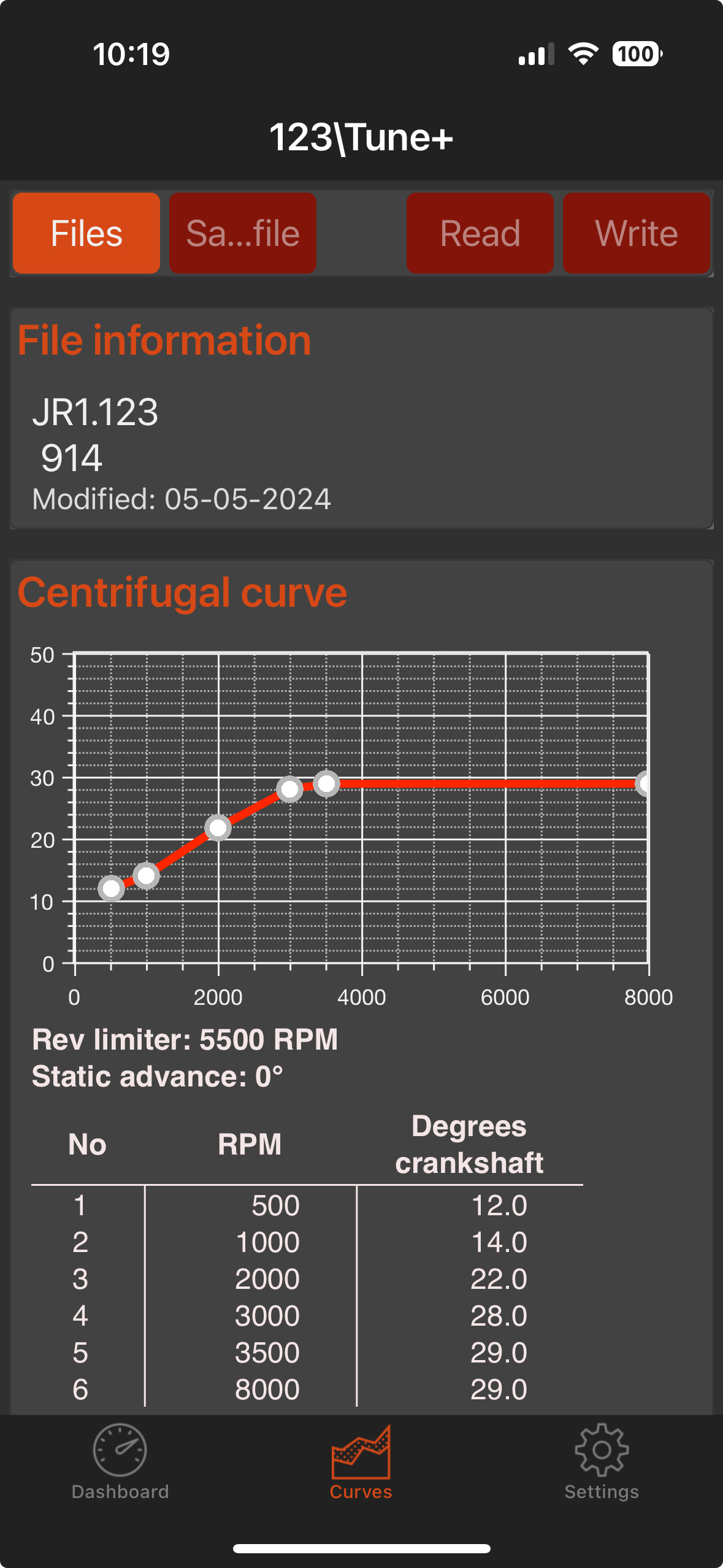

QUOTE(emerygt350 @ Oct 26 2024, 05:46 AM) *
I use a boroscope to ensure tdc, but what you did works too. Idle is set at 3400 if I remember correctly (double check that). My car really likes 28.5 but each car is different. Since we have 123s I am not certain that old way of setting idle is really necessary. I find 8ish at idle equals where I want to be all in. However, if your idle is high you are stuck doing the high rpm timing anyway.
Here's how I set the timing. Set TDC #1, turn the dizzy CCW til the light turns off, then turn it CW til it turns on making sure there is not slack in the rotor. I then set the dizzy on the app @ 20 degrees for all RMPs and set my timing gun to 20 degrees, start the car and turn the dizzy CCW til the timing light is in the "V". Turn timing up to 28 in the app and checked it again at 3000 RPMs. If this is wrong LMK cause it does sounds like the timing is off or maybe MPS calibration is wrong. How about the ECU knob? I've got it 5 click CCW from total CW. I'm still trying different clicks.
I am not familiar with setting the curve in Bluetooth dizzys but I do know there are some suggested curves to start with for d-jet.
See attachment for my curve. This is what worked best for my Webers.
If you are getting a miss and your timing is good I would suspect mps tuning at that point. You probably have lean spots at particular vacuum rpm combinations. Do you have afr gauge set up? I found having a vacuum gauge and an afr in the cab allowed me to tune the mps relatively easily in the car.
I found and fixed another vacuum leak going to the decel valve. I will probably get a rebuilt MPS from a repealable supplier. I don't have an AFR.

That knob in the ECU is only supposed to affect idle richness. However, the ECU determines idle by the TPS, so if your TPS isn't behaving...
JamesM
post Oct 26 2024, 03:09 PM
Post #96
Posts: 2,187
Joined: 6-April 06
From: Kearns, UT
Member No.: 5,834
That's a lot of advance at idle. Likely kicking up you idle speed.
set a flat line at 8 degrees between 500-1200 and see what happens
emerygt350
post Oct 26 2024, 04:50 PM
Post #97
Posts: 3,506
Joined: 20-July 21
From: Upstate, NY
Member No.: 25,740
QUOTE(JamesM @ Oct 26 2024, 03:09 PM) *
Ahh, yes, I didn't see that. That makes me wonder if they weren't anticipating vacuum retard? That kind of advance down there would add a couple hundred to the old idle for sure. I would start adding timing around 1200 like mentioned above.

QUOTE(emerygt350 @ Oct 26 2024, 04:50 PM) *
I set it to 8 degrees up to 1200 RPMs. It did lower it to about 1000-1050RPMs after warmup.
The engine seems to miss here and there from my ear. Its not a smooth as I think it should run. I took all the plugs out and did a compression test. I didn't have time to do a leak down test on all cylinders. The compression was about 100 on all cylinders. That's what it has always been since I bought it in 11-2022. The engine has about 3000 miles since it was rebuilt by its previous owner.
Plugs 1, 2 and 4 showed lean running with 3 showing normal. I sprayed starting fluid around #3 intake. It didn't change RPMs.
