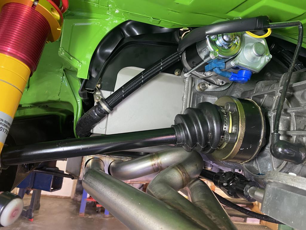

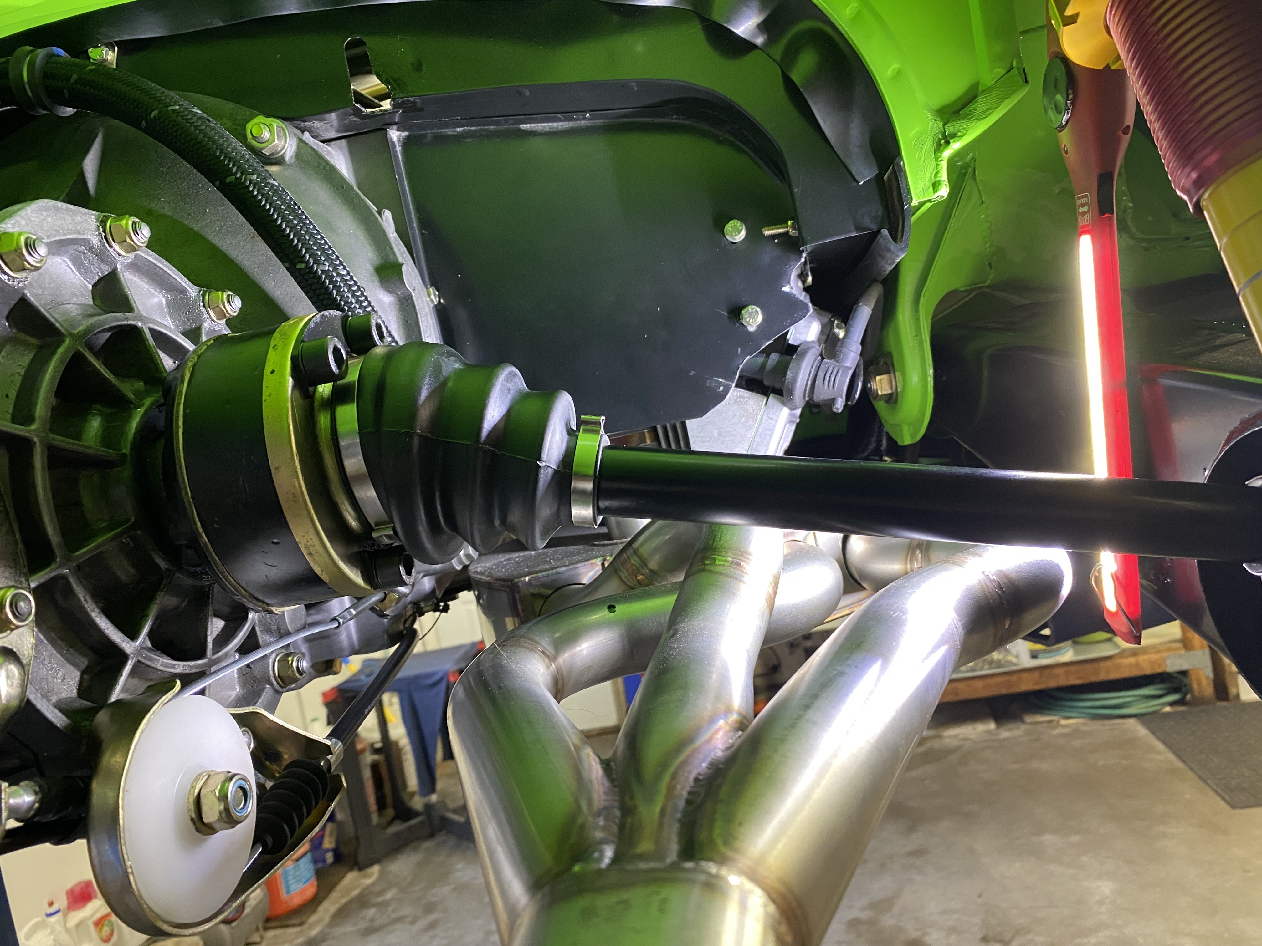

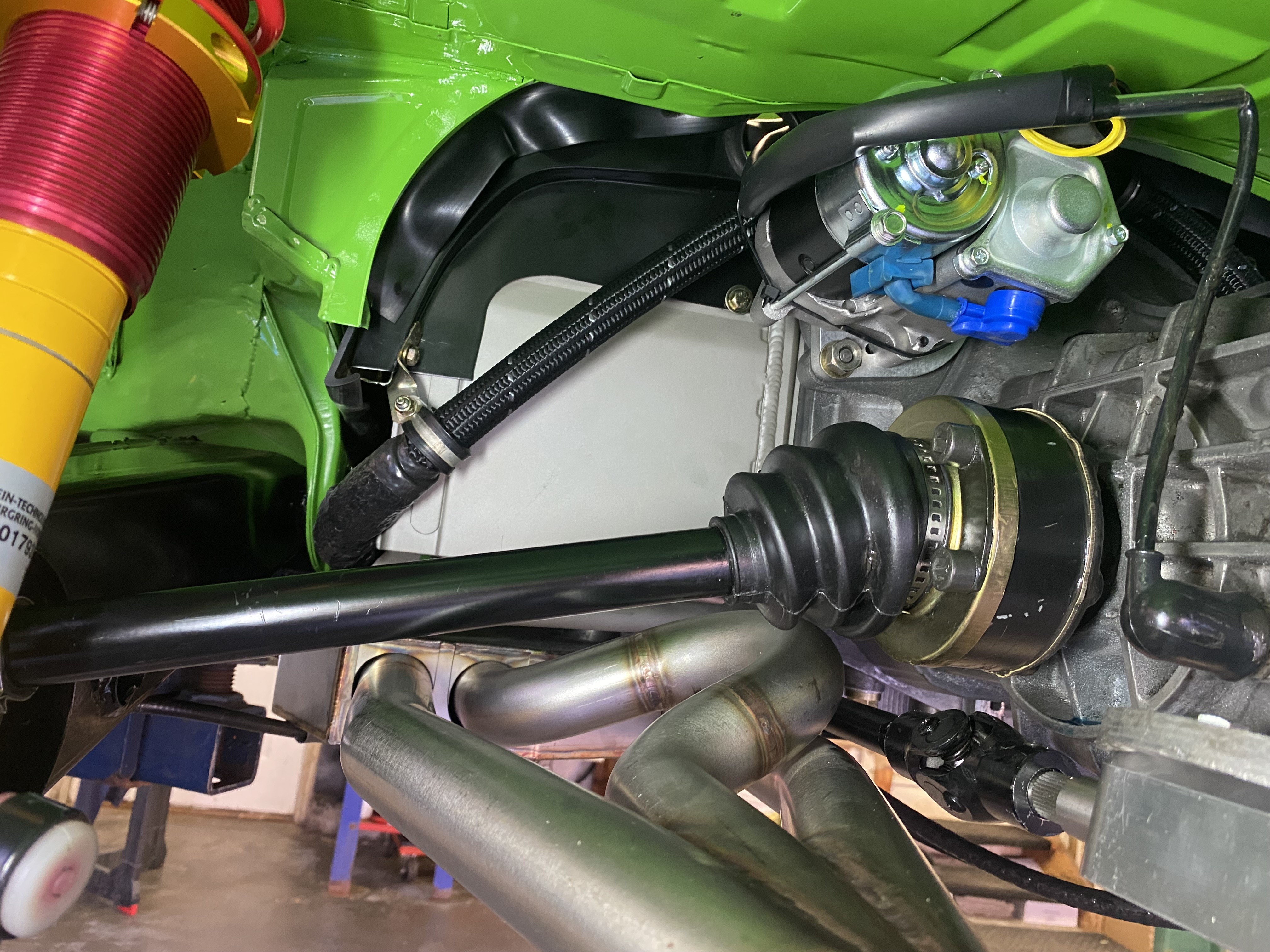

Did the passenger side today. I removed the shock absorber and the throttle bell crank & linkage. This gave me sufficient access. The screwdriver trick to guide the stub axle into place in the hub was golden!
Hopefully the driver side will be as easy.
Tom1394racing
post Oct 31 2024, 02:17 PM
Posts: 523
Joined: 25-August 07
From: CT
Member No.: 8,039
I did the driver's side today. I only needed to remove the shock, just like the passenger side. A little bit more fiddling on this side. Being able to slide the inboard CV joint towards the middle of the axle on the free-floating axle made a big difference in the clearance.
Thanks again for all the suggestions
