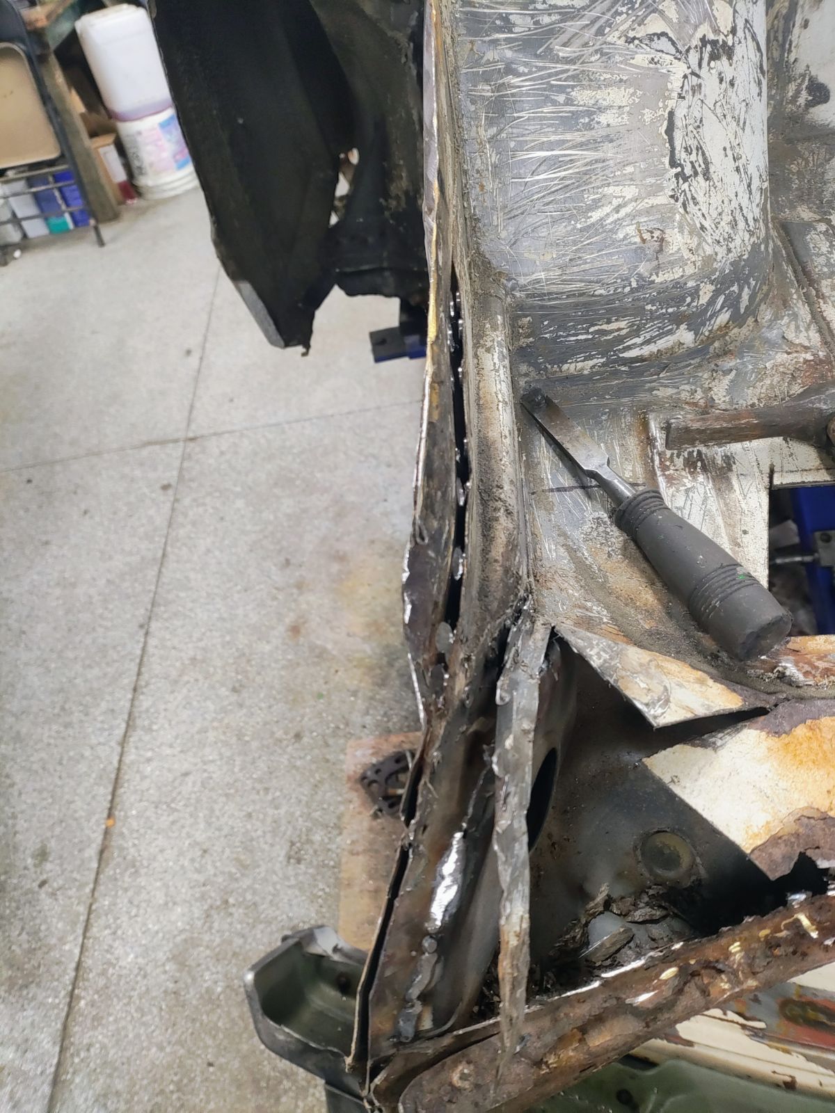

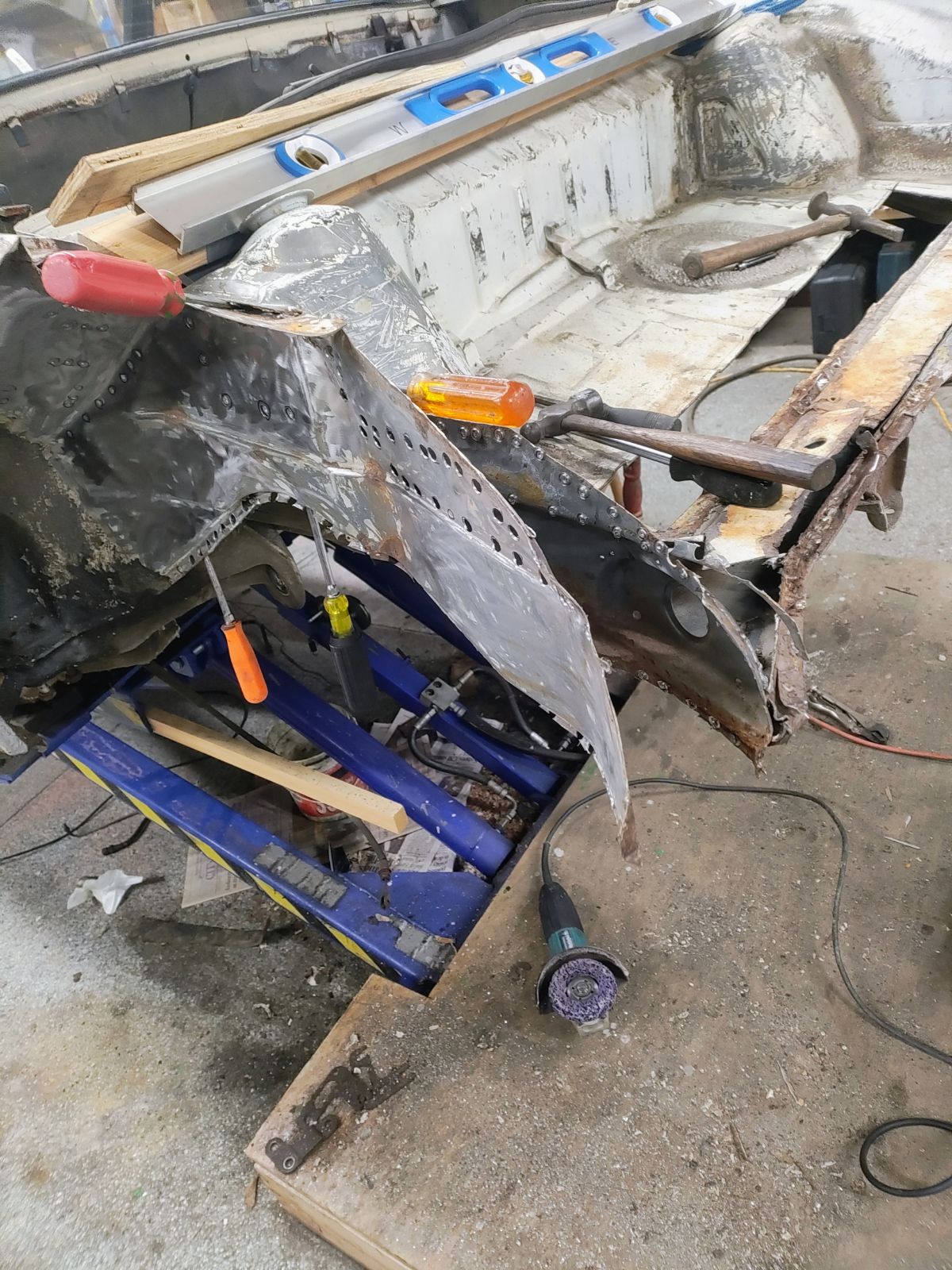

Starting to remove the kinked inner fenderwell
Planning to remove " some" of the damaged/kinked panels and get a push here and a pull there to get things in line
First time at this game, what could possibly go wrong?

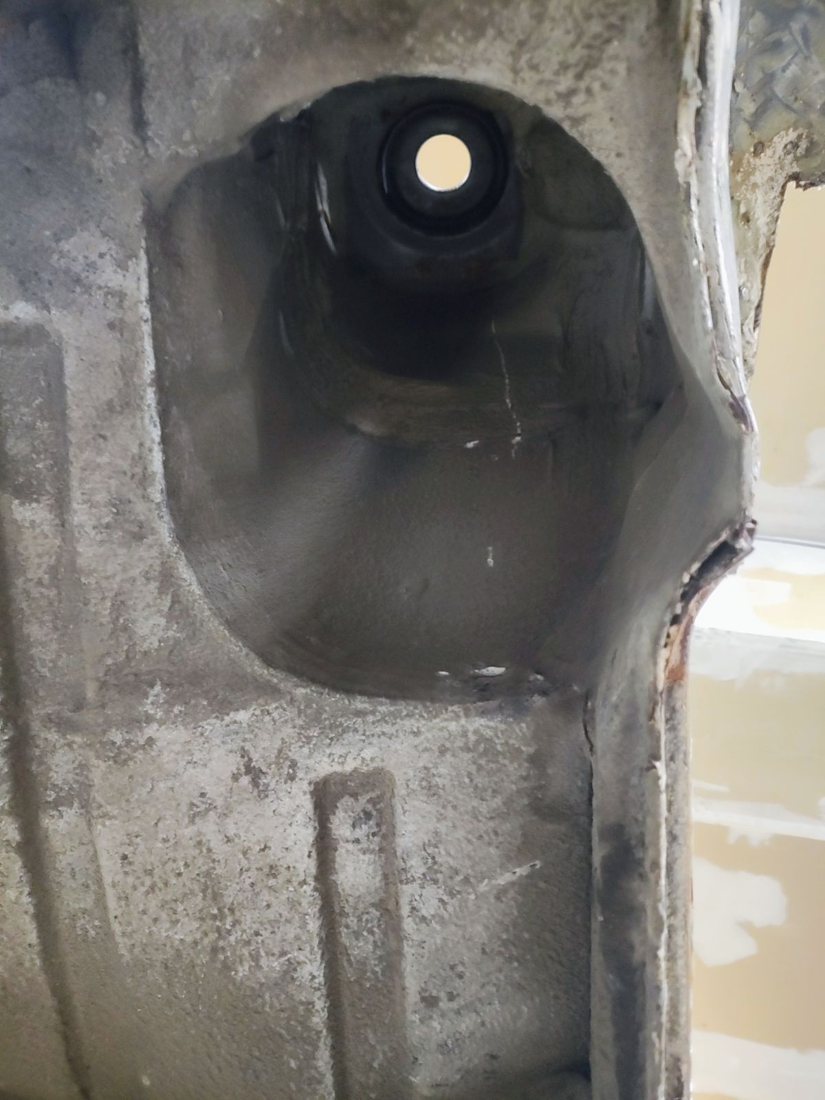

Before
Kink from the underside

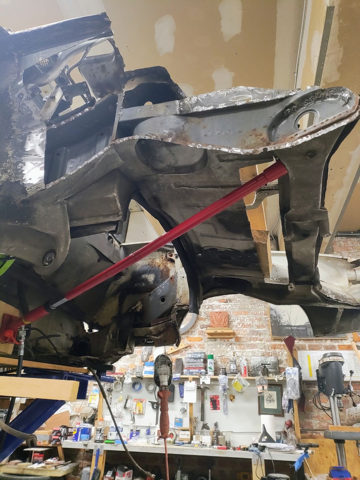

Hoping this won't need too much push. Planning to add some heat, a little tap here and there. Combination of all three

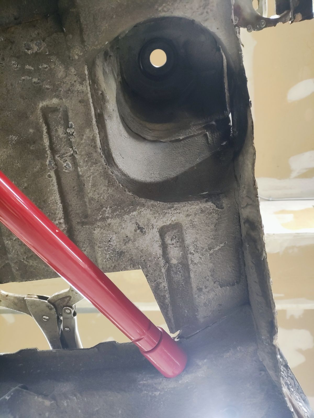

QUOTE(r_towle @ Dec 15 2024, 11:06 PM) *
Damn!
You have skills!
thank you, all of us get lucky from time to time
after
before is in post #52
