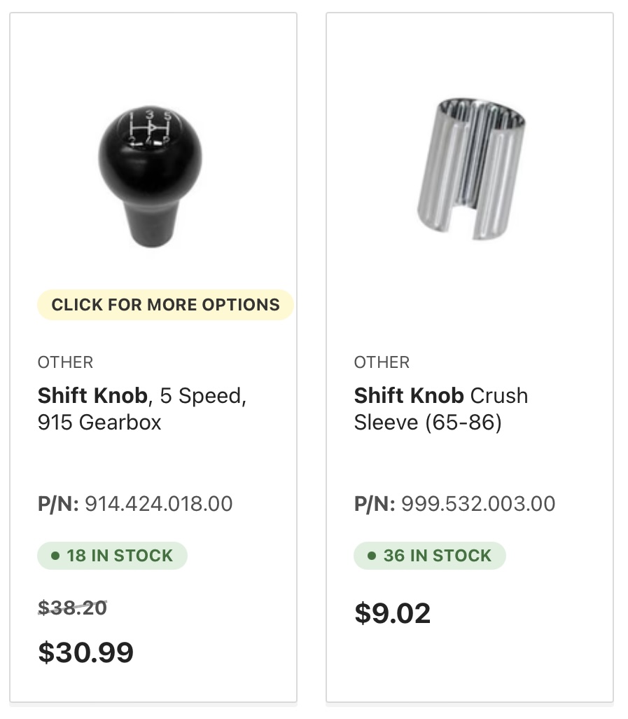

Member ![]() ![]() Group: Members Posts: 109 Joined: 20-August 14 From: California Member No.: 17,801 Region Association: None ![]() ![]() |
Is it a factory shift knob like the picture below? If so it uses a crush sleeve.
![]() You can find it here: https://sierramadrecollection.com/search?qu...=914-shift-knob |

Thanks to all who've commented. As I said in the original post, there is a crush sleeve up in the knob. Again, if a new one is the fix, please tell me how do I get the old one out? I would have thought that the shop would have used a new crush sleeve, but maybe not. The shop I went to is a well-known indy Porsche shop in my area. They probably had thirty+ vintage Porsches on the premises, though mine was the only 914. Mostly 911s and 912s, with one authentic 356 in the mix. Aren't these knobs the same as on any 911 with the 901 gearbox? If so, I don't know that the shop would require any specialized knowledge regarding the shift knob. There was an old red leather Momo knob on the shifter that they used, which they removed and replaced with the OE style knob.

The crush sleeve should only be held in the knob by friction. Use a pick, long nose pliers or try slamming the knob on a wooden surface to get it out. Be creative!

New crush sleeve and make sure that the knob gets seated all the way down. I have seen some where in addition to the new crush sleeve they small slip of the old crush sleeve into the knob too. I put a new factory knob on my stock shifter lever with a new crush sleeve and it fits very tight. Good luck.

If you want to be correct, get a new crush washer. And if you can't get the old one out of the old knob (and if the old knob is worn), just get another one of those. |

You just need a new crush ring.
Also be sure they did not crack the base of the shift knob. Then it won't matter if you have a new ring in it, as it will just spread the crack. You can also use paper or felt, but over time the felt will compress and eventually work loose. I've done both. For paper, I just used printer paper, folded 3 times, and put over the top of the shaft. Used a rubber mallet to drive the knob down over it. There was a time when the rings were NLA, and you had to get creative. Zach |

Put the crush washer on the very end of the shifter rod. Gently slide the knob on till it stops. Be sure it's oriented the right way. Give it a good smack with the heel of your hand till it seats all the way. Done!
